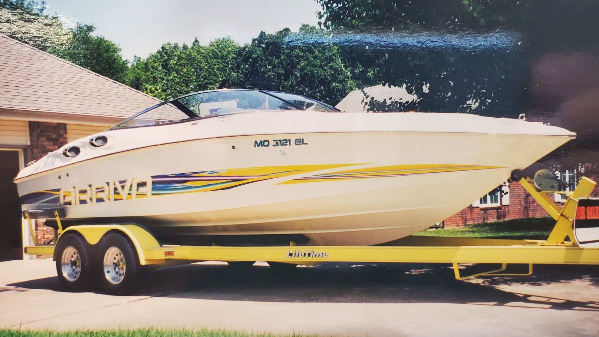

I had the same boat back in the day, mine had a 502 mag mpi and Im pretty sure I was running a 25p M+ also, having someone work over a prop is always a crap shoot you dont really know how the boat is going to react. Pretty sure the rev limiter is at 5350 on the 525 so Id stay below that

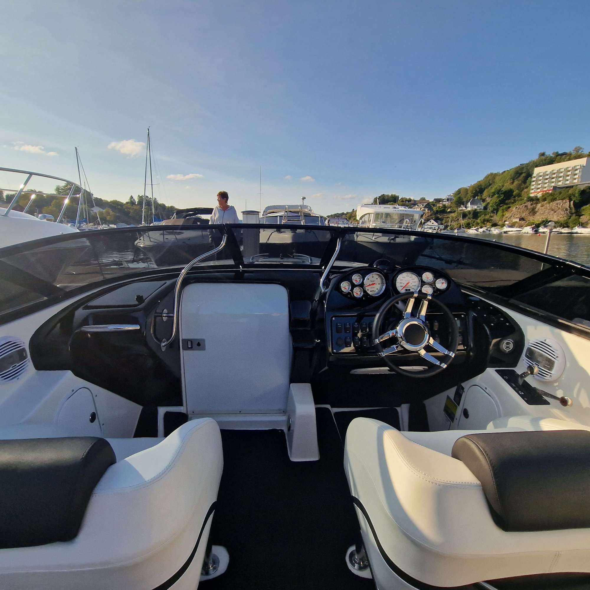

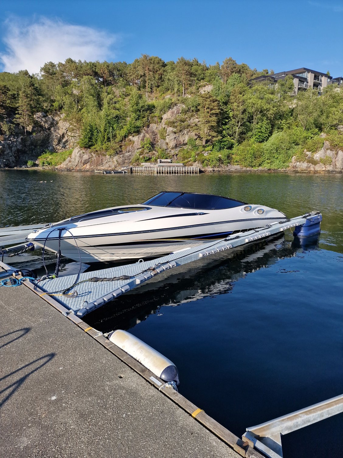

I really think these boats have a timeless look
I have done quit a lot of work with mine and i absolutely love it!!

very nice
