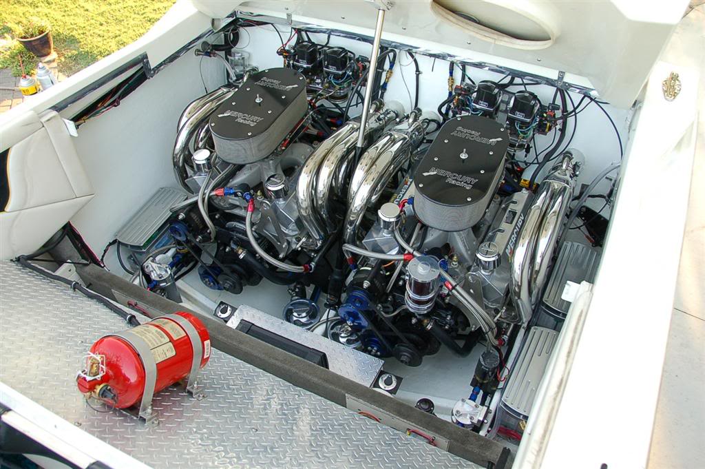

I was in the process of buying some but after futher investigation these 509 CID short deck engines were a little light to handle the bigger dual Whipple so we went with the 3.3 single. We are trying to stay in the reliable 800-850HP Zone. If we upgrade later we will use the tall decks more CID like 565 & 4L Whip. Everything on this boat is over built to be extremely reliable from the Supercat racing engines 800-850HP,
Bam 1500 trannies and the #6 drives.
It's taking a long time to gather and build with this hardware but once it's done we can hammer and hammer till our arms hurt and hopfully look back and see nothing but a huge rooster for years to come. We took the Supercat engines from my Velocity pic 1 to Whippled Supercats pic 2 after a cam piston swap. Rods and crank are still Supercat.
