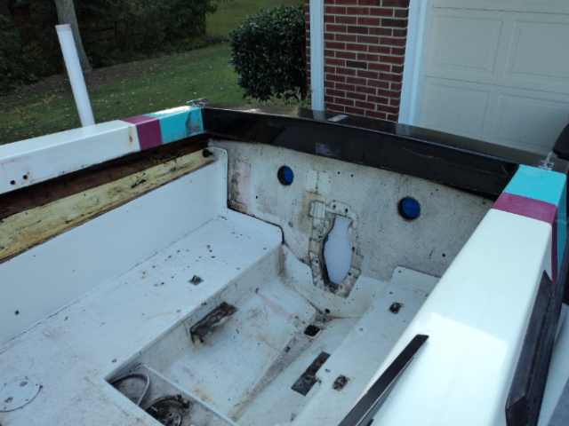

Old 10-24-2013 | 08:51 PM
Joined: Sep 2010
Posts: 1,087
From: LSC, MI
I got the engine out today. I expected some soft core around the transducer leak and I knew from the last time the engine was out that the blocks for the bilge pump were wet. I did at least 30 test drills in the transom and stringers and they are dry!!! So I only need to cut open and replace about a 8x12 inch section in the bottom of the bilge! Very Happy!!! I did also find that the ply behind the gas tank is wet, but that was just tabbed in. So I will be cutting that out also and putting in a new properly sealed piece there.

Old 10-29-2013 | 05:17 PM
Joined: Sep 2010
Posts: 1,087
From: LSC, MI
Almost completely torn down now! Just got to remove the switch/radio panel, rest of the harness and the cabin interior! I think I will be cutting glass tomorrow after work! Need to get the glass work done before it gets cold!
