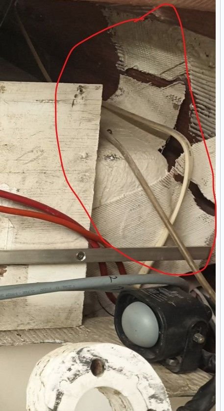

not sure where this is but it looks like the tabbing has let go....?
https://cimg9.ibsrv.net/gimg/www.off...bc5f50ef8f.jpg
ksalmine 10-28-2024 11:25 PM
Skagerak across race in many years have left some memories to boat. It is just toilet module tabbing, not a big deal. I have plan to take all cabin out some day and rebuild it way diferent looking. Then toilet module is taken off anyway. Fountain use same module in 47 and smaller boats, I wan’t more headroom, there are 15-20cm free space above toilet.
