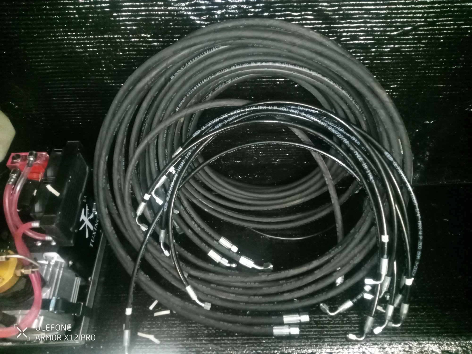

https://cimg7.ibsrv.net/gimg/www.off...ef8e30c21e.jpg
It suprice me how much hydraulic hose is in basic powerboat! Huge amount of fittings and hose. Here in picture is only inside boat hoses. Outside hoses will be stainless fittings, kevlar braided.

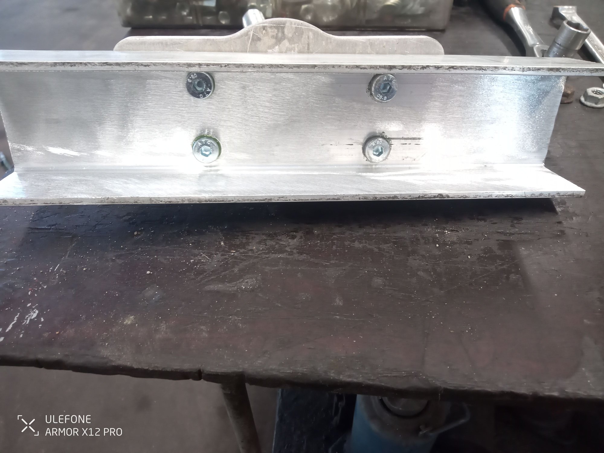

https://cimg5.ibsrv.net/gimg/www.off...0367bb628f.jpg
Next extension boxes, if I ever have to make them again, I will put more space between welded thread inserts. They barely fit.

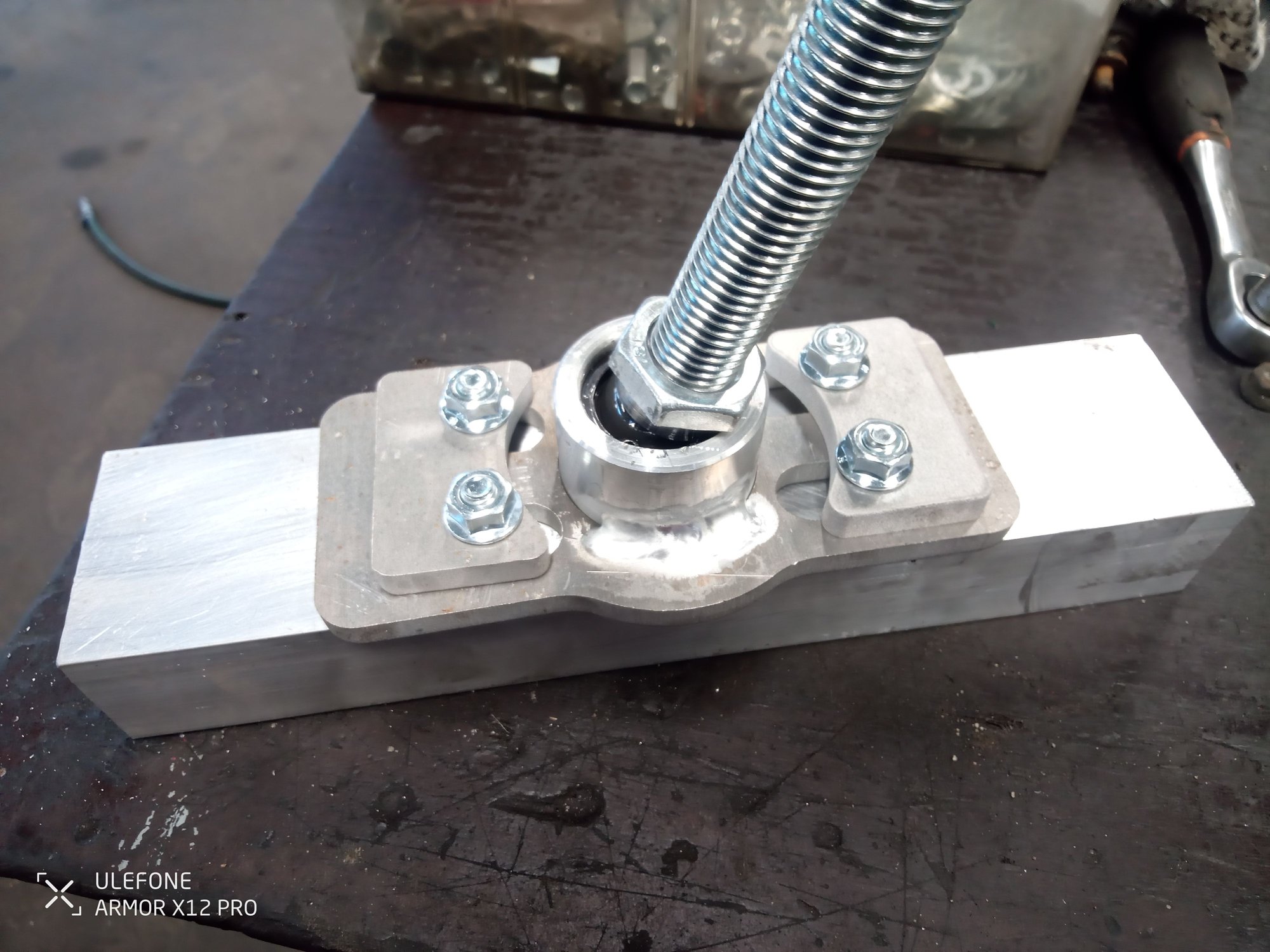

https://cimg4.ibsrv.net/gimg/www.off...3be67e805f.jpg
Own design engine mounts, aluminium with steel ball joint inside which allows engine package tilting and small longitunal adjust, but they are still solid, no rubber. This way I can line up drive shafts after test drive so CV joints get as small angle as possible in that trim setup which boat runs best. Hard to explain but rear CV joints turn when steering or trim is used.

AllDodge 05-12-2025 01:51 PM
No rubber for motor mounts, even if just for vibration damping
Have been around different machines that did not have any rubber in mounts and most develop a sound harmonic kind of noise which can travel thru entire machine, and in this case maybe the hull
