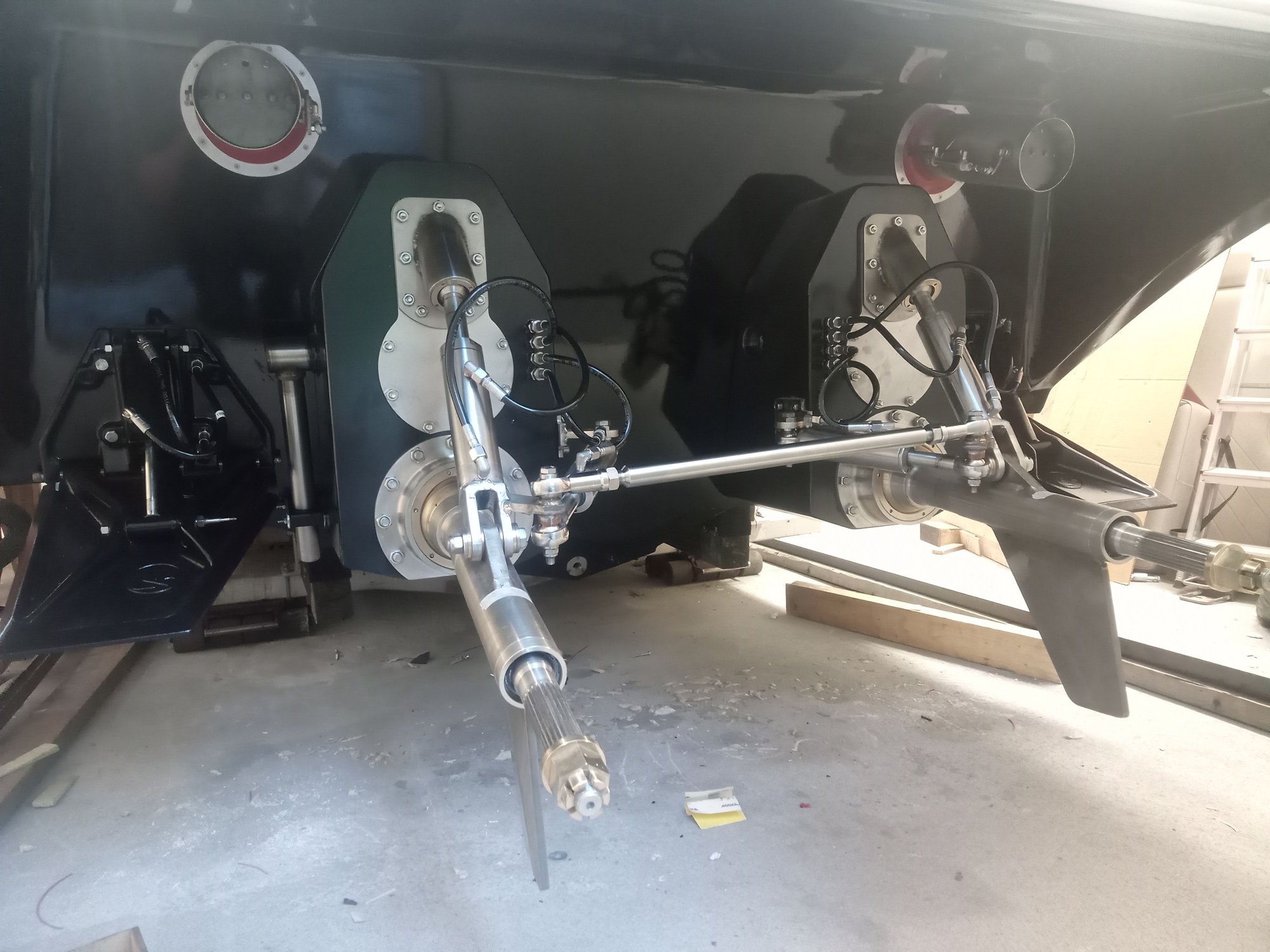

I turn 30mm stainless tie bar with 20mm stainless ends, all bolts secured and all hydraulics done. Zero leaks, last night I fill all and start testing and aeration.
https://cimg5.ibsrv.net/gimg/www.off...85ef66604e.jpg
Drives, steering and trim looks like rock solid, future show how they perform, all parts are do it yourself stuff.

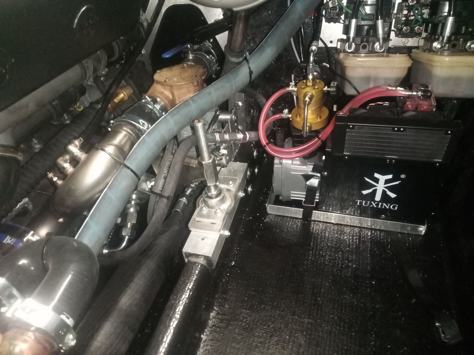

Starter pneumatics wasn't easy case. Gas bottle fill and test company won't sell bottle valves for me. That a$$hole want my bottles to check, will not sell valves for me, I don't understand why he can't sell just valves? Aluminium scuba bottle thread is 17E, 11/16" 14G 12degree taper, M18 bolt transition to 17E happened in my lathe, it was pretty difficult to turn cone thread in manual lathe, but now I have fittings from 17E to R1/4 so I put 30cm hoses between bottles and basic 1/4" hydraulics ball valves. Problem solved.
https://cimg3.ibsrv.net/gimg/www.off...0824b419f5.jpg
Compressor to ball valves pressure test....
https://cimg0.ibsrv.net/gimg/www.off...a1283f8192.jpg
.... didn't went good, compressor conrod big end seized, chinese crap manufacturing error. No problem, I ream and hone it little more clearanse, now it works good.

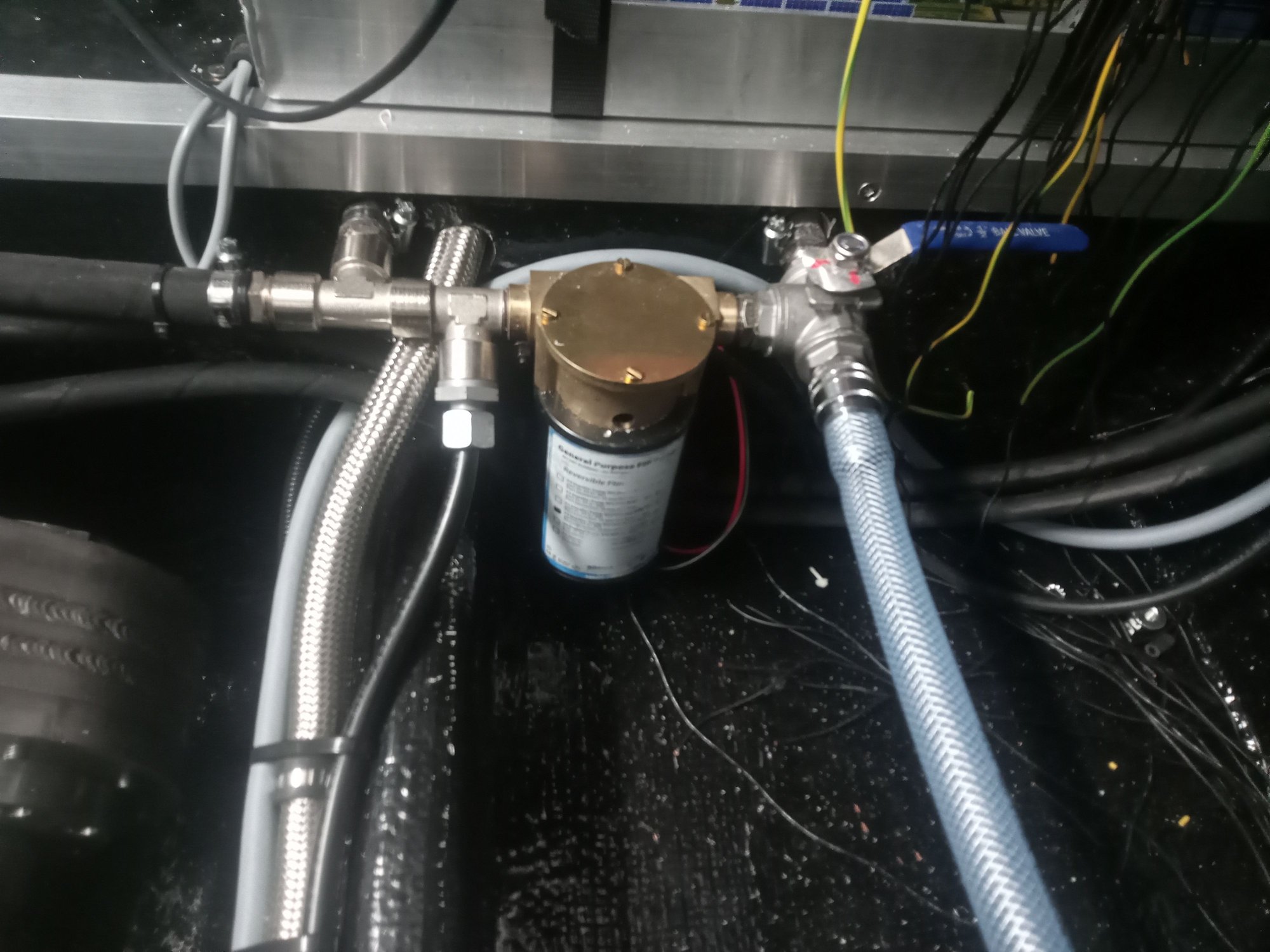

Fuel transfer pumps are awesome! They did their job as planned, you can transfer fuel from side tanks to center whenever you want. Center tank is only tank used now, Transfer pump work on filling pumps too, they can suck from barrels by 10m long hose no problem. Fuel is 0.5€ cheaper on land than on water, big save, 1.48€/litre when I buy it 400l yesterday.
https://cimg2.ibsrv.net/gimg/www.off...0a07af3760.jpg
https://cimg9.ibsrv.net/gimg/www.off...bbeac69d10.jpg
Overflow line for raw water pump motor, 12mm pneumatic hose. I try save weight doing all low pressure piping with lighter parts than 200bar hydraulics.
Hydraulic pump, raw water pump and start air compressor are pretty tight fit but there was no better options when I design this. Luckily all parts are easy to remove to get more space to work.
