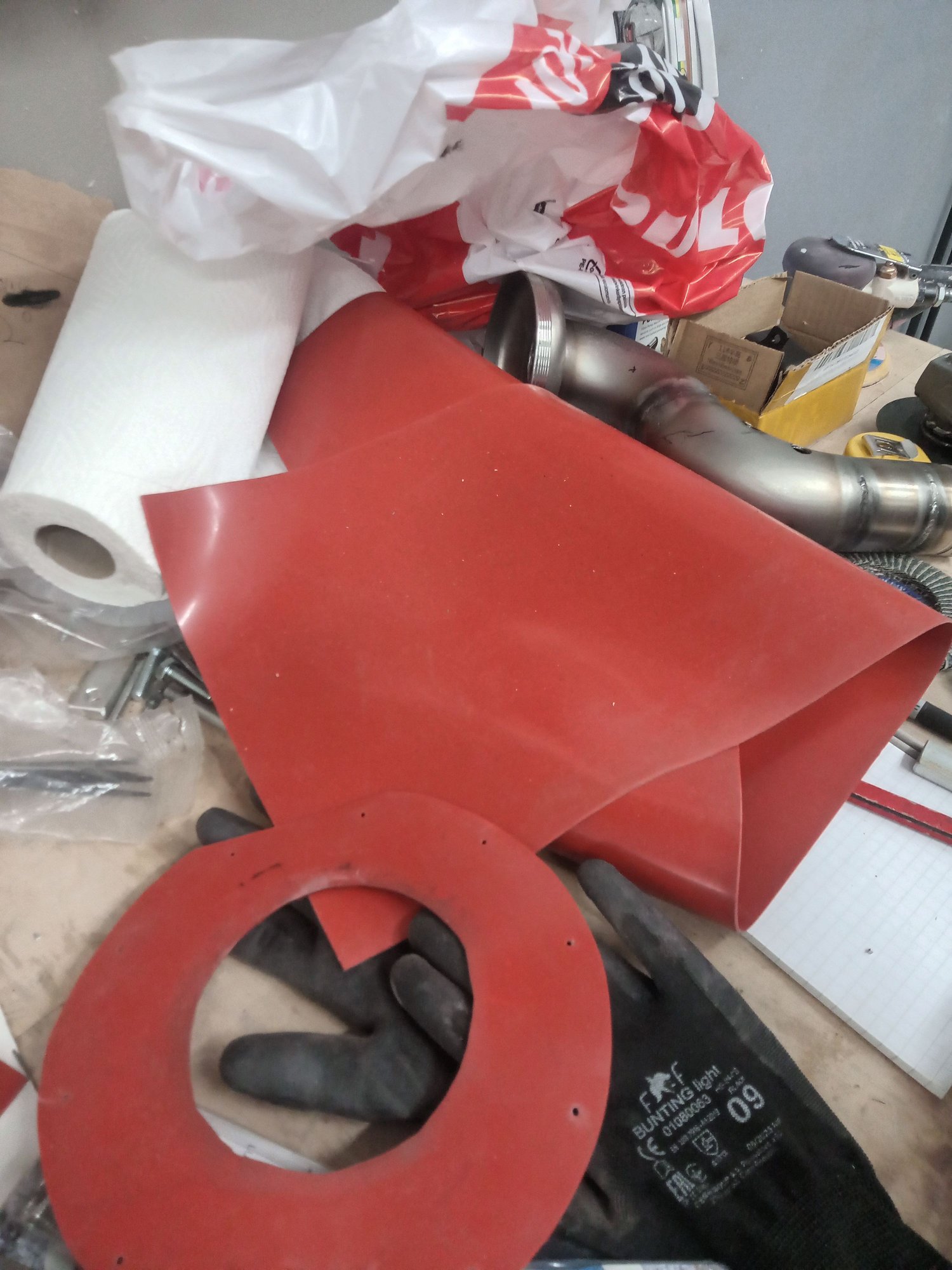

Exhaust are ready, this way I sealed big holes.
https://cimg2.ibsrv.net/gimg/www.off...121e1d27c7.jpg
First I weld 12 degree angle parts to get tails in right spot. Engine is also adjusted to level.
https://cimg9.ibsrv.net/gimg/www.off...02fabcfaf5.jpg
2mm thick silicon sheet, it can handle near 300C temps so it's good sealing material. It doesn't matter if some day there is little tailpipe overheating issue. Silicon is also very flexible and stretchy so it can be slip over pipe.

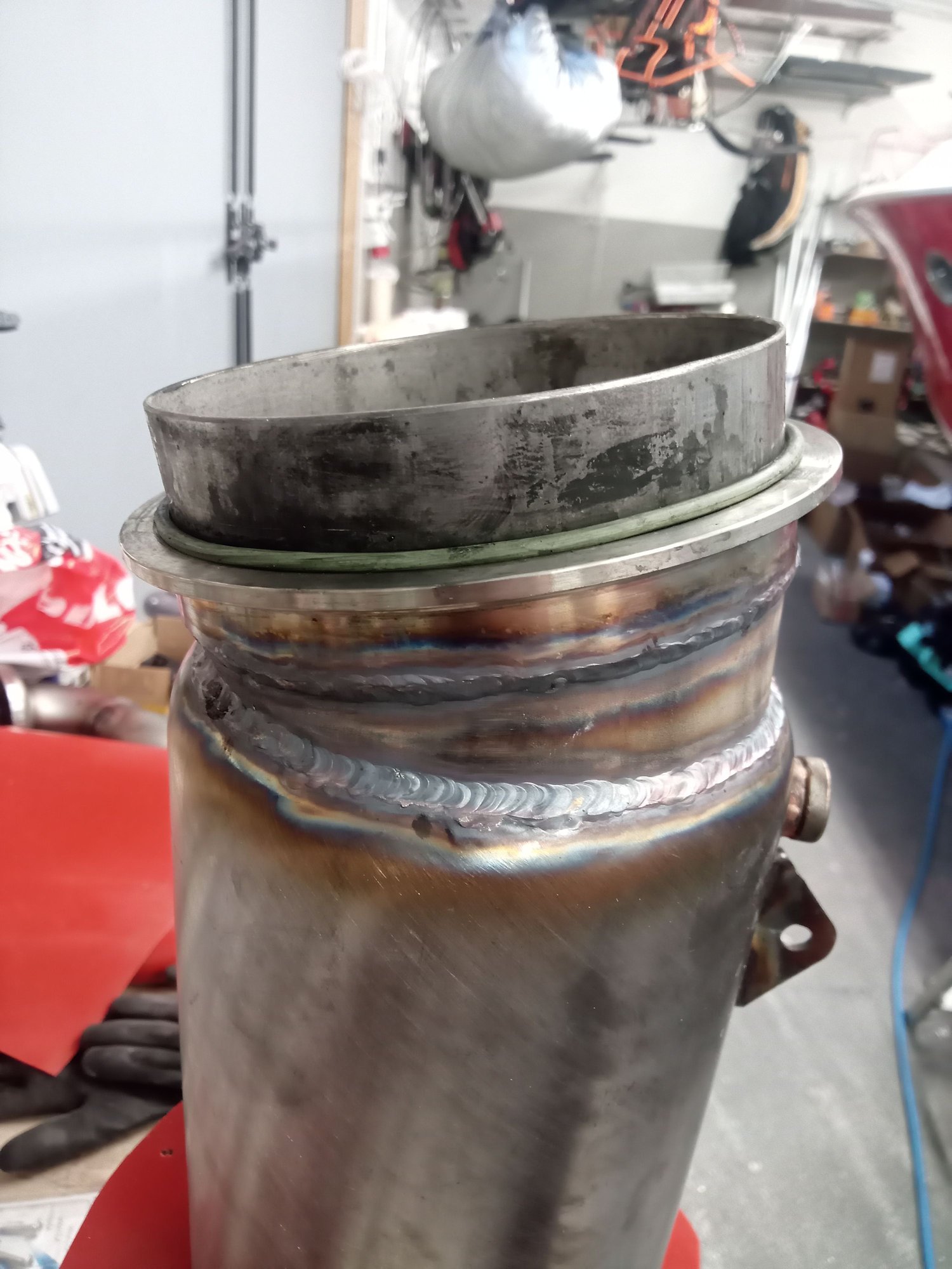

Stainless steel water cut flange push ***** lip against to transom, should be pretty watertight.
https://cimg0.ibsrv.net/gimg/www.off...c9e34b9a19.jpg
https://cimg5.ibsrv.net/gimg/www.off...c4917f08f3.jpg
I try find black silicon but red was only available, color doesn't matter now because splash is so close. No time to lose!
As you see, pipes are litte up in holes, there is little tolerance to adjust driveshafts more in line (lift splitbox side of powerline up) if boat needs bigger trim angle. Engine is now set 2 degree trim angle to get CV joints as little angle as possible.

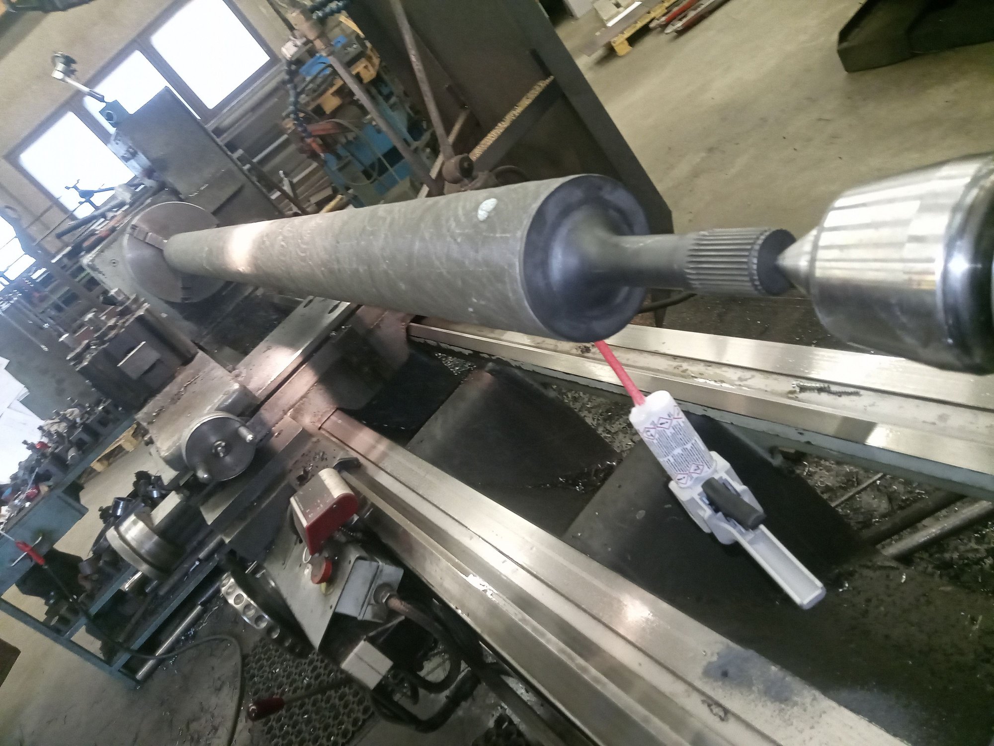

Carbon tube end turning to straight, there is special tool locked inside tube to get support for outer end.
https://cimg5.ibsrv.net/gimg/www.off...dcb91664f4.jpg
CrMo end pieces pressed in and first one is now glued! Another will be glued tomorrow, soon I can assemble CV's and put shafts in boat.
https://cimg4.ibsrv.net/gimg/www.off...934f6e108e.jpg
Nobody know how these hold up but if my calculations are right, glue joint have 40 times safety factor and tubes should hold two times the power. Transmash will be in good tune if it have so much power to explode carbon tube.....
