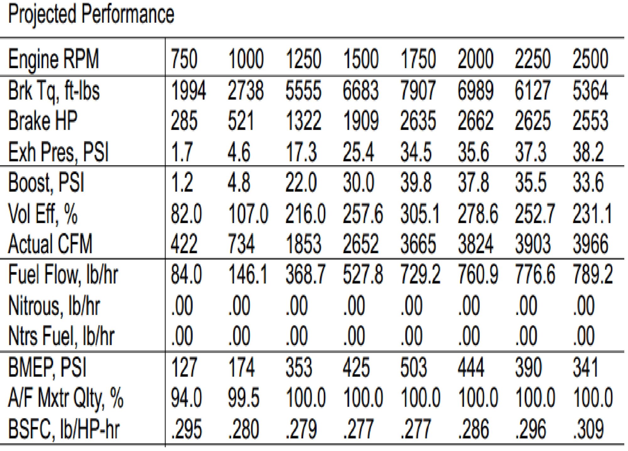

ksalmine 06-25-2025 01:46 PM
Fuel consumption should be near half of triple 525 at same speed. Engine analyzer show under 0.3 BSFC, hydrodynamic drag and drive losses are way down. It doesn't need to turn six anglular gear in 140 heavy oil at 5500rpm.... My transmission spin like straight shaft in 4th gear, splitbox are not full of oil and it have straight cut gears, drives are just straight shafts and surface piercing props should get 10-20% more efficiency. Time will tell us when I managet to get old lady on plane.
https://cimg4.ibsrv.net/gimg/www.off...e4002ed90b.jpg
Here you can see calculation, AFR is lean, no smoke. It's calculated with air to water intercooler, 75% cooling efficiency.
