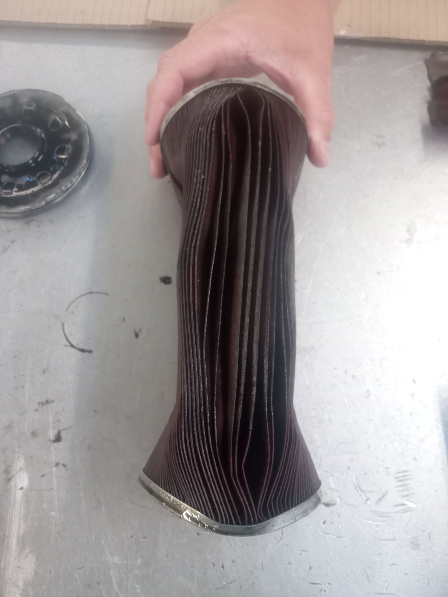

update. yesterday I change oil, it have diesel in it so some injector line, return line or something leak fuel in oil. But another problem found when I cut filters open, by-pass filter have collapsed because pressure difference, wierd.
https://cimg5.ibsrv.net/gimg/www.off...b4df4bed76.jpg
https://cimg1.ibsrv.net/gimg/www.off...914051ca09.jpg
https://cimg3.ibsrv.net/gimg/www.off...8b76a42940.jpg
main flow filters, two pcs, are 21 microns. this by-pass filter is only 5 microns and I have modified filter housing to feed turbos and injection pump from this filter. But there are some mistake that I think all oil go first to main filters and after that to one 5micron filter. I measure pressure only after filters so pump can be against catastrof valve like 15bars and after filter pressure is 3bars. I turn and weld bypass filter delete part (dummy filter?). pressure go up for little time but in test drive it drop again, I think fuel get in oil again. I hope this hot season end and I can work more with boat soon.
