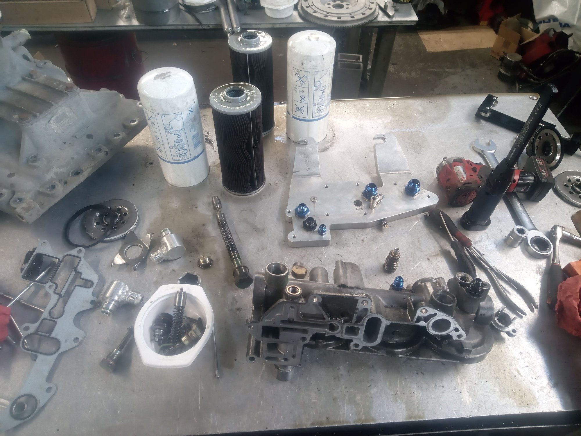

Back on engineering table. I try find any restrictions, there are few 90 degree elbows and maybe too little filtration surface. Solution is modify filter housing, I take by-pass filter off and modified housing to have three main flow filters instead of two.
https://cimg1.ibsrv.net/gimg/www.off...07c4c41ef3.jpg
By-pass were feed from already filtered oil from main filters. I have to machine and sleeve old feed and make some new feed from dirty oil side.
https://cimg9.ibsrv.net/gimg/www.off...b140a786cf.jpg
https://cimg8.ibsrv.net/gimg/www.off...6d0d8d8859.jpg
One hole had to plug, another get pipe inside for external oil feed tube.
https://cimg7.ibsrv.net/gimg/www.off...fc1cd6df2a.jpg
Voith automatic transmission banjo oiltube get new life in Transmash. Some heat and different angles
https://cimg5.ibsrv.net/gimg/www.off...c47ce470d3.jpg
Filter thread was different too.
https://cimg3.ibsrv.net/gimg/www.off...948ef58a01.jpg
Now filter housing have over 200% more flow. One more filter and I figured out that long life filters are better flowing, filters I used before was 21 microns and long lifes are 38 microns. I put three longlifes first and if problems go away then change tighter filters back one by one.
https://cimg1.ibsrv.net/gimg/www.off...a83d54911e.jpg
Oil cooler may have too low flow too, one bar shortcut valve past cooler if pressure differense are bigger than 1 bar, now this thing can't be restrictor anymore.
I take oil thermostat out from filter housing and simplify circulation as much I can. All oil go now from pump to cooler, then to filter housing, excess oil go to piston coolers, main flow in engine. Turbos and injection pump is reduset to 4 bars. Should work.

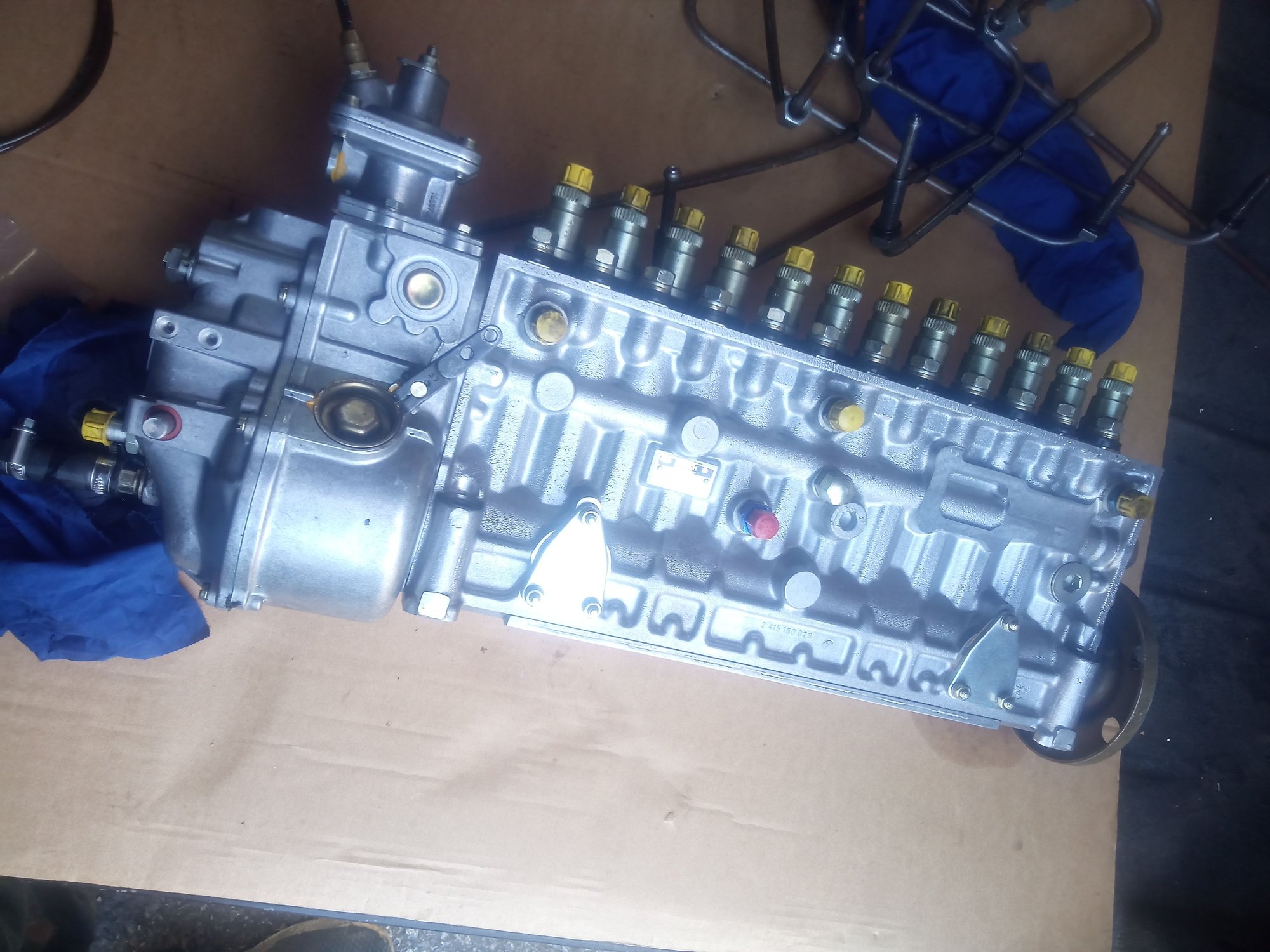

I remove pump too. Idle quality was so poor that I decided to change pump "controller" from RQV to RSV. RSV have better adjustment and control for idle and will not control fuel above idle by rpm, it's just like throttle blade in gasoline engine.
https://cimg9.ibsrv.net/gimg/www.off...96190131af.jpg
Finland best injection pump shop Akaan Diesel will change controller and adjust pump in this week.
Maybe next week we could see will these modifications work. Stay tuned!
