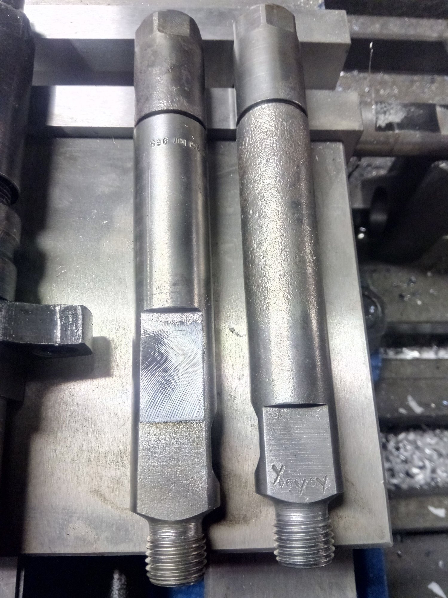

Russian injectors not well design, I replace them by Volvo THD103 engine nozzle holders. They use same P nozzle tip than Cummins 24V 5.9 engine so there are big ones in market...
Size is difficult, too big makes haze, too small doesn't give power and will broke injector pump or injector lines....
I think 7x0.017" are good to 13mm plungers and does not smoke. injection angle is also big mystery, may be better keep it stock 145 degree
Injector holders need machine and water cut new clamping flanges so they fit to engine, they are very hard metal to machine....

Injection pump base plate is machined and well lined to engine. There is no shop that sell modified parts to transmash, everything have to machine yourself.

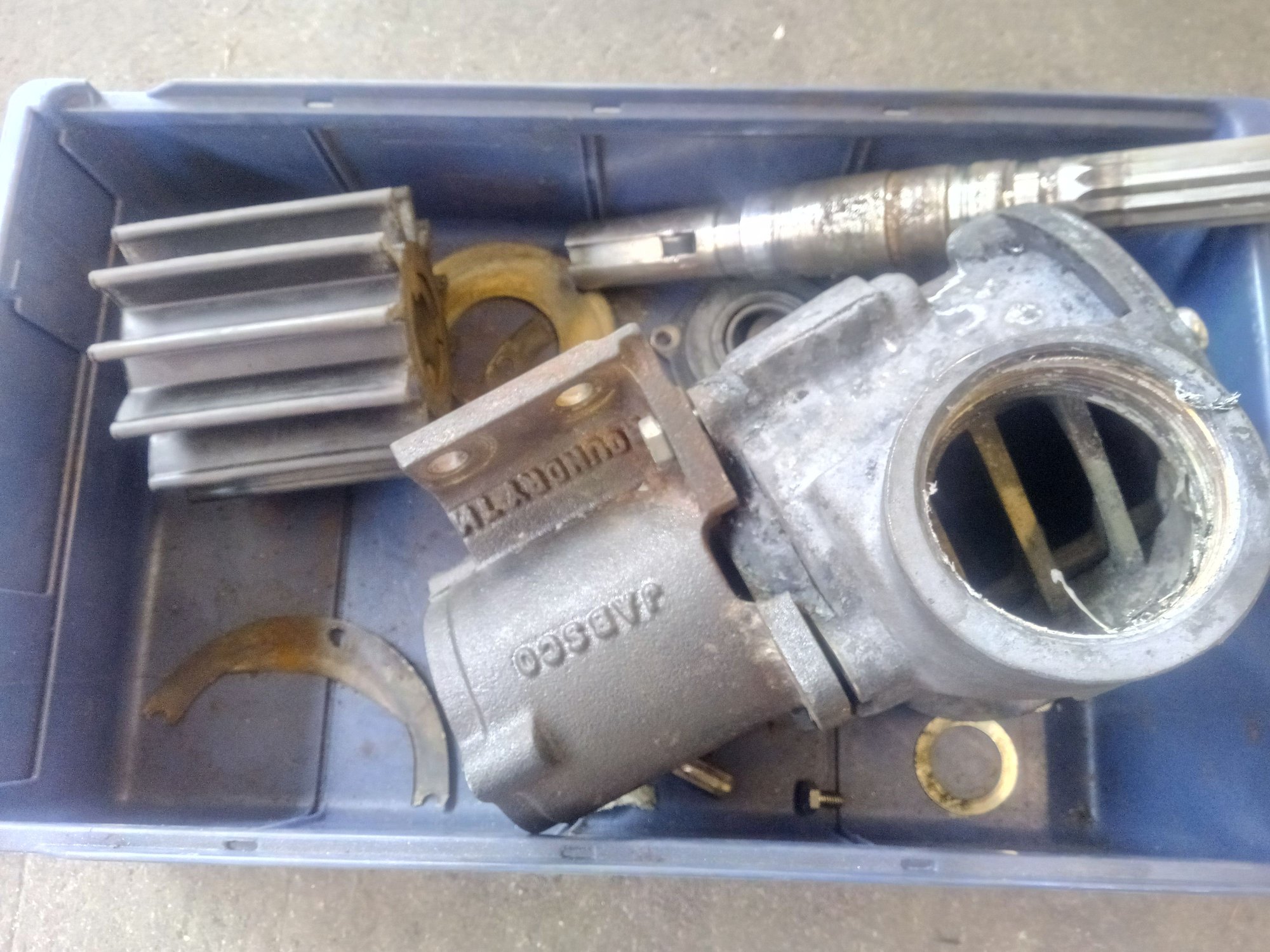

60mm waste gates have also arrived and I found huge raw water pump. It have 2.25" ports but have bearing failure, sand blast and fully rebuild and it should be ok.
