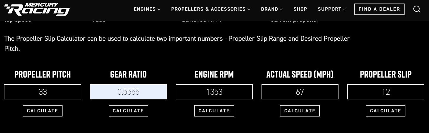

Here is Fountain 47 test result with twin 1350's. Most economical cruising speed is 58knots. It may be caused by best economy for engines in that loading and rpm, but it may be best efficiency for hull.
My cruise rpm is about 1350 at most efficient spot, 67mph/58 knots if slip is 12%. Engine is very happy at that rpm, will live forever running low loading and rpm. 70GPH consumption in test boat gives about 800hp continous power for 67mph cruise speed. Transmash should burn 55gal/h in same load. 0.45BSFC vs 0.32 for Transmash, this is just guessing.

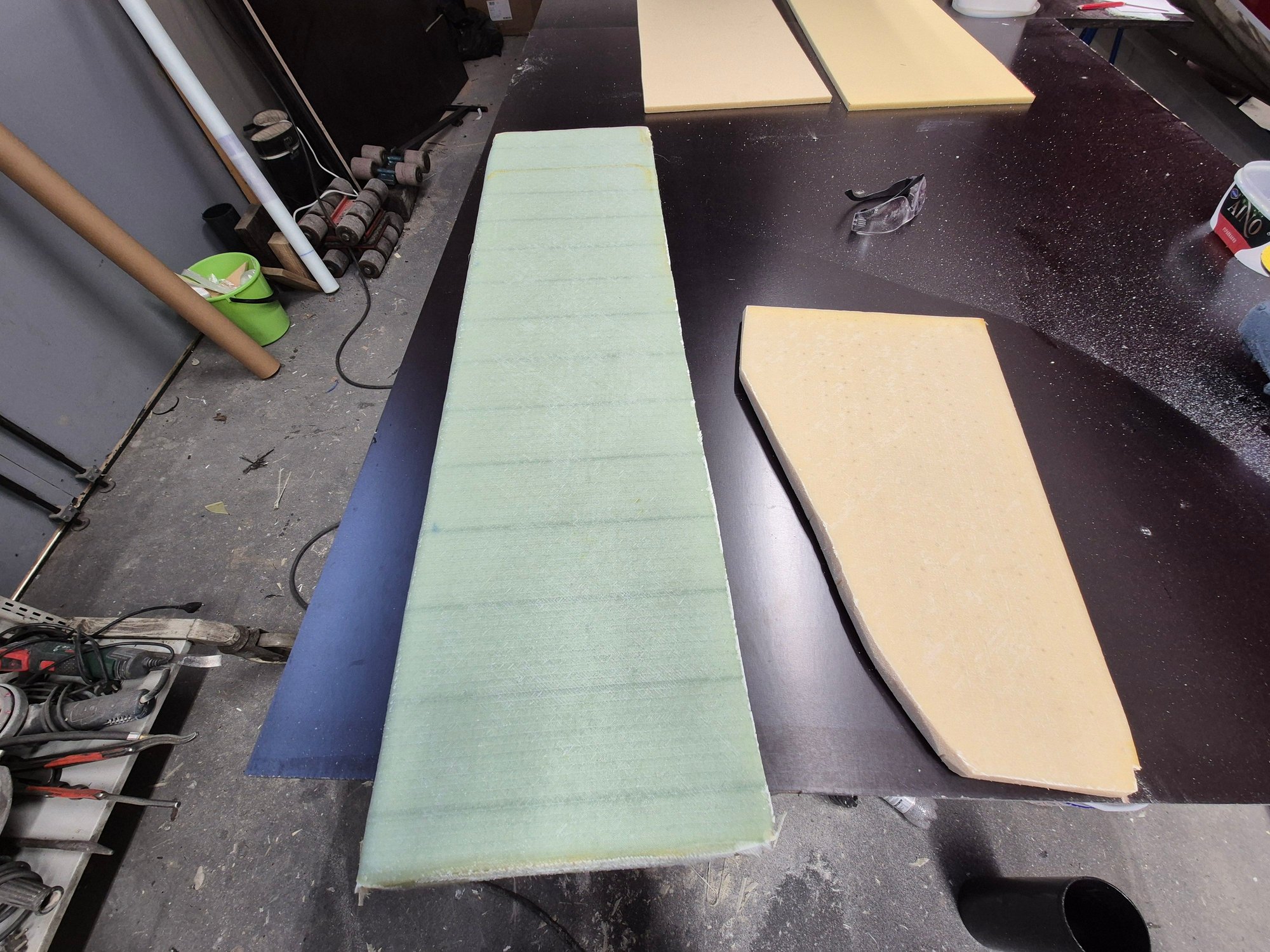

Grid is complete now, it takes lot more time than I think as usual.
Next job is design and do some interior, Stringers are now lower so there is many options for nice overnight cabin.
Tabbing for transverse parts need lot of glass pieces, I first think to cut just one piece for each triangle times two layers but it was too big job so I just make smaller tabbing pieces. They should work fine.
Toilet floor goes 15cm down so there will be almost standing height. I wonder to get usable shower there someday. Toilet floor is part of grid system and make stiffening to quite large bottom area under the toilet, there can not be transverse parts if toilet have good free height.
Bonding and laminating under toilet wasn't funny.
I bought oak veneer, it's nice to handle because veneers is bonded to some cloth behind. 3mx1.2m piece,0.6mm thick. I use it in interior, need to be dye dark color first.
Alcohol based wood dye may be best way, need to make some test to find best color for my taste. Then I will use ultraviolet light curing varnish, that is future clear coat way. No odors, easy thick coat, no sanding between coats, etc. Clean armor have good products.
Every empty space have to get in use as storage if we go to long ocean trip some day, so some hatch to every locker need to be done.
Divinycell foam is very easy to work. Hatches and floor opening edges may get carbon fiber cloth on, floor will be oak veneer finish.
Interior may be dark oak, carbon fiber and beige or white leather, perhaps.
Engine need some upgrades too. Injection lines must be redone, now they are too soft tube and ends are made poorly, you should never have done anything on someone else, everything should be done on your own. These are too long also, looks ugly.
Electrics are not complete, rpm gauge signal didn't work.
Turbos have to remove and take turbine housings to insulating company that makes nice stainless steel/wool insulating. KKD Motorsport is right place for that.
Drive shaft CV joint infrared temperature sensors have to install.
Breather is too small, 50mm breather with centrifugal oildust separator is on list.
And of course drive shafts! I decided to make aluminium shafts for next summer, they are temponary but save me time to do boat othervice better. Transmash won't have that much power now to spin them in critical speed, it have no intercoolers, power should be somewhere 1500-1800hp now. will get 1000-1400 more intercooled.
