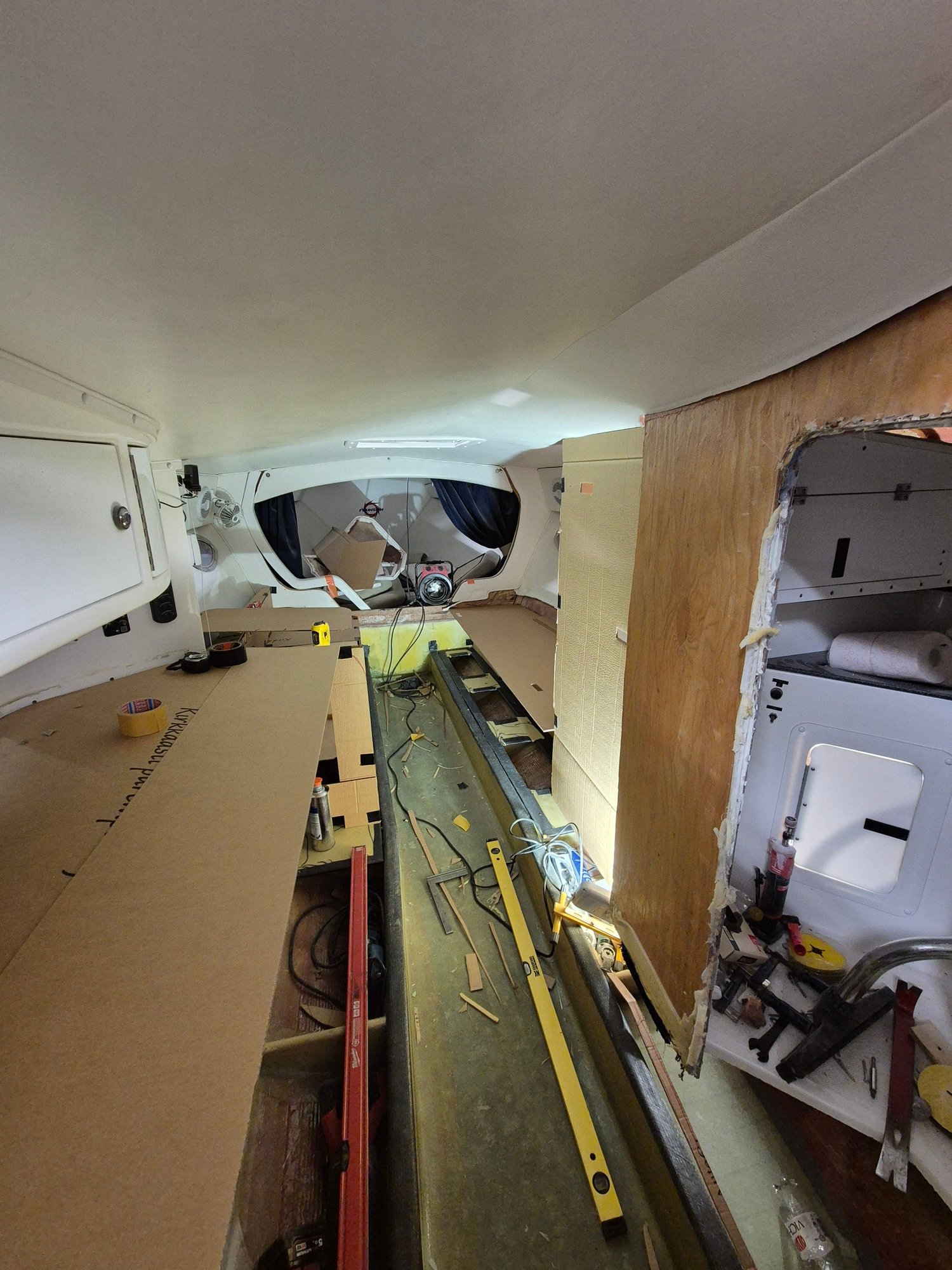

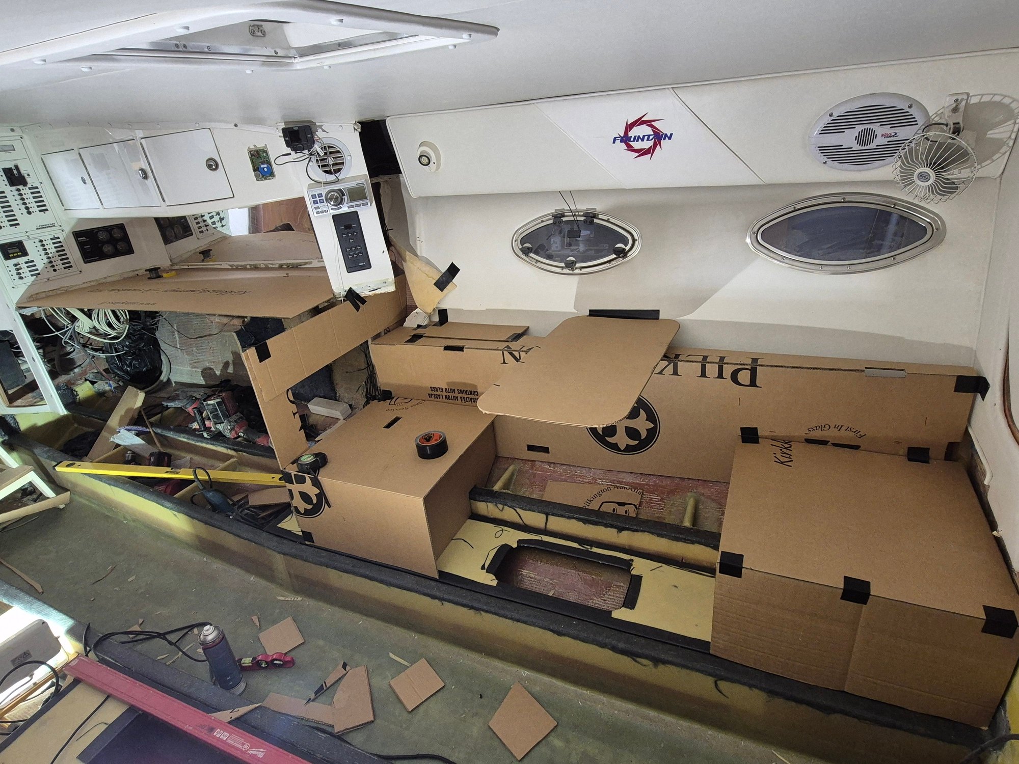

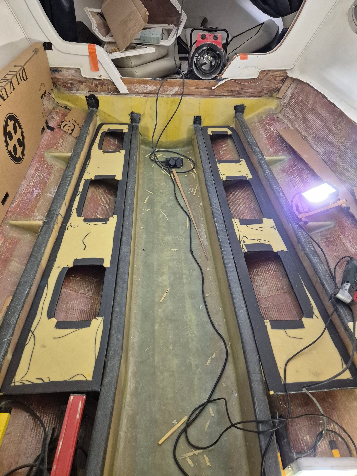

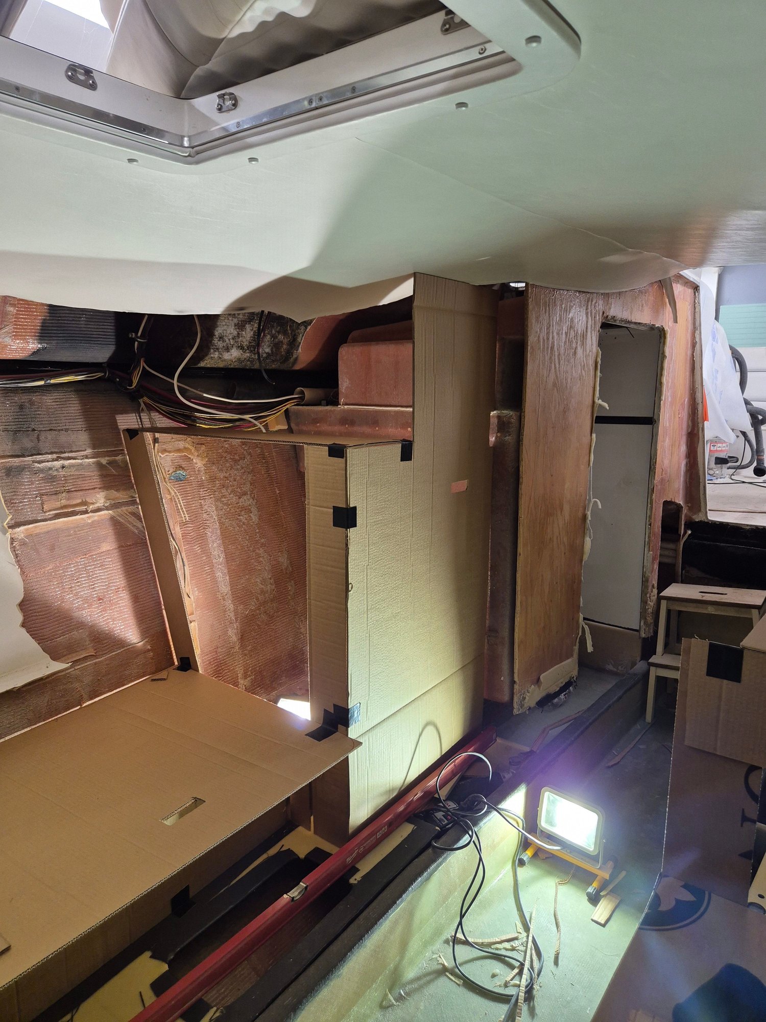

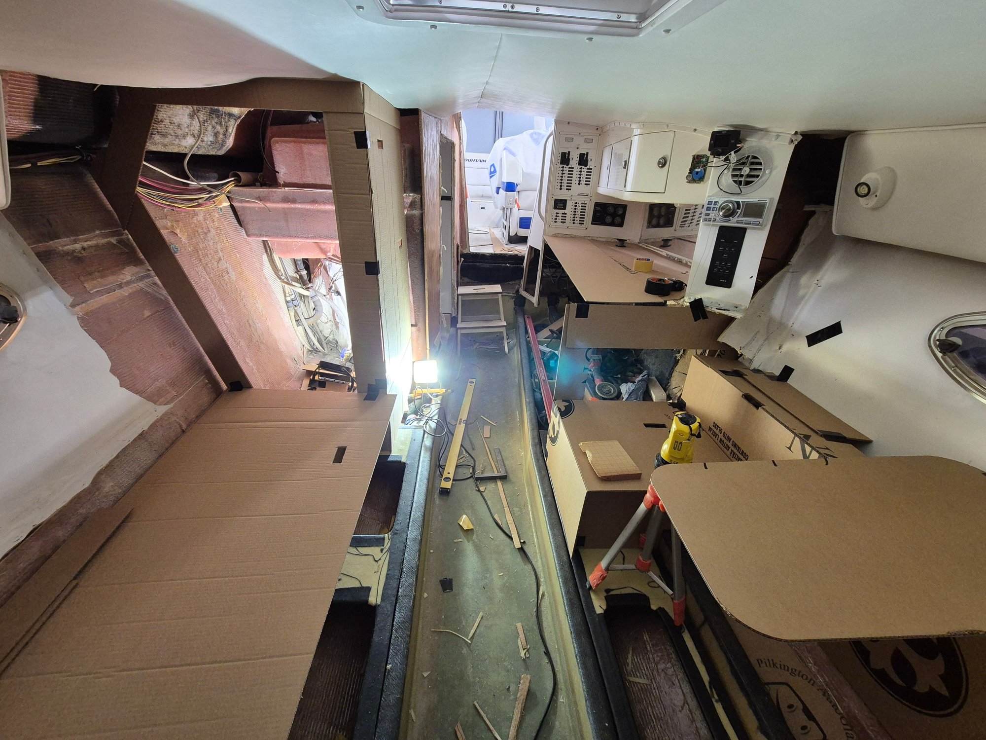

3D CAD design had begin in cabin. CAD means CArdboard Design. I can't make this complicated planning just inside head, I have to see and feel how you can move, how much free space, etc there will be.
Under sofa I wonder to fix roller blind mechanism so cloth can be stretched to roof making own cabin for Minnie (the little girl). Backrest could be lift up so if sofa is sofa backrest is down and when sofa is as bed, backrest can be lifted up so bed get wider and backrest cover hull windows to get cabin darker to sleep.
Next winter I blow that sh#tty design toilet off and build better with real shower possibility. It may be 15cm longer too but there is still good space for storage between sofa/ little girl cabin. Toilet have to get good heating and ventilation so it can be used as a drying cabinet too. It will be nice to get clothes dry as quick as possible if trip get rainy.
I really want dinner table and seats, table is too small and little too low now but close to good. Storage is more important than fancy round shapes, Real one won't be this square but close so I can make drawers in every empty space. I want convert this boat from dayboat to real cruiser so I can make two week trip with my family on the Finland coast or across nordic countries.
Floors weight 2kg a piece, not bad for 2meters long boards, they feel rock solid.
I think Fountain 47' could be convert to fast, good rough weather cruiser boat where you can live vacation time onboard. What you think? 120mph home on water, maybe, maybe not, who knows, but nobody had ever tried build one before this.
