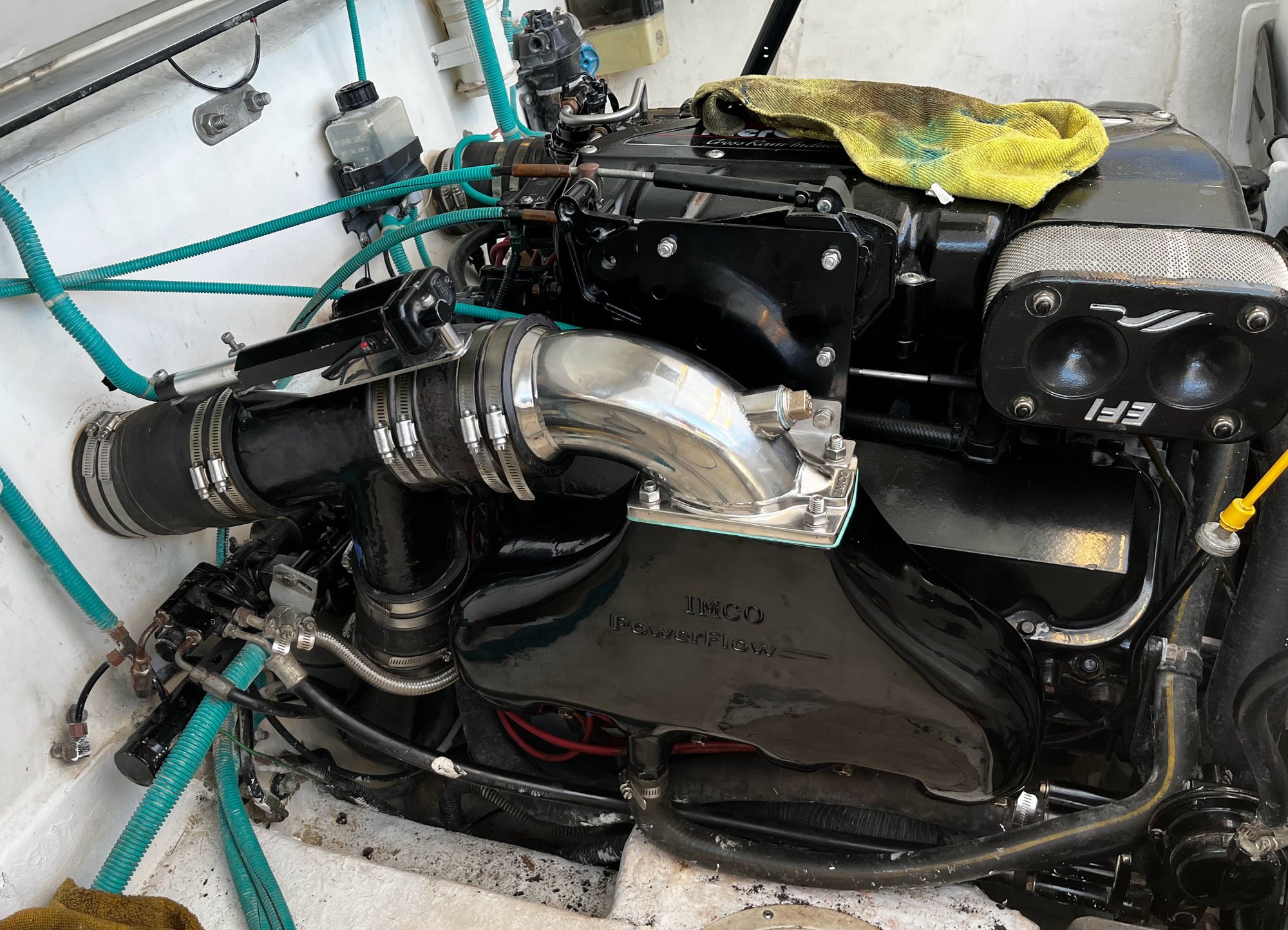

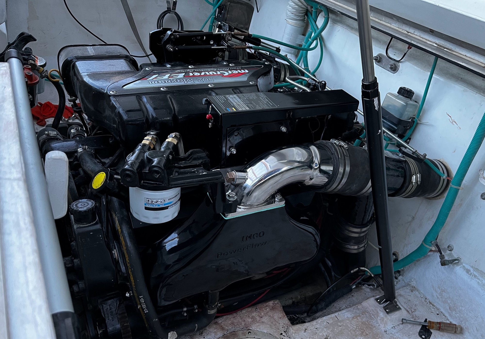

Got the chance finally to water test the boat, between weather, work, fun health challenges that are behind me (it seems)
Everything went very well once I got the oil filter fittings sorted out. I didn't like the IMCO bracketry, so just modified the factory filter bracket to work, and put an a couple of extension fittings on it.
The only problem I have is the bottom Y pipe hoses are just barely on there, due to the higher exhaust riser position.
And I have a very minor leak.
Does anyone know where I can get longer hoses that size? I have not measured them but understand from reading old posts they might be 3 1/2 or 3 5/8 diameter
Thanks
