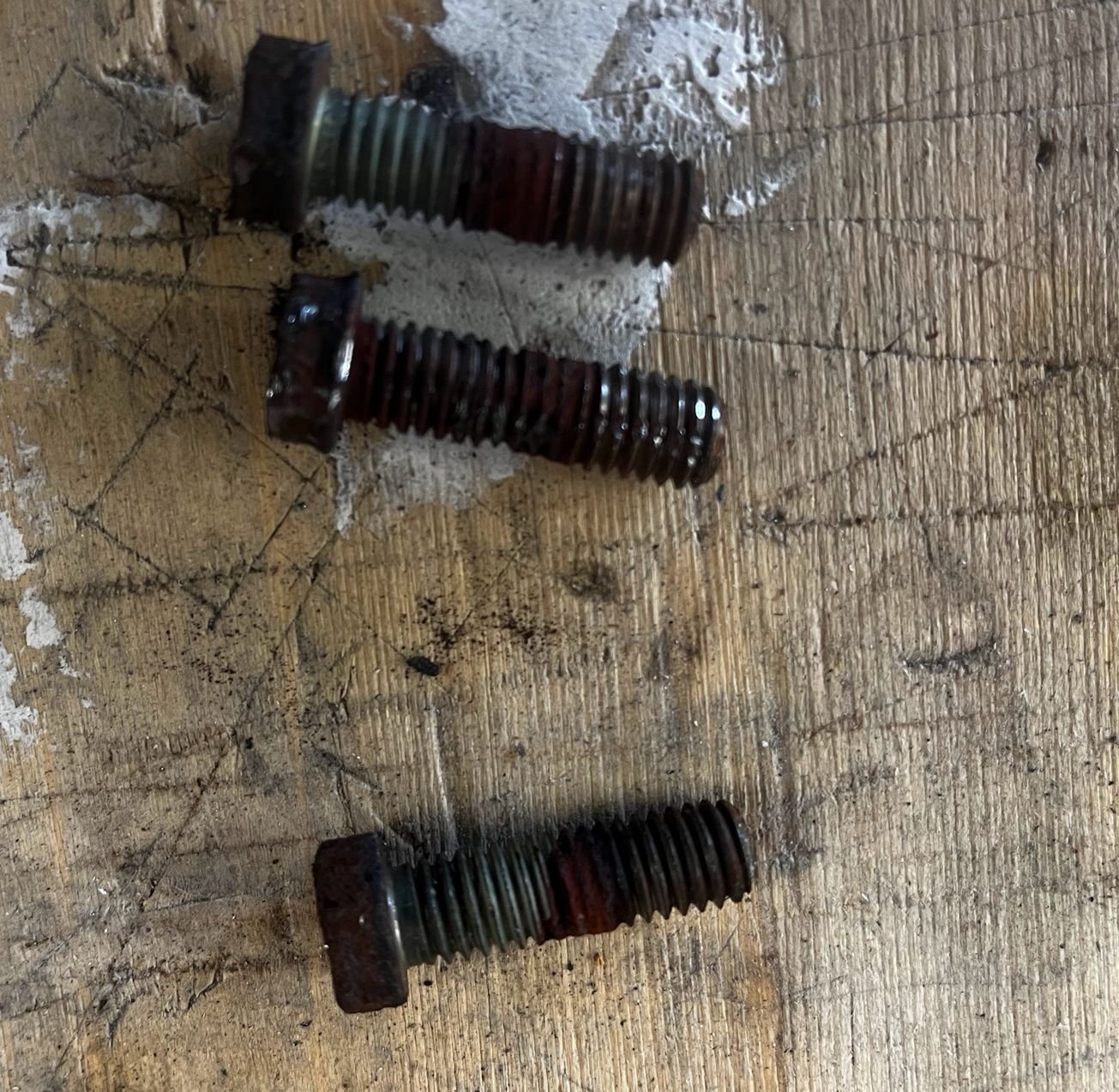

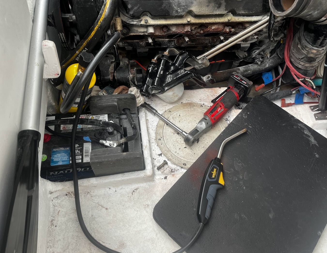

Well that was f@king awesome.
I want to thank all the lads that contribute to the forum, because it was this one that helped me get the rusted exhaust manifold off.
I made the mistake of removing the easy bolts first, then thinking everything else would be the same. Well the outboard ones were easier, but the inner ones wouldn't budge.
Eventually I stripped the bolt head partially on three. It took pretty much every trick in the book to get them off. I used heat (bought a new torch with a flex hose for easier aiming) tried nut extractors. That didn't work either.
One of the tips from a member here (can't find the post but remember reading it) was to keep pounding on smaller and smaller sockets, to bite the stripped bolt head.
That, and the heat worked.
Whew.... f@cking eh! Awesome. I will try not to repeat the mistakes on the starboard side.
Looks like the manifolds were due, also after being on the engine since new (1990's)
