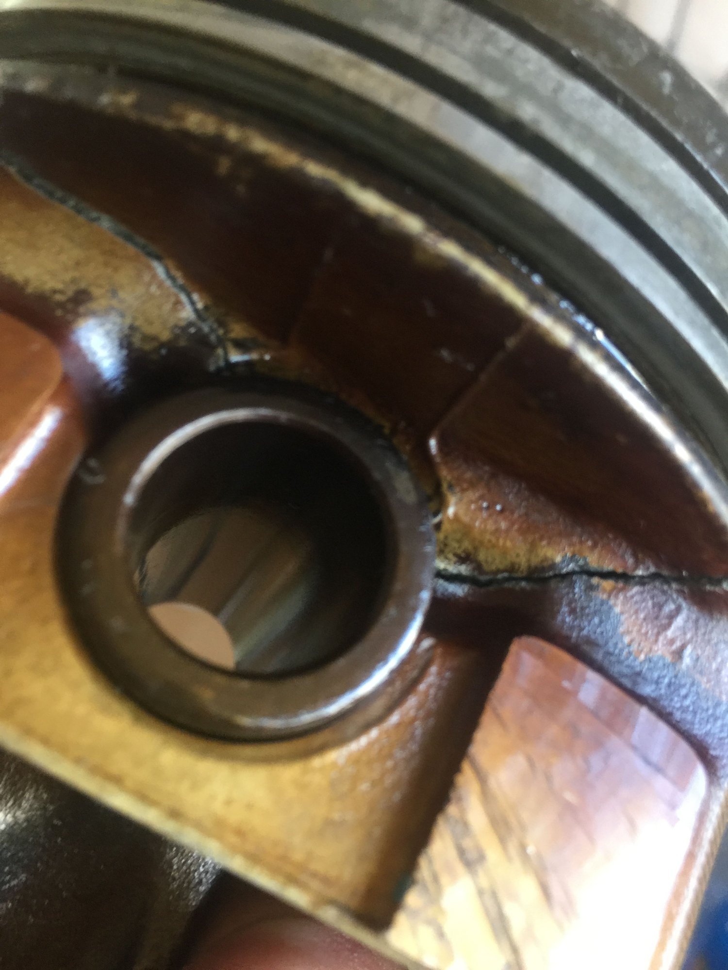

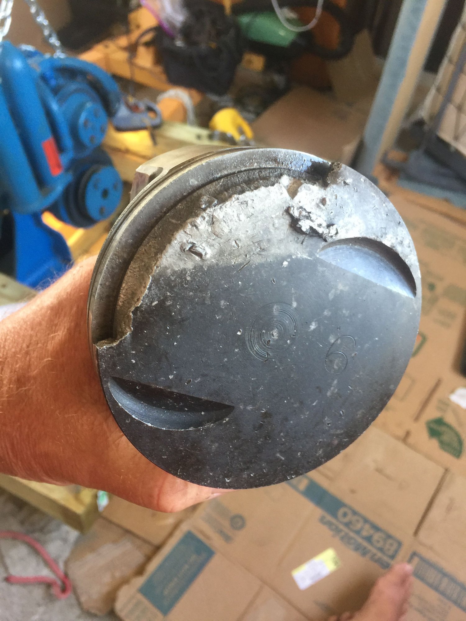

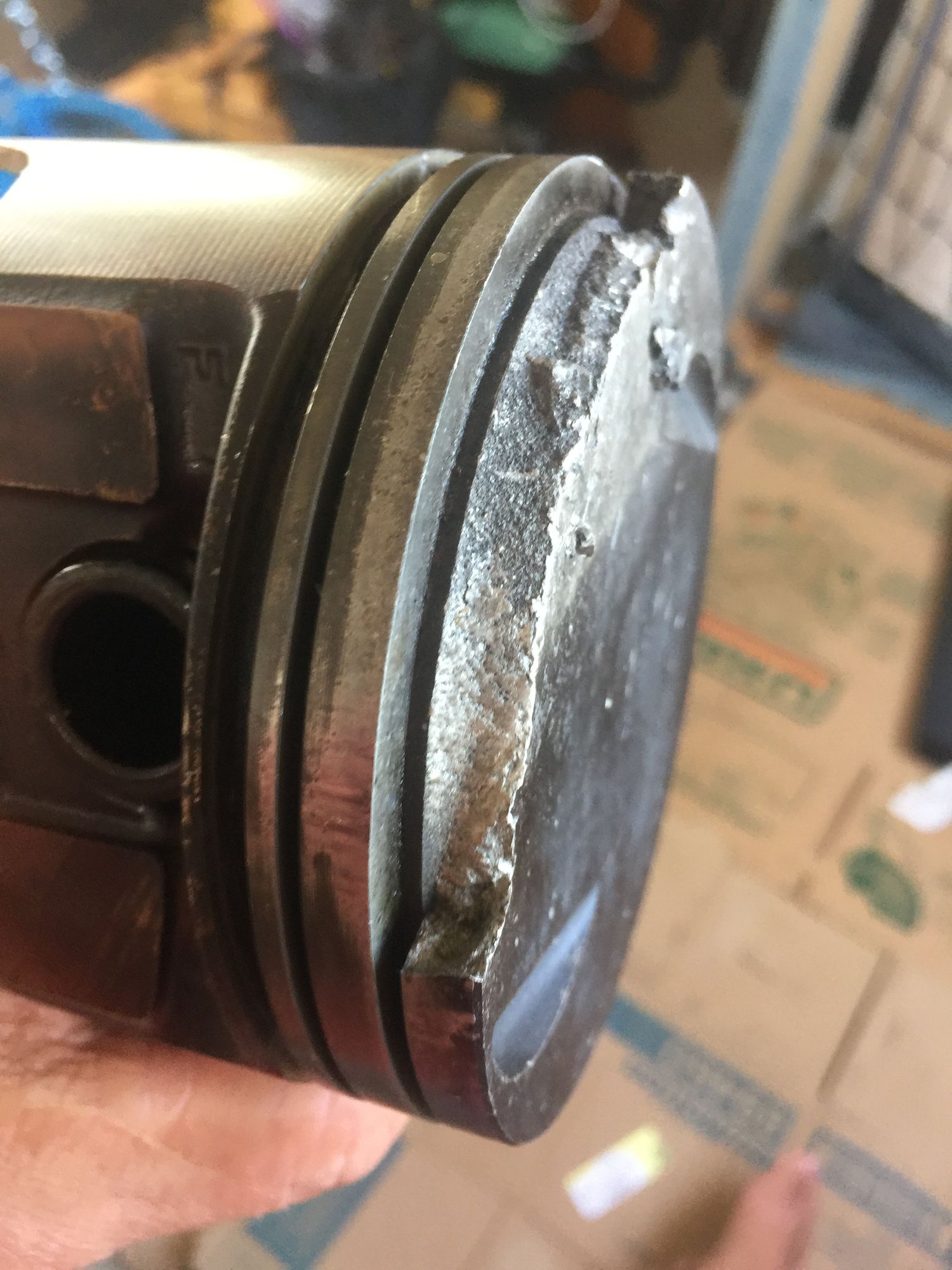

Just got done shoving 3 used pistons in one of my buddies 454-350hp 1986 Crusaders . If your going to reuse that exhaust and its been in saltwater at all you will never get those long studs loose in the risers, you can try but after hours with the torch heating the. riser I never got any of the studs to turn.
Cutoff wheel and cut into the riser A 1/4 inch from the joint and bang it apart. Riser and elbows and long studs will need aftermarket replacement as only the manifold is freshwater cooled.
tommymonza is offline
Old 09-27-2022 | 10:52 PM
Posts: 4,788
Likes: 1,377
From: naples,florida
The bad piston that got us to pull the motor with 2000 hours was seconds from disaster ,Cylinder was undamaged though. Light hone and found matching like-new used pistons on Ebay .
