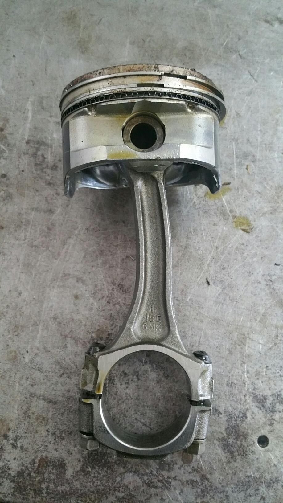

The factory 496 has some weak points when it's built up for more HP. The weakest link are the hyperuetectic pistons. The first ring groove is very close to the top on the piston so it's a weak point, and they can snap off the top ring land area. The second weak link are the rods, they just aren't up for high HP. The cranks are strong, even the cast cranks can handle 750hp.
The stock heads have very weak valve springs, like 90lbs of seat pressure, so a spring and hardware upgrade are needed if you go larger camshafts.
You can certainly build up a 496 and they run great, but you should beef up the rotating assembly if you really want longevity. Personally the most I would do with a stock bottom end is the Raylar 525hp kit. This would address the weak valve springs issue.

Old 06-12-2023 | 01:13 PM
Knot 4 Me's Avatar
Joined: Jun 2005
Posts: 8,412
Likes: 798
From: Central IL
Said piston/rod...
Knot 4 Me is offline

Old 06-12-2023 | 05:04 PM
Joined: Jun 2023
Posts: 4
Yeah, I’m my opinion that’s a rather spindly looking rod for a big block marine application particularly. Thanks for the info.
