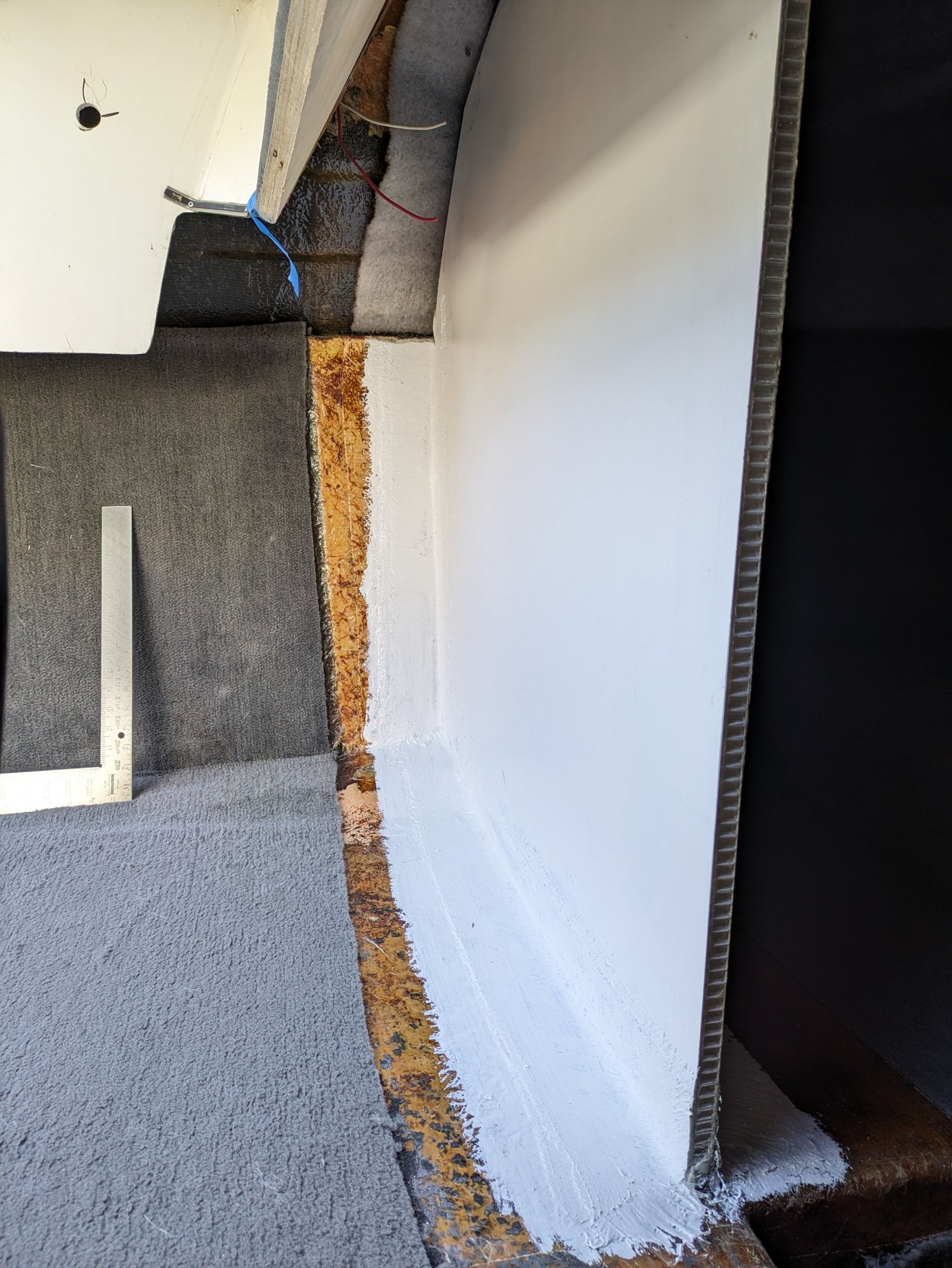

https://cimg6.ibsrv.net/gimg/www.off...6d89dac05f.jpg
Bulkheads glued in with thickened resin. Letting the fillets set up and then I'll come back over to layup the tabbing.

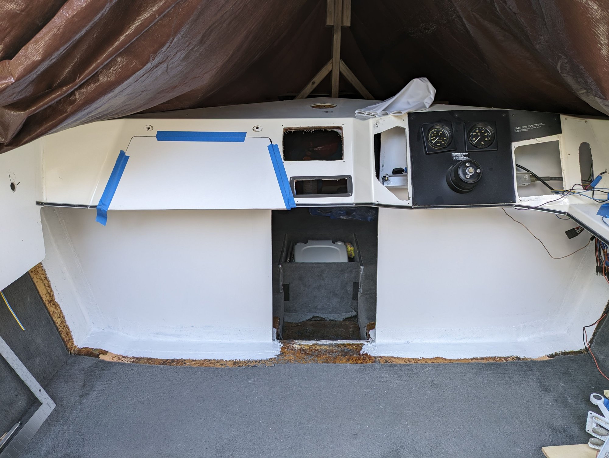

https://cimg8.ibsrv.net/gimg/www.off...94c911f3cc.jpg
got the bulkheads tabbed in today. Goal for this week is to get the dash fill glassed in and sand down the tabbing a bit

My temporary filler molds worked out great to build the shape
https://cimg7.ibsrv.net/gimg/www.off...86c441ab5b.jpg
https://cimg3.ibsrv.net/gimg/www.off...a6ee0f612d.jpg
https://cimg4.ibsrv.net/gimg/www.off...8089c68180.jpg
https://cimg5.ibsrv.net/gimg/www.off...d72d1b4ea1.jpg
https://cimg4.ibsrv.net/gimg/www.off...59f15a2beb.jpg
https://cimg9.ibsrv.net/gimg/www.off...aa82860cd8.jpg
2 layers of CSM and 4 layers of 1708 on top of core. 1 layer of 1708 to go on backside to seal everything. Feels very solid already though!

Gauge layout is going to change. This is bothering my ocd too much. Trim tab switch and switch panel will be to the right of the wheel... someday
https://cimg0.ibsrv.net/gimg/www.off...05f06e705f.jpg
So much sanding lol
https://cimg0.ibsrv.net/gimg/www.off...6445dd2237.jpg
Starboard dash fill tabbed into place on front side. Still need to glass a layer of 1708 on the back of both sides
https://cimg5.ibsrv.net/gimg/www.off...def0ba8358.jpg
Cuddy entrance trimmed up
https://cimg9.ibsrv.net/gimg/www.off...24ff334529.jpg
I think I'm finally to the point where others can see what I'm going for lol
