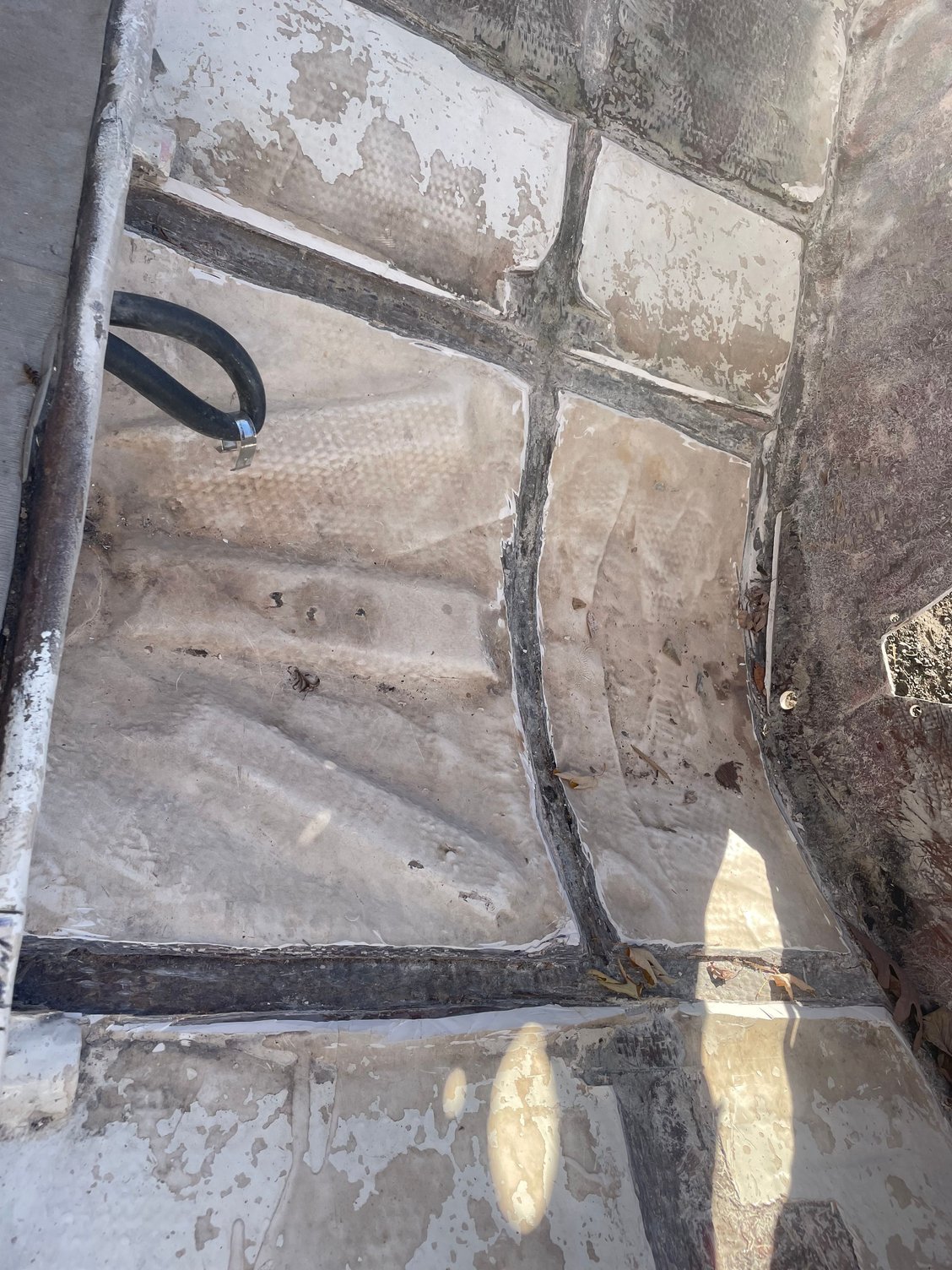

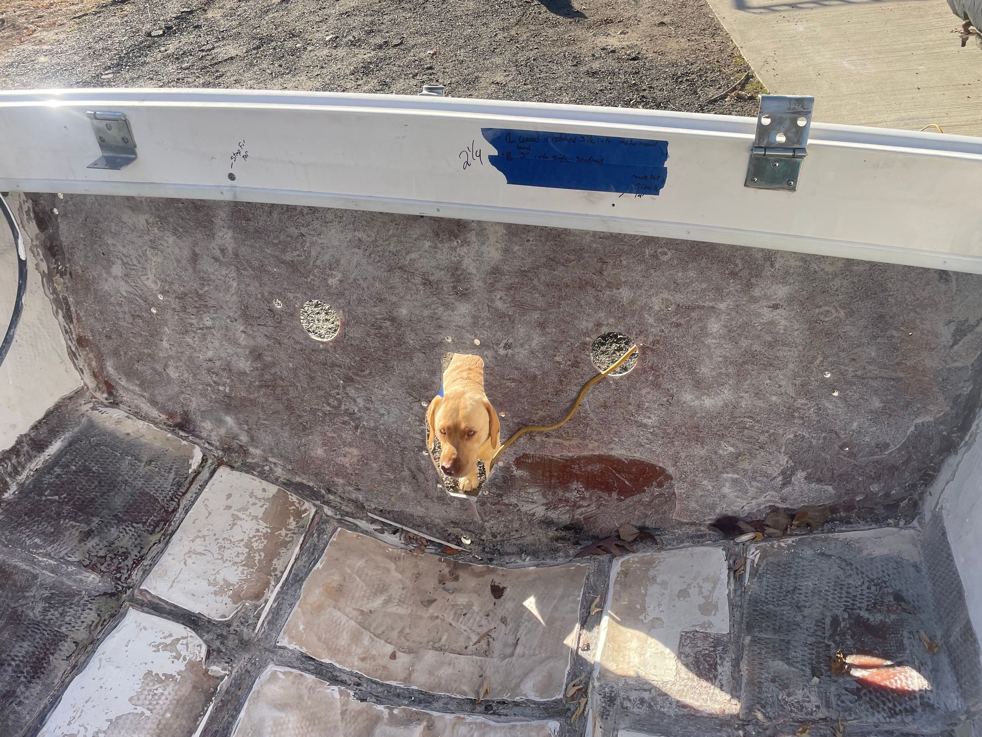

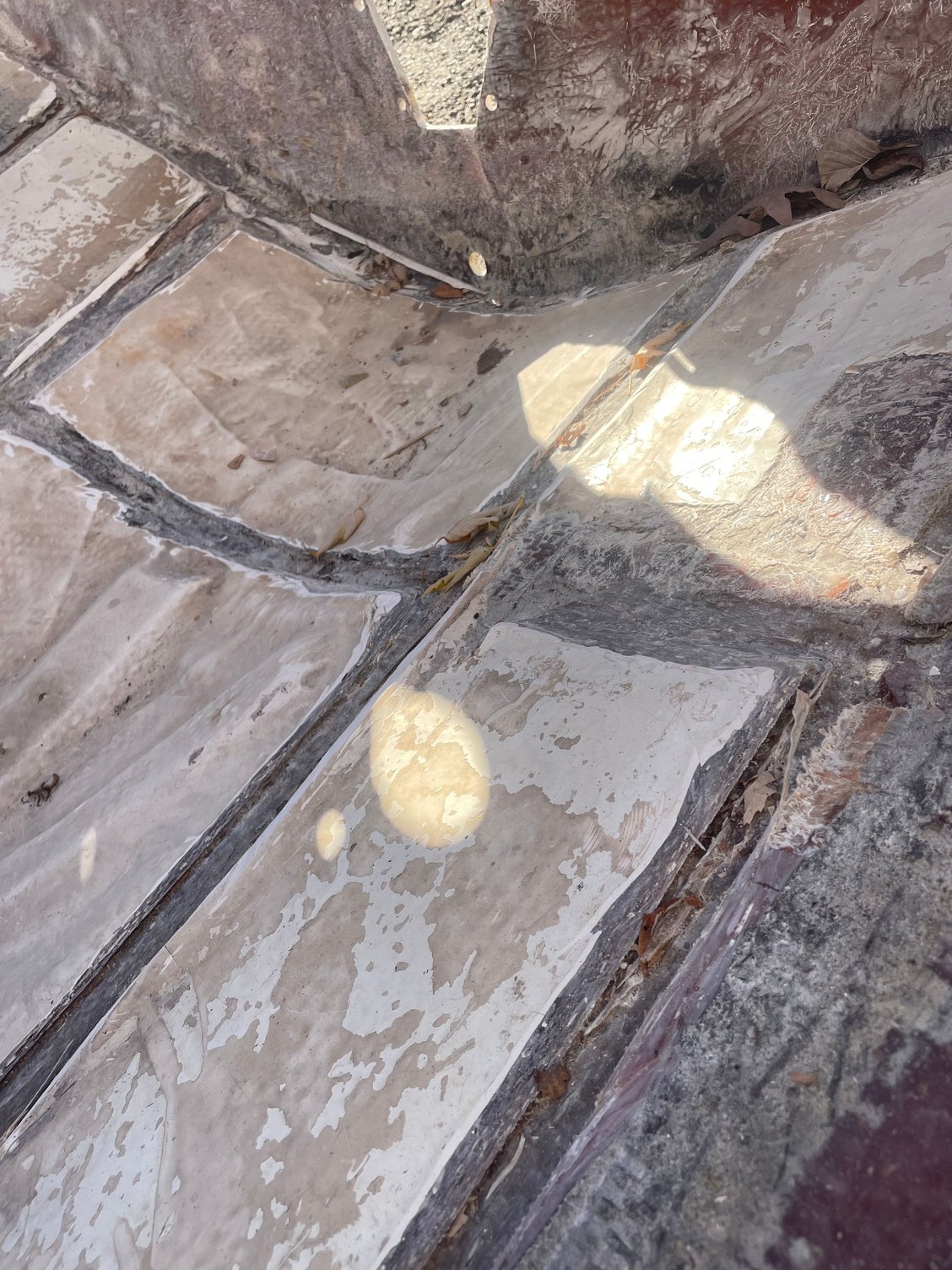

Thanks for the reply’s guys. Work has had me super busy. And every chance I get I’ve been working on the boat. So here is what I got.
moror is out, back wall is stripped and the stringers. The stringers were wet as hell and one spot was soft but weren’t to bad. The transome right side was a mess. I put screw driver into it and it all fell apart. The left side was solid. I think who ever is she exhaust, and the transducer didn’t seal it correctly. Anyway rant over
this is my next plan on action.
-some of the back fiber glass has little bit of waves to it from the wire wheel cup brush I used to get all the wood off. It’s not bad but has some spots. So I’m thinking of when I install the wood I was going to use the expoy for the fiberglass along the back wall instead of glue. So when pushed together it will all flatten out as one filling the voids?
-first I gotta make templet and cut the wood. My trans went in my truck so that’s been bigger to do. But later this week I’ll be making templet for the wood and cutting it out.
-my transome was 2 1/4 thick. Fiberglass shell is 1/4 so that leaves me with 2” the inside wasn’t that thick. So I’m thinking going with 3/4 sheet, 3/4 sheet, and then 1/2 sheet like mentioned before. Then fiberglass the inside an go from there.
-expoy first 3/4 sheet to wall let set up.
-glue second sheet to first, let set up
-glue 1/2 sheet to second, let set up.
- then I’ll make the stringers(that’s 3/4 and 1/2 Believe) get them installed
-install wood that goes left to right.
-then fiberglass everything. Looks like along stringers were like 1/4 thick. So I’m gonna do about 4-5 layers?
-then gonna gel coat everything
- all my holes I drill out for exhaust, swim platform I plan on putting expoy in the holes so it’s all sealed then scre into that.
Question for you guys is:
1. What oz fiberglass should I go with? I found bunch of them. Think I seen 17 oz? And it was in grids like ## that should be good right? If I didn’t have anyone to ask that’s what I would be using.
2. what expoy you guys use? I’m going to mesco(marine company) to pick things up. They have everything you can think of. So I wanna get the right stuff.
3. on my floor between the stringers the fiberglass to the floor is thick. I just cut around it all and ground it down and like 60* so when reinstalling stringers and all I can epoxy and fiberglass everything. Can I leave what’s on the ground?(1/4 thick) and just go over it. Tie it all together? I don’t see it being a problem. If not I gotta grind it all out.
p0tter7 is offline
