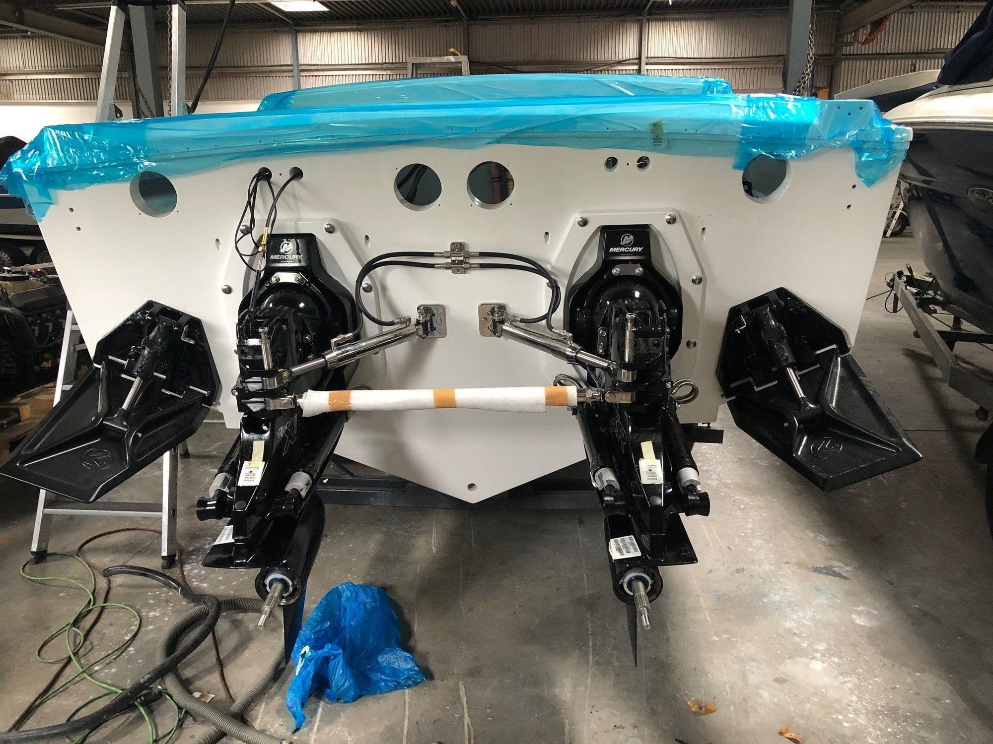

Why were those gigantic holes cut in the transom
Looks like they opted for a plate system to go from TRS to Bravo transom pattern. Though I'm not sure you would need to make such a large hole to achieve the aim.

Yes, precisely. We opted for a conversion plate system to switch from the old TRS footprint to the Bravo setup.
I am fully aware that the 'plates vs. filling the transom' topic is a subject of endless debate in the community. However, we made a very conscious decision to go down this route.
When we stripped the rigging, we found the original transom core to be in exceptionally good condition—it was bone dry and rock solid. We decided it was better to preserve that original factory structural integrity rather than performing invasive 'transom surgery' when it wasn't technically necessary.
The system has been absolutely rock solid and trouble-free for us so far, so we are happy with the decision.

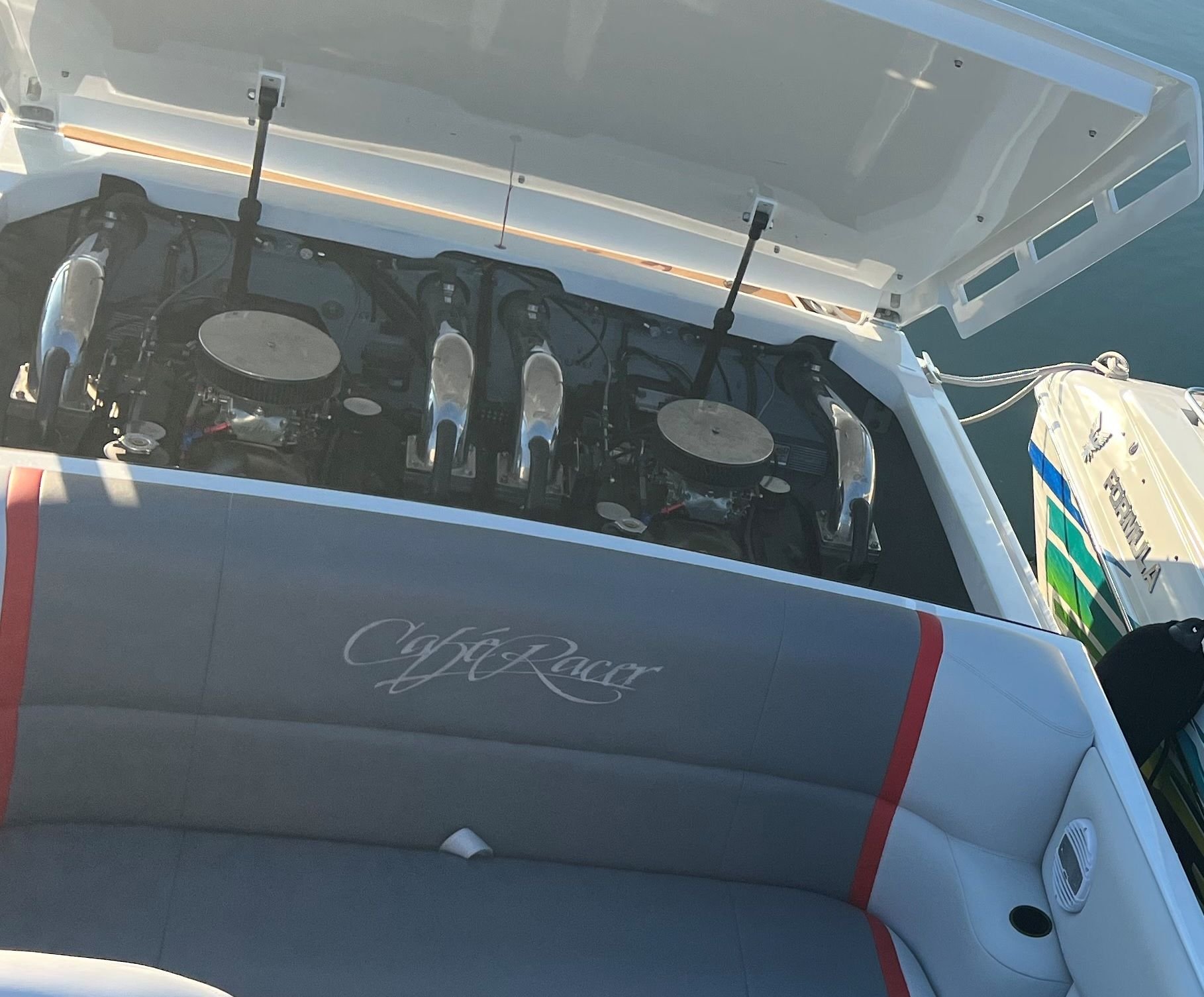

However, looking closer at my exhaust setup (see attached pics), I think the AFRs might cause me a headache during installation:
I am running stainless CMI-style headers with fairly rigid plumbing through the transom. I don't have long soft rubber couplers that could easily absorb the ~.375" raised exhaust port height of the AFRs.
I am worried that the higher port location would put the whole system under tension or cause alignment issues at the transom rings.
That’s why I am leaning so heavily towards the Brodix Race-Rite: The guaranteed 'Stock Exhaust Location' is a huge safety factor for my rigging. I'd rather spend the extra effort on milling the Brodix heads than fighting with exhaust alignment later on.
I guess, I’ll stick to the Brodix plan for now to keep it a clean bolt-on process.

Originally Posted by stefan572
Thanks for digging up the specific AFR stats!
Those 290cc heads with the 112cc chamber option are definitely a 'tasty' choice technically. Under different circumstances, that would be my go-to to save on the machine work.
Important to note that the 3/8" raised exhaust ports...move the exhaust manifolds out 3/8" at a 45° angle. Your outwards and upwards movement would be 0.265" each.
So exhaust manifolds between engines... would lose 0.265" × 2. 0.530".
Tartilla is offline

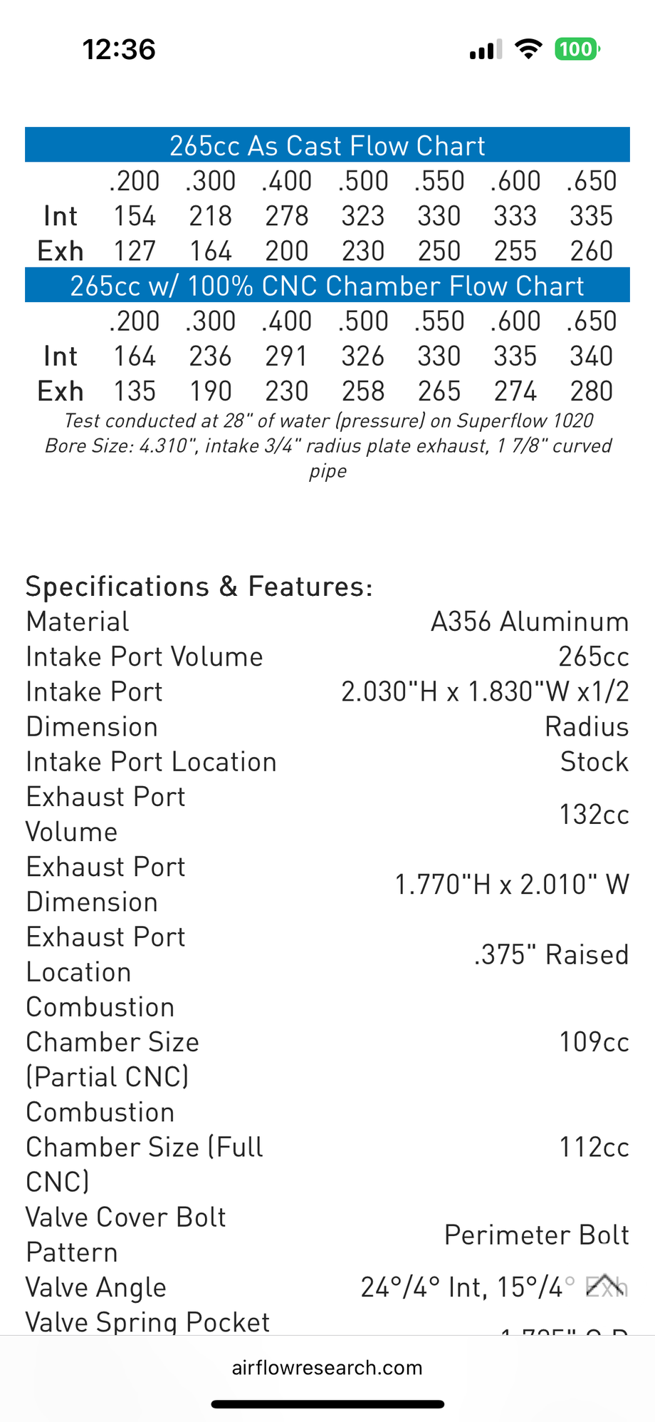

109cc on the AFR 265
https://www.airflowresearch.com/265c...nder-head/p603
That is a tiny head and valve that gives up a lot of flow up top though.
