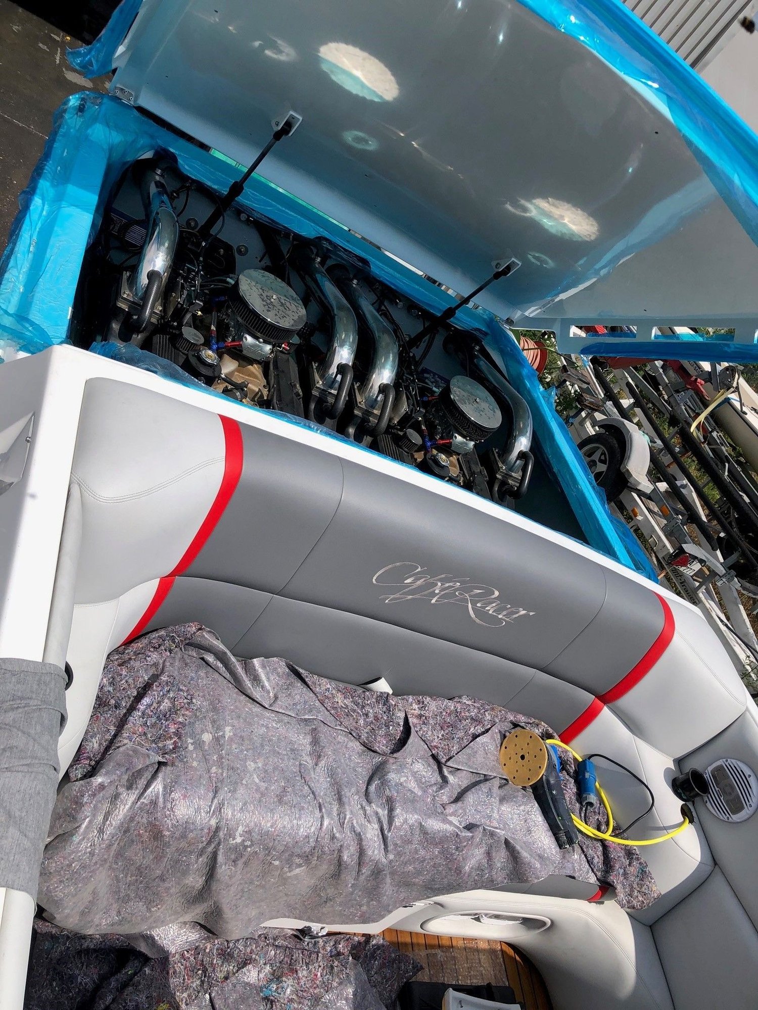

I bought my 1987 Cigarette Cafe Racer 35 a few years ago (it already had the Gen V/VI 502s) and restored it to my liking. After three seasons of having a blast with it, one of the roller rockers failed. That was the trigger to pull the valve covers and dig deeper.
Upon inspection, we found that the issue went deeper: the stock iron heads were completely worn out (valve guides/seats are done).
So, instead of just fixing the broken rocker and sinking money into refurbishing the old iron, I figured this is the right time to let the project "snowball" a bit and upgrade to aluminum heads to save ~200 lbs off the stern and pick up efficiency. I reached a decision point regarding the new setup and could really use a "sanity check" from the OSO experts.
The Boat Setup:
  • Hull: 1987 Cigarette Cafe Racer 35.
  • Drives: Converted from old TRS to sturdy Mercury Racing XR drives.
  • Balance: We structurally modified the engine compartment and moved the engines forward to optimize the center of gravity (CG).
  • Cooling: Full 2-circuit closed cooling system (antifreeze in block & heads).
  • Use Case: Typical offshore chop, cruising 3500-4000, WOT blasts limited to ~5200-5400 RPM.
(See attached pictures of the boat below)

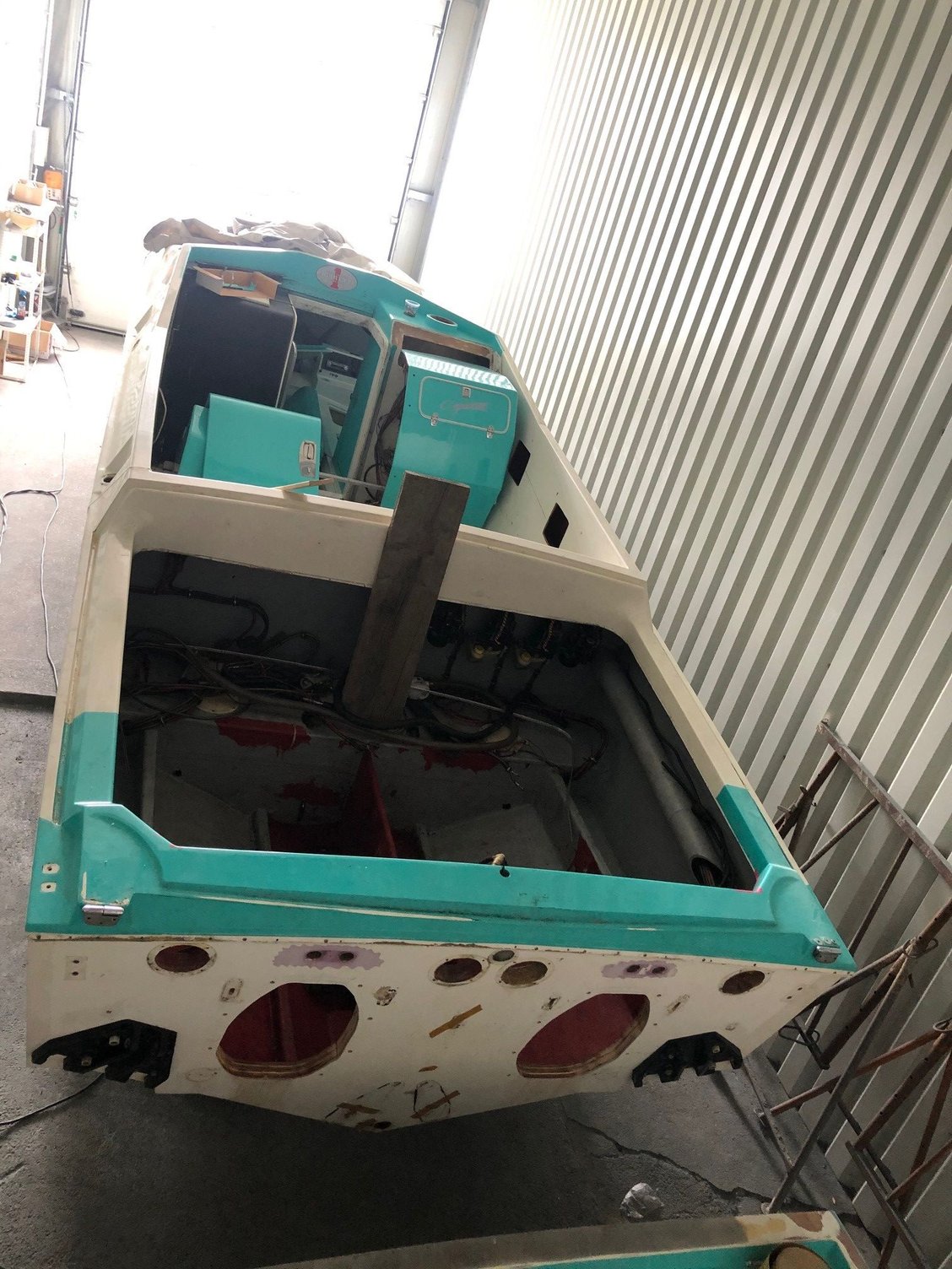

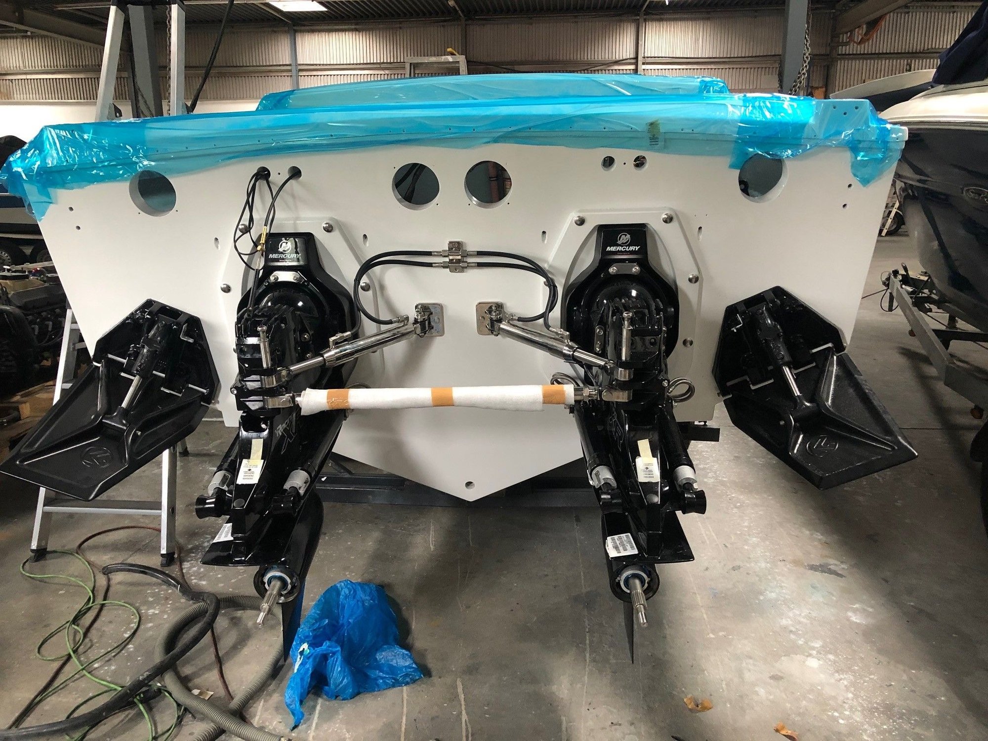

Why were those gigantic holes cut in the transom
