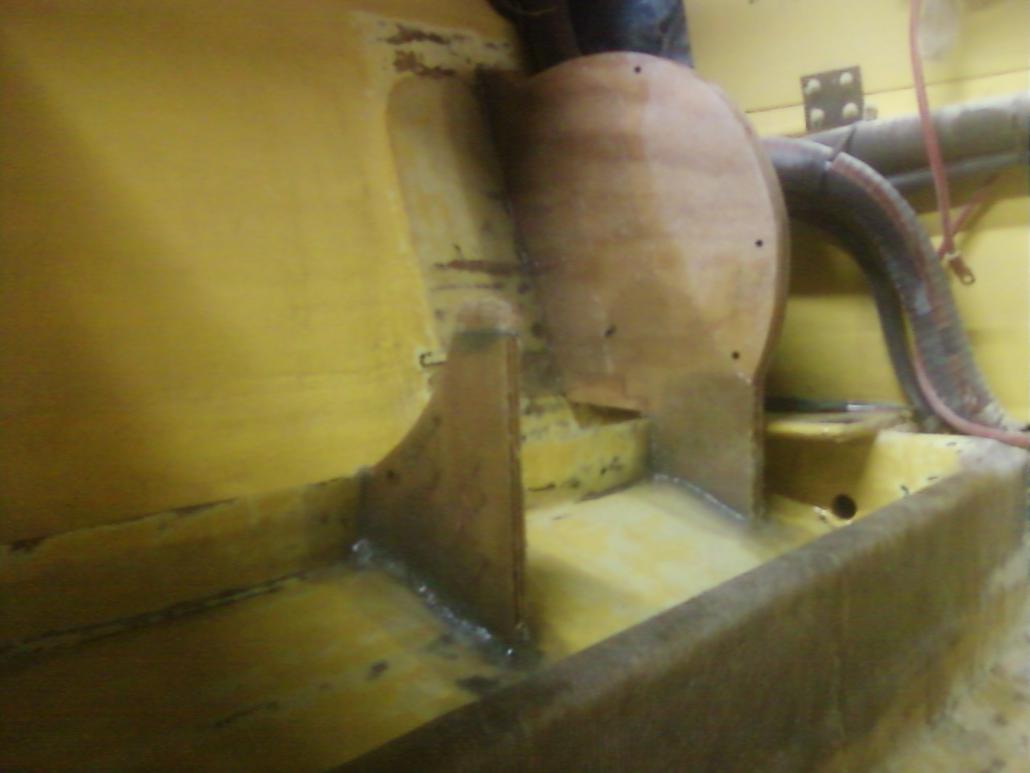

Just finished glassing in one side of the tank mounts.. Nothing to exciting to look at but we are always asking for progress pics so here you go.. The front mount is 2 sheets of 3/4" bonded togather with 1.5oz mat then glassed over & then nicely tabbed in with a few layers of 1708 bi-ax.. The other 2 shorter mounts are done the same way except 1 sheet of 3/4".. All of it was then locked togather with the stringers with mostly a solid sheet of 1708 & good ole Vinyl Ester resin..
I also managed to get the mounts to be welded on the other tank cutout today along with the flatside that faces the sides of the hull sheared & the sending unit mount ready to weld up.. Hopefully I will get it to my tig guy this weekend & have it back in a week orso & then its start glassing up the other side..

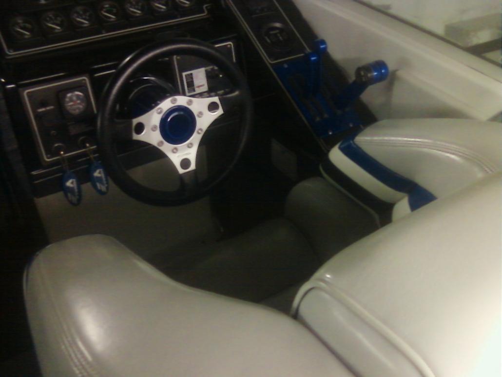

Heres a shot of the Formula dash & the most comfortable bolsters I have ever sit my rump in !! Just before cleanup & fire up on the hose tomorrow... The boat sounds So SWEET !!! Esp. bouncing off the walls here in the shop.
