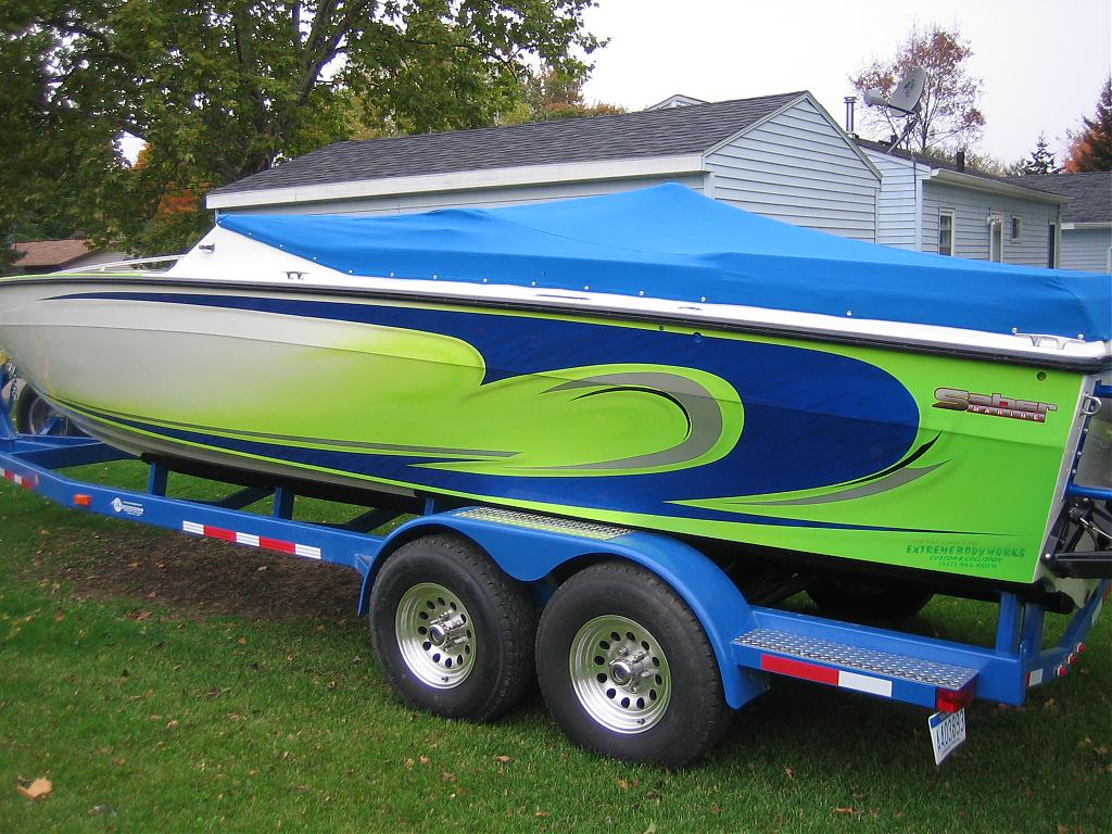

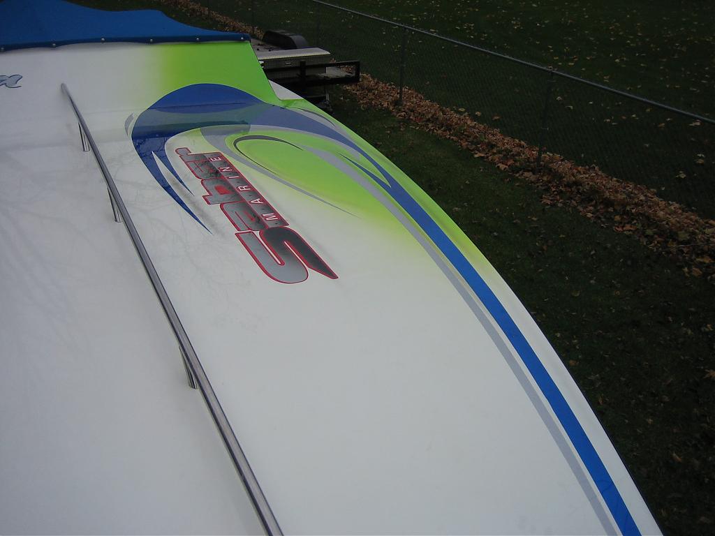

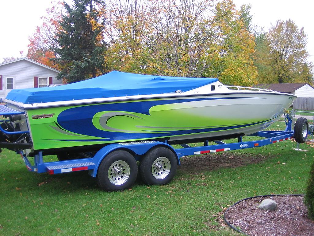

95 saber 28 offshore 502 just about complete with customizing even used the new logo in the paint scheme

Your boat looks great !! Have you ran it yet or is it new to you ?

i have owend the boat for almost 2 years put about 90 hours last year and enjoyed every minute of it thanks for the feedback very excited to show off the fresh paint work

Sweet graphics! Is that an extreme marine swim platform?

502 415hp 24pitch bravo 1 gps 61mph in about 8in of chop x demension not sure but i will ask doug tomorrow dry i was told the is 4800# can not belive it is that light but the info came from doug . i built the swimplatform myself, used my rollcage building skills from my sand drag racing days

I hope it is 4800# , They are balsa cored all over so that is poss. & if it came from doug I am shure it is right. What kind of rpms are you turning ?? I am really interested in the X-dim. I would love to see a good picture of the swim platform. Also did you do the paint yourself of did you have it done ? I am a painter by trade.

i will have to get on the other com. to get some full pics of the platform i have changed the design slightly on other ones i have built. i had my bud that painted the boat paint it house of kolors base imron clear, much easier and better covrage with powdercoat. 4700 rpms i think i need to adjust the throttle stop tried three different props includ. a3 blade 24 4700 is all it do

That is 14% prop slip. Please post the X-dim on here if you get it from Doug tommorow. Like I said your boat really looks great ! I look forward to seing some more pictures.

mcm, was your boat the one that was all white for sale a few yrs ago? i think it was in california at one time?
btw, it looks great... any interior shots?
