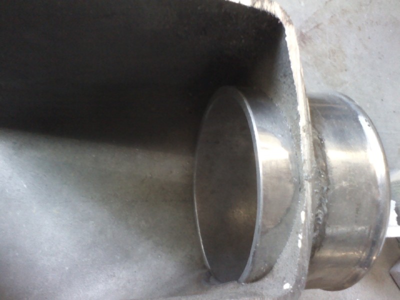

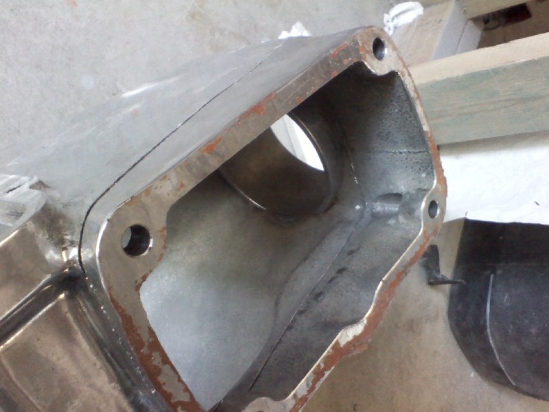

I also started hacking into my intercooler today for a few reasons.. One reason being best put in southern slang "that I can't leave well enough alone" Another being the fact that I have never completely liked the design being that they used the same cooler for the MPI engines as the carbed version so what they did was put a cheezy block off plate over the outlet of the cooler (inlet of MPI throttle body) Then cut a 3.5" hole in the end of it shove a piece of tubing a good 1/2-3/4" to far in to the hole & weld it up... Anyways as you can see by the photos as I was cutting that it was a pretty in-efficient design.. So leave it up to a redneck with some tools, experience using them and an imagination that won't quit and wallah !! I'm working on the plate to be welded to the side of it now.. This is the kind of work I love !! I also have to fab up some stringer brackets since it will be remote mounted instead of right in front & basically on top of the engine well in the way of allot of stuff that I didn't want it in the way of...
Here's a few "in process" shots after I made the first cut to give a better idea of what I'm talking about..

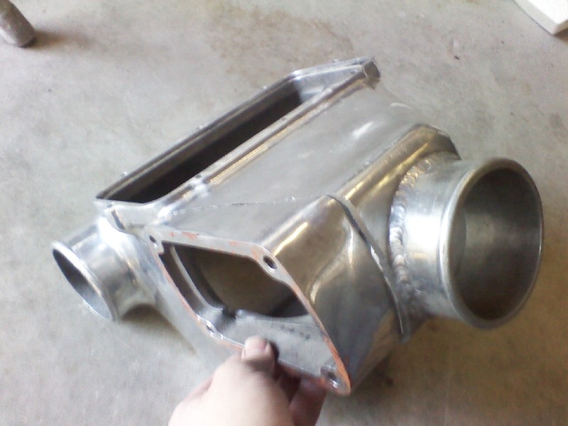

A few more after some more cutting, grinding & the first round of port work..
