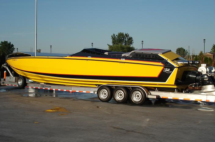

Ok its been a month!!!! Need an update!!
