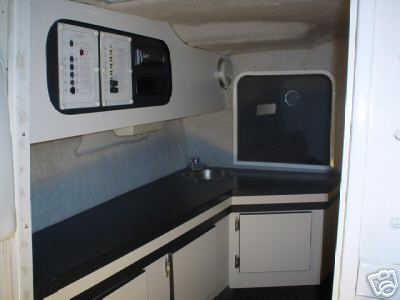

Look how mine was done. Carpeted over the teak, Cabinets were rebuilt in the cabin using corion, and paint everything else white.

PS. I added pic of boat in the water to keep you project guys motivated. March will be here soon.
