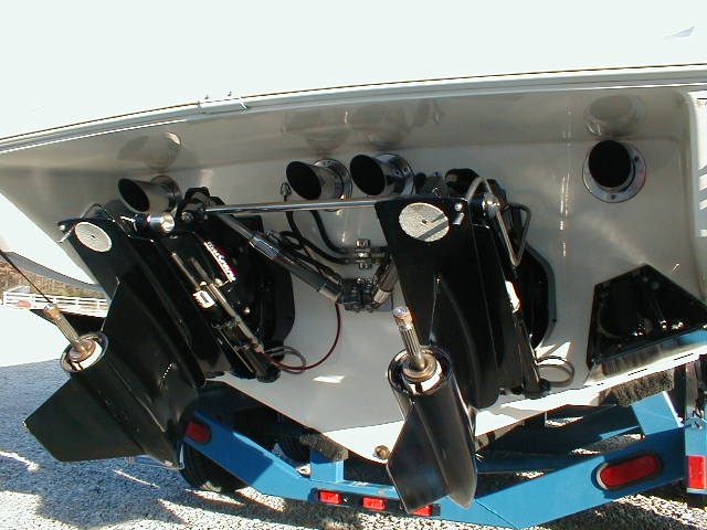

up and down
Attached Thumbnails Is this normal ?-trim-tabbs-001-medium-.jpg   Is this normal ?-trim-tabbs-002-medium-.jpg

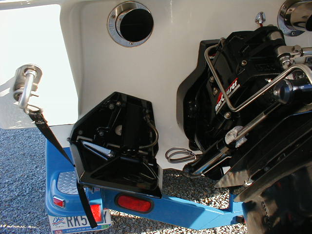

ok, here is a pic of my 29 with 280's on it, as you can see they are completely retracted.
tssteph is offline
Old 08-29-2006 | 02:05 PM
tssteph's Avatar
Joined: Oct 2002
Posts: 1,477
From: Cincinnati, Ohio
Default Re: Is this normal ?
In this pic from straight on from the back you can actually see the bottom of the tab, thats the reflection that you can see.
tssteph is offline
Old 08-29-2006 | 02:06 PM
tssteph's Avatar
Joined: Oct 2002
Posts: 1,477
Last one, you can see how far up they go when up.

Old 03-17-2007 | 12:24 PM
trc2's Avatar
scarab
Joined: Aug 2006
Posts: 315
From: Easton Maryland
Originally Posted by Frankscarab
I everone , i need to know if my trim tab measurement (inch travel ) are good or not.
There is a pic of my both trim tab at the higher position , like you can see i can't put in all the tab , i've still have 3 inch of travel between the tab and the cylinder.
Is it normal ?
Dont know if you fixed the problem yet but I have a 2000 29 scarab and my k planes had a spacer in them to keep the tab from going all the way up to keep the boat stayble
trc2 is offline
Old 03-18-2007 | 02:31 PM
scarabman's Avatar
Joined: Nov 2002
Posts: 2,038
Likes: 227
From: TR, NJ
Exactly!!! Remove them and you can bring the tabs further up and free up the bottom with less positive drive trim.
