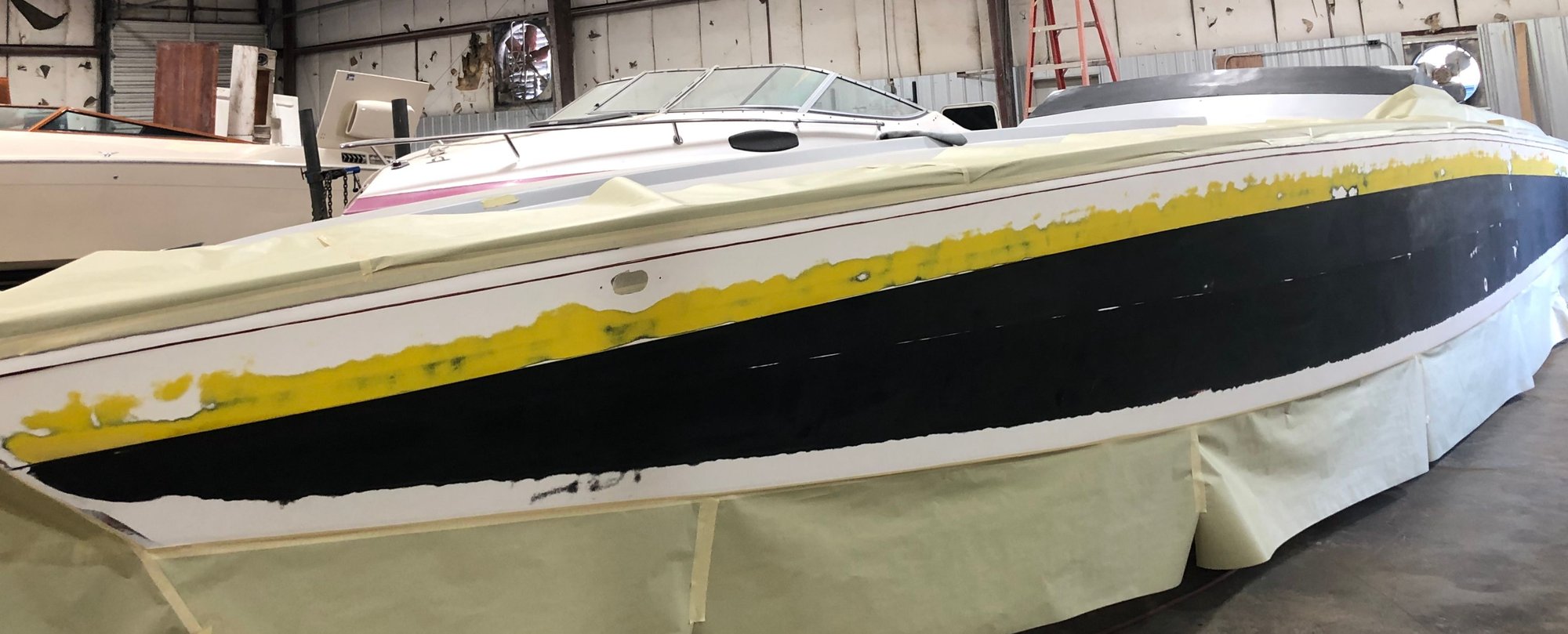

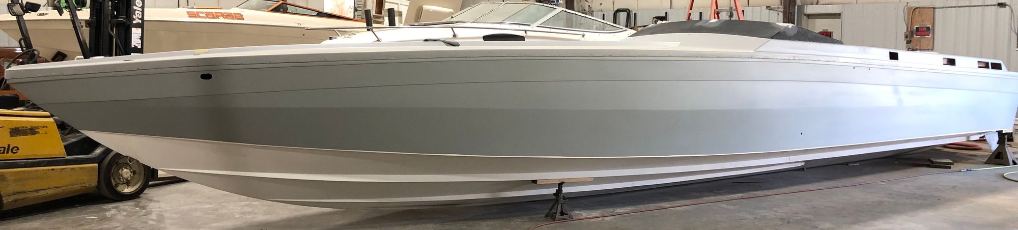

Surprisingly only took 3 hours to sand the port hull side today. We’ll spray it with slick sand when we spray the instrument panel. The starbd side is rougher, it will take more time.

Billy was caught up today so he put two coats of polyester on the port hull side. Haven’t sprayed the instrument panel or starboard hull side yet...

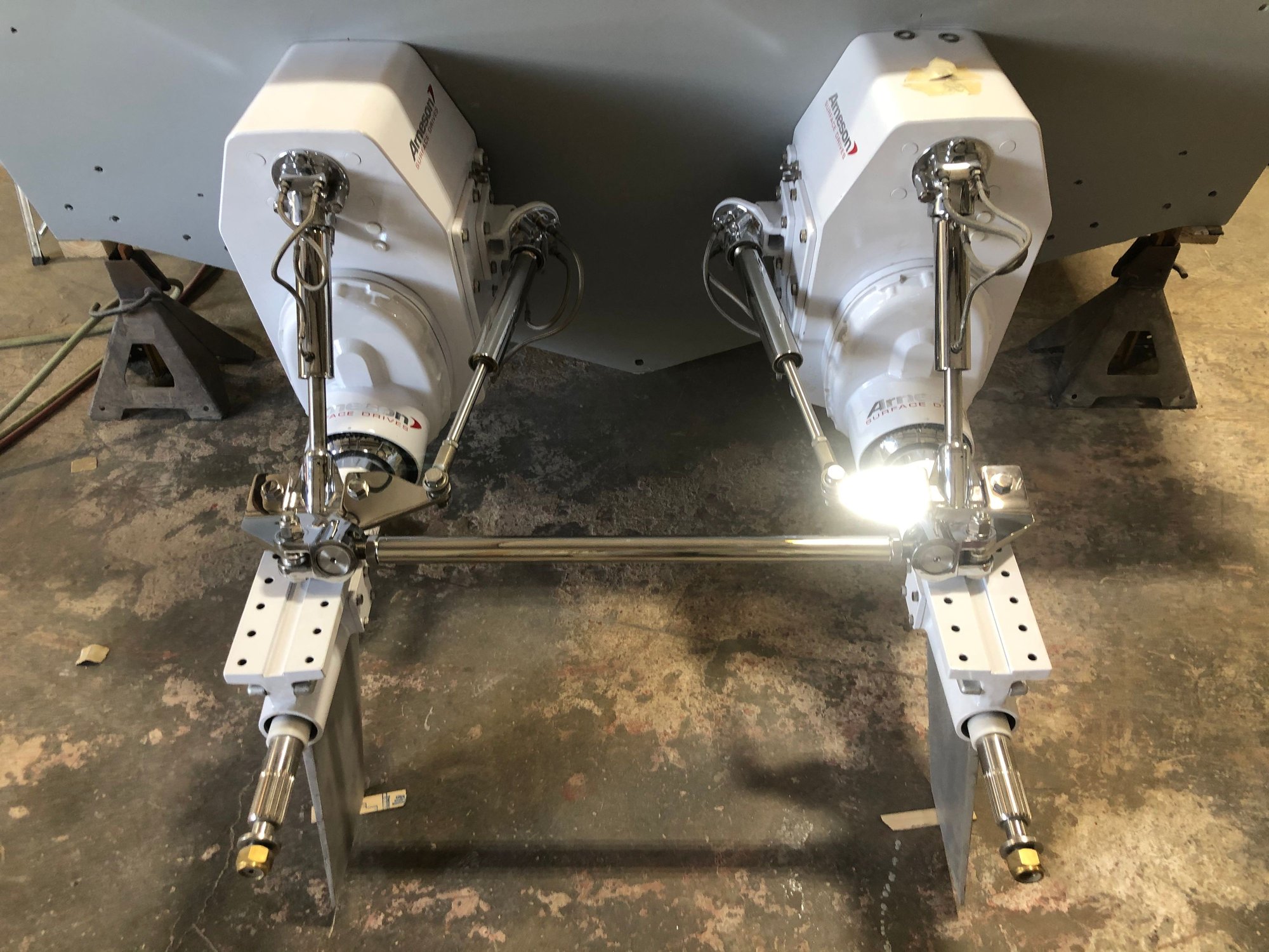

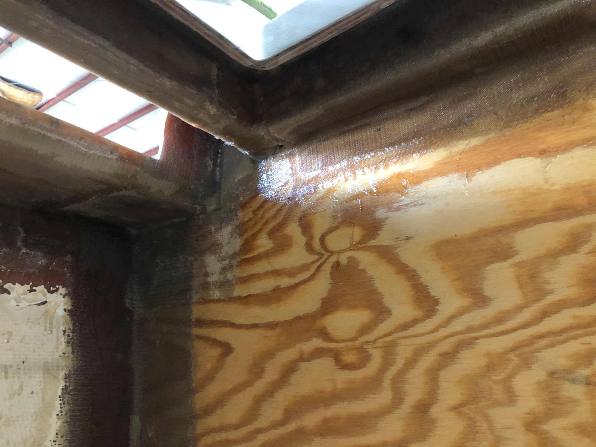

I got the rest of the engine compartment bulkhead glassed in place. Also hole sawed for the fuel lines for the engines. Rik sent me some studs, drivelines (double ujoints) and a highly polished tie bar for my drives. I’ve also got the instrument panel ready to prime.
