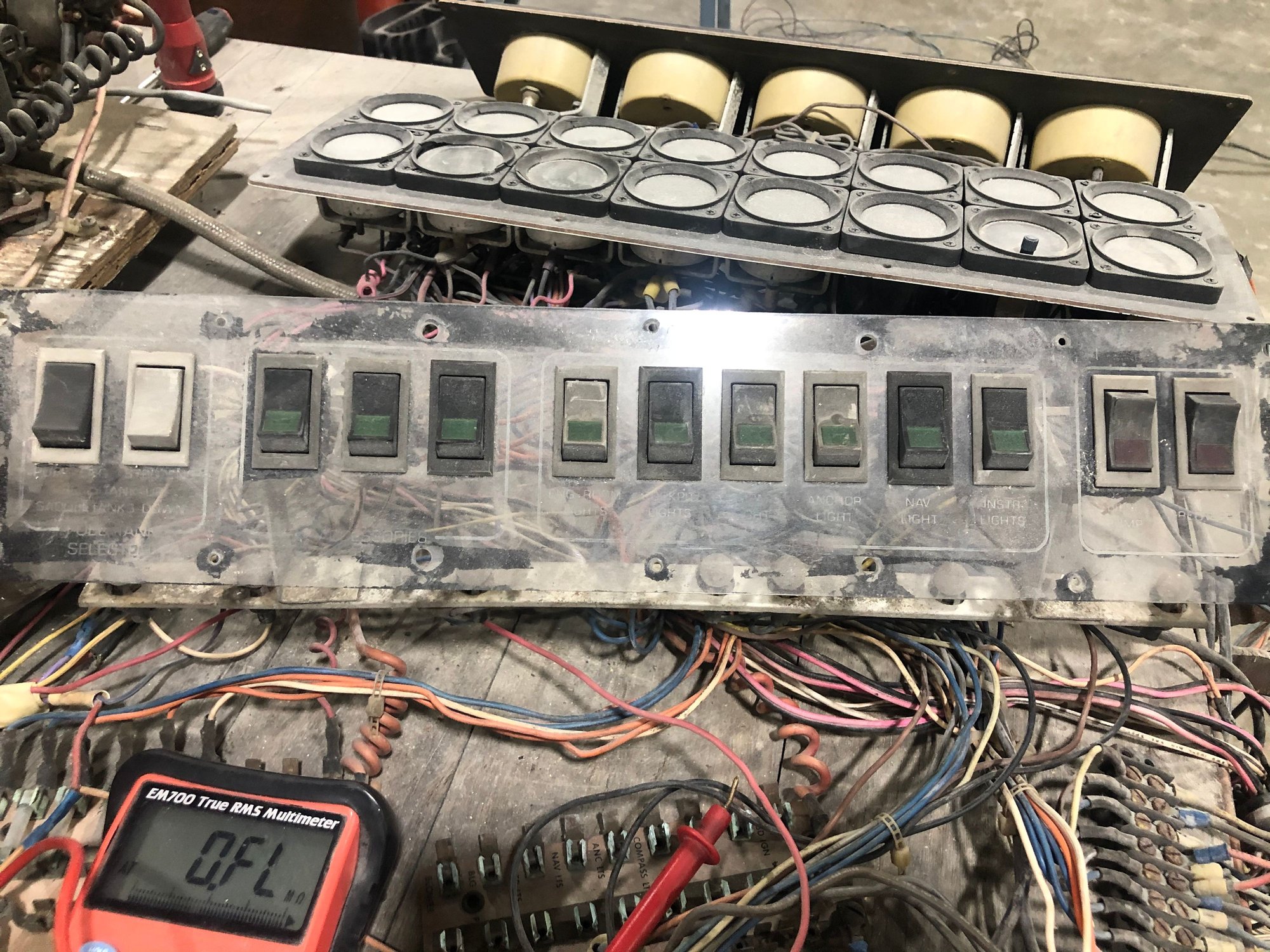

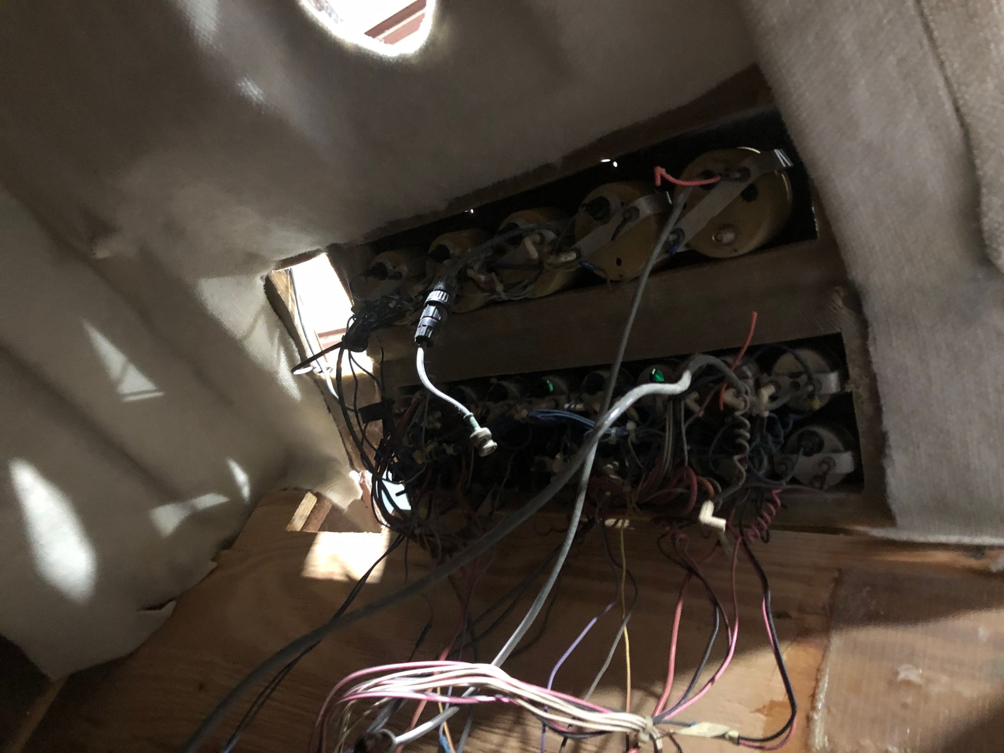

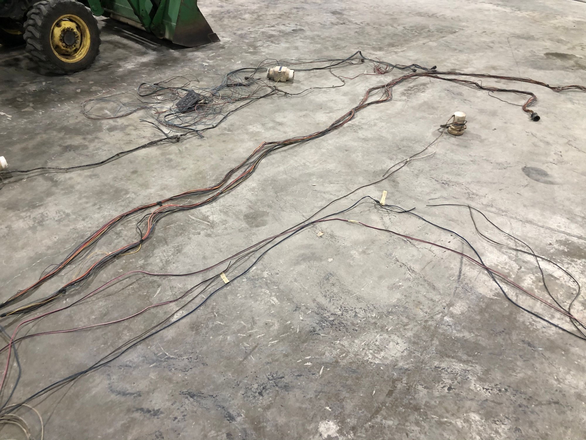

I’m in the process of laying out my wiring and figuring out what goes where. I was kind of dreading this but these old boat harnesses are simple and easy to figure out. I’m checking continuity on these toggles and they amazingly work but do look worn. Does anybody know a source to get these style of toggles?

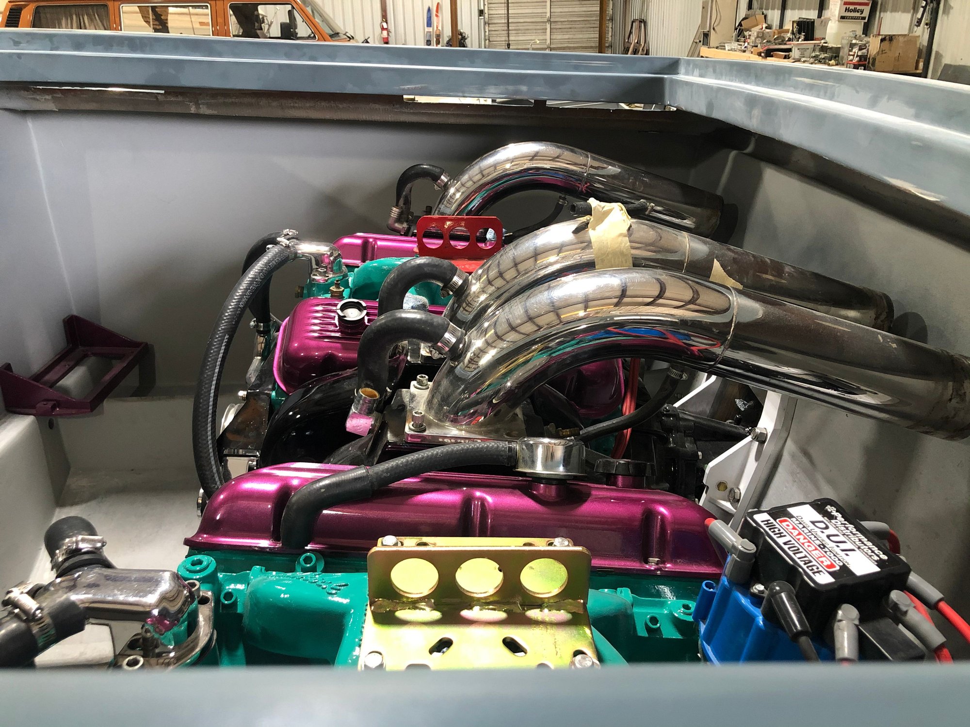

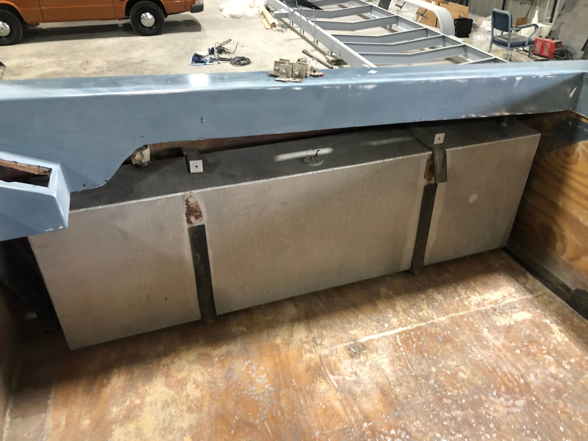

I’ve got my saddle tanks sitting in place figuring fuel hose routing. I think I’m going to put my electric fuel switches on the right upper part of the engine bulkhead. They will be new. Raw water pumps will be new also. I’ve got some sea strainers and some trim pumps coming used from Sick Stinger (Mike).

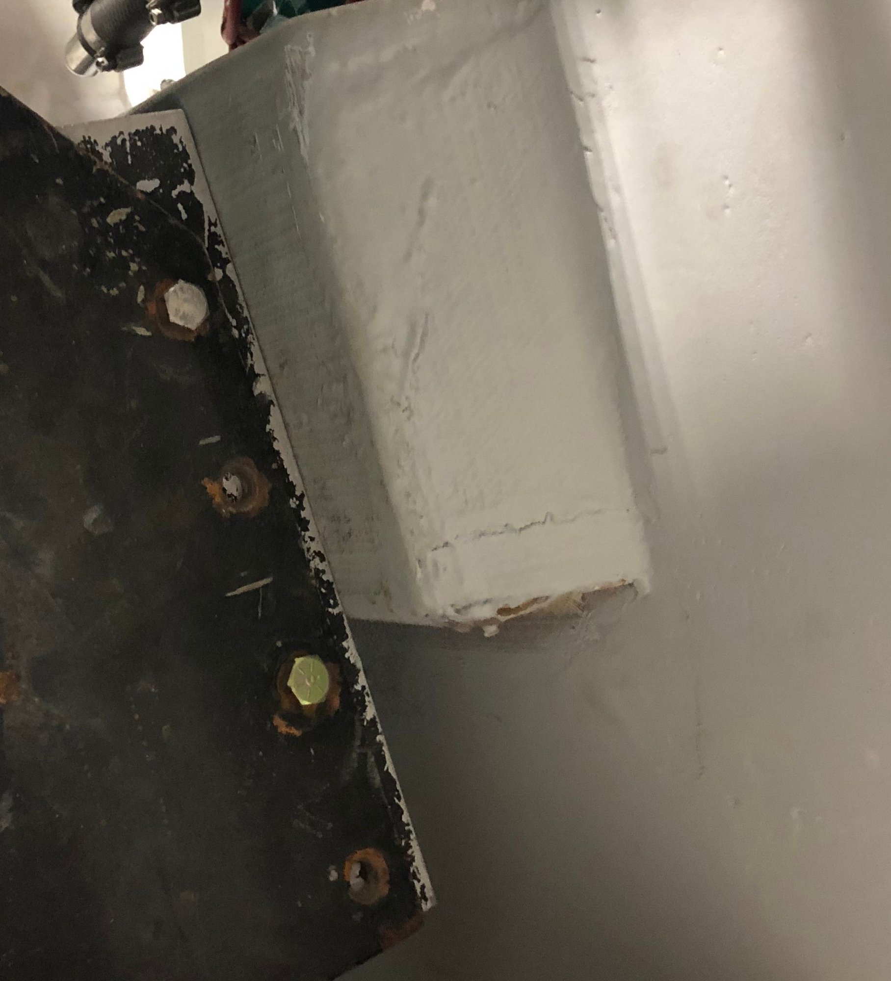

Also got the offshore mounts in place where they go. Still got to do drill the stringers when the motors are back out. It’s interesting how the motors are leaned back (Up in the front, down in the rear) with the Arneson setup. Much more so than a TRS setup.
I replaced all of mine with switches from painless wiring. They make them in red, blue, green.
https://www.painlessperformance.com/wc/p.php?s=roswp
I purchased them from summit racing.
https://www.summitracing.com/parts/prf-80401

There you go Patrick. Thanks for the link brother. I’ll get some of those coming.

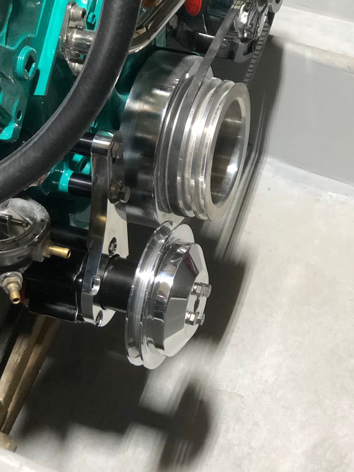

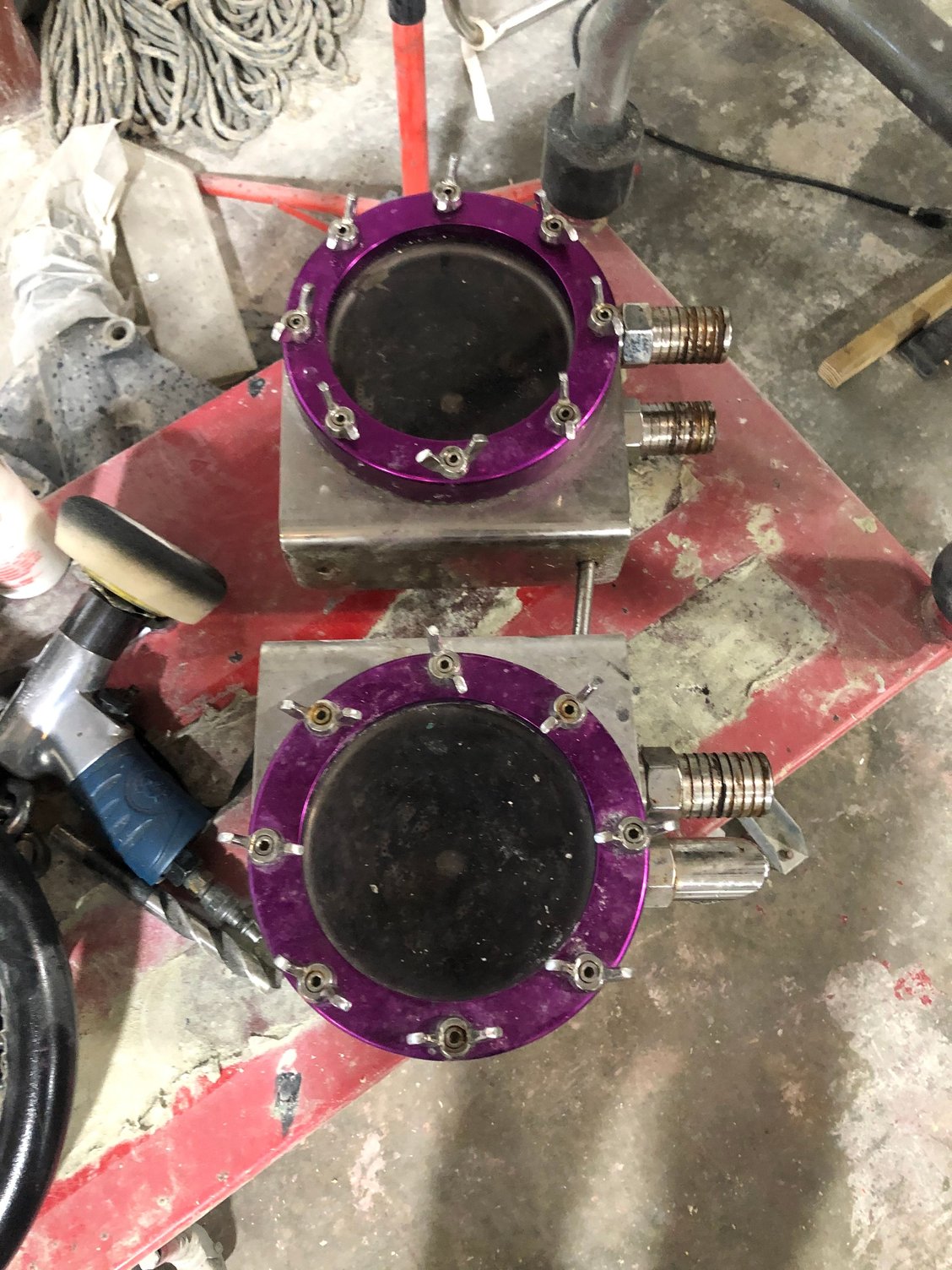

Talk about slow go, everything is taking forever to do. I got a good deal from sick stinger on some sea strainers and trim pumps. Also new sea pumps, pulleys and brackets.

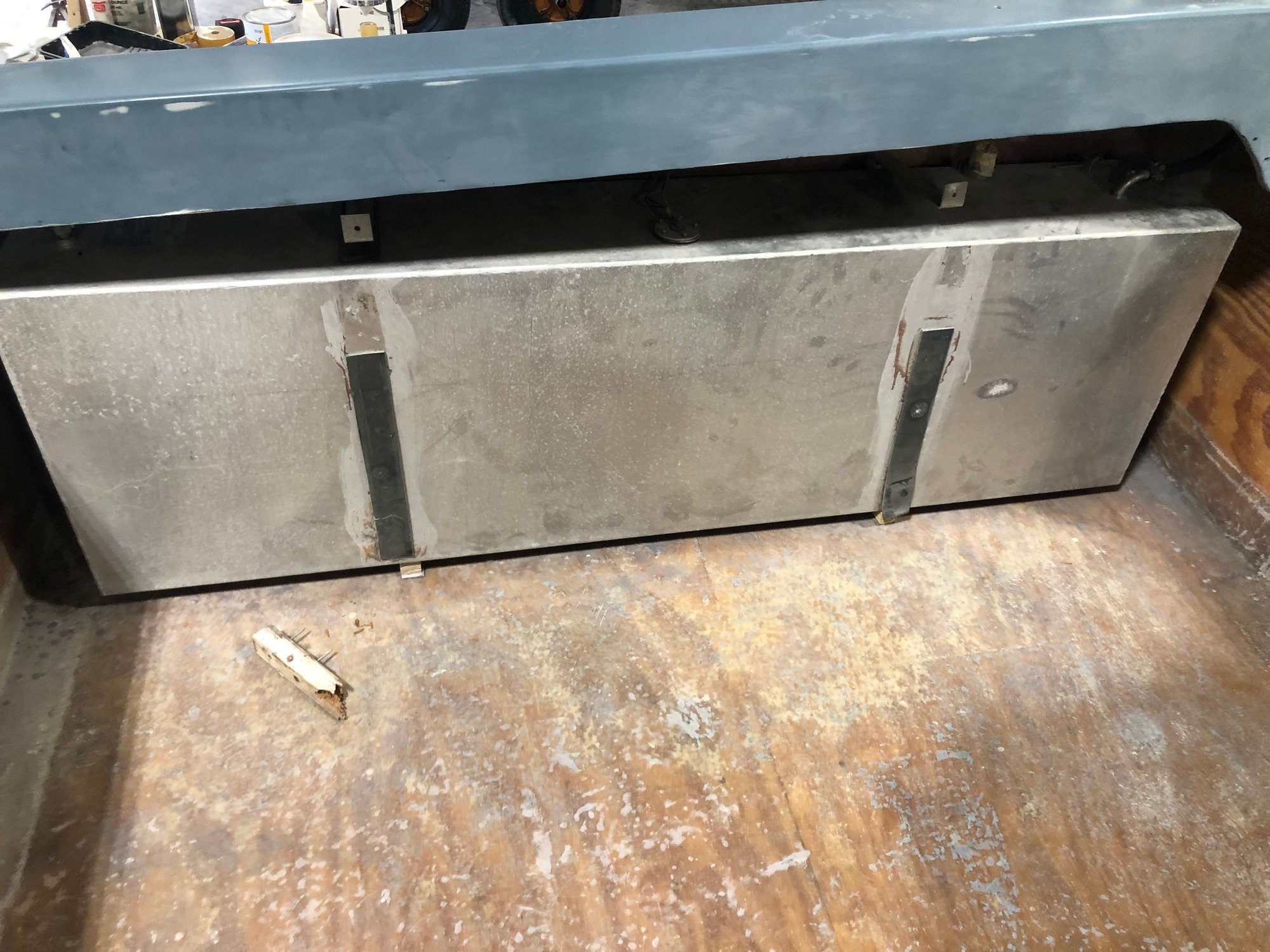

I got the sending units adjusted for my tanks and installed, and the port tank installed in the boat. I had to buy some aluminum straps to make that work.

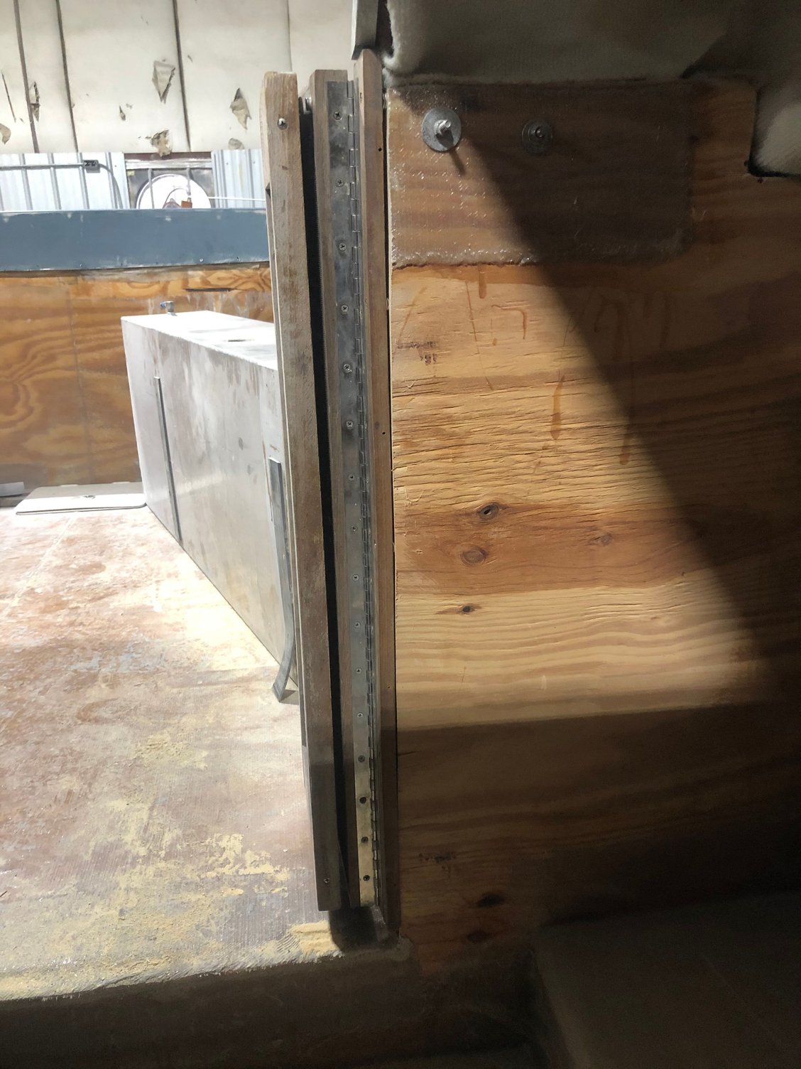

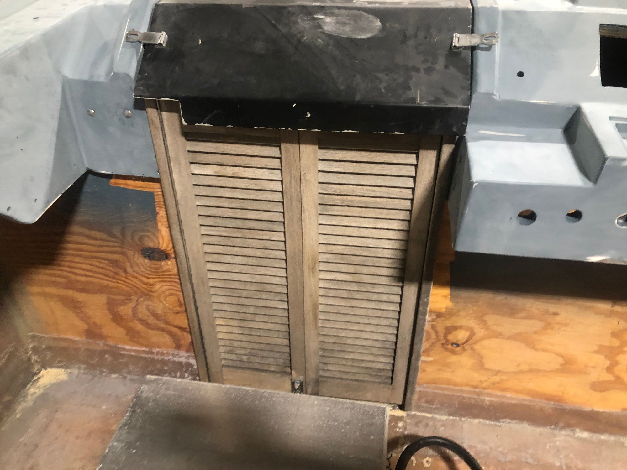

Also did a bunch of work to sturdy up and adjust the cabin door. The dowels were broken in it.

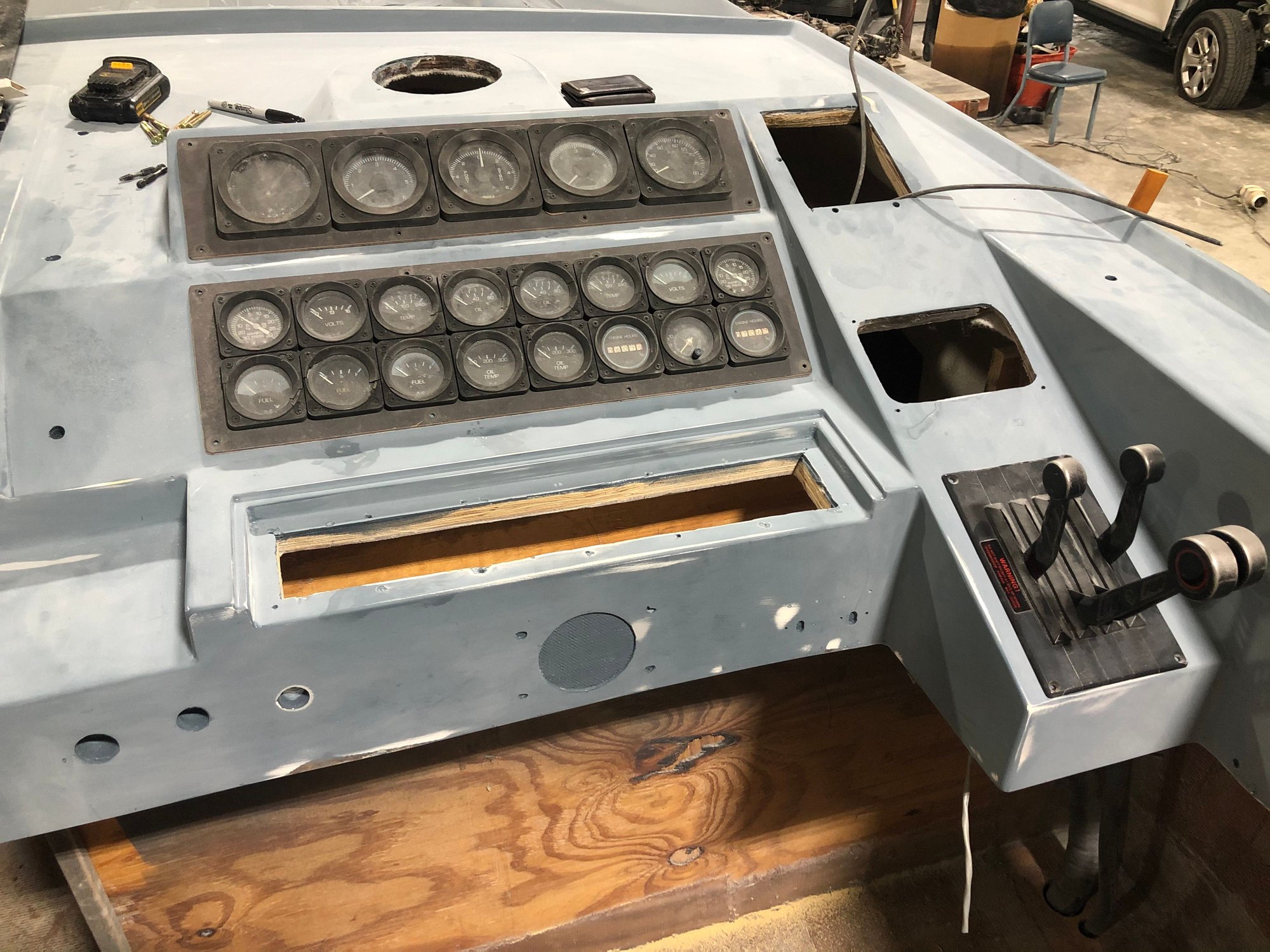

Also fitting the gauges and hole sawing the bulkheads for the wiring. I have some black auto meter gauges I’ll be using. I’m going to try to find a good small enough chart plotter to put in the 2 upper left gauge positions.
