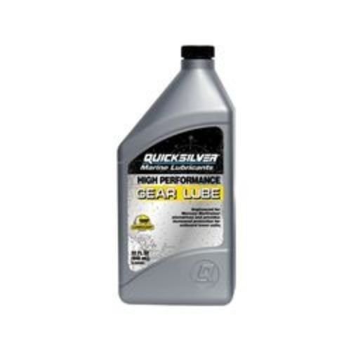

Mercruiser High Performance (not the Premium) Gear Lube. Alpha Drives only need 2 quarts. Can be found at most NAPA's and Walmart's.
