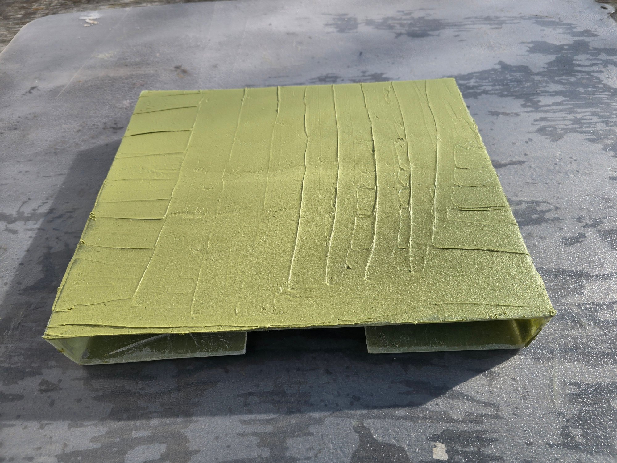

applied epoxy filer by TotalBoat

sanded down

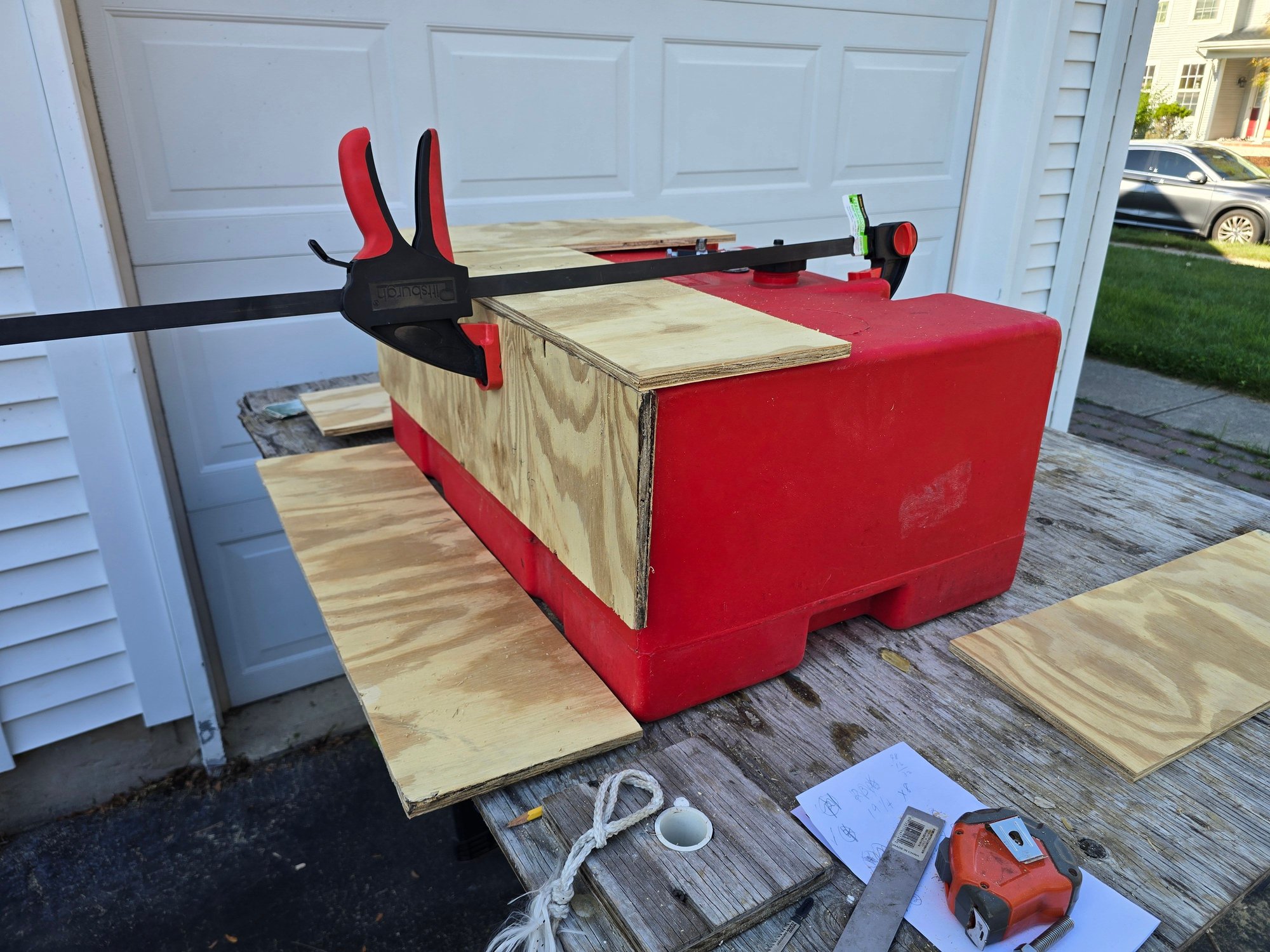

building a proper fuel tank bracket. the wooden mold will be a one-off throw-away mold. There will be two pieces of identical wooden mold to compress and shape the fiberglass bracket.

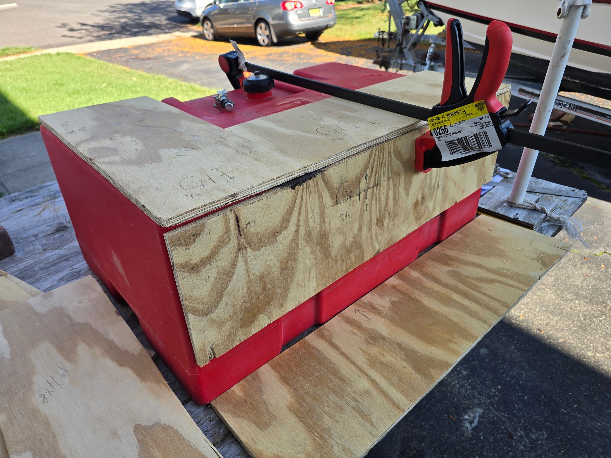

completed wood mold. will be attached to port hull-side and bilge fire wall

laid up epoxy resin with slow hardener. place wet glass in the mold and compress the 2 pieces wooden mold to capture the shape
