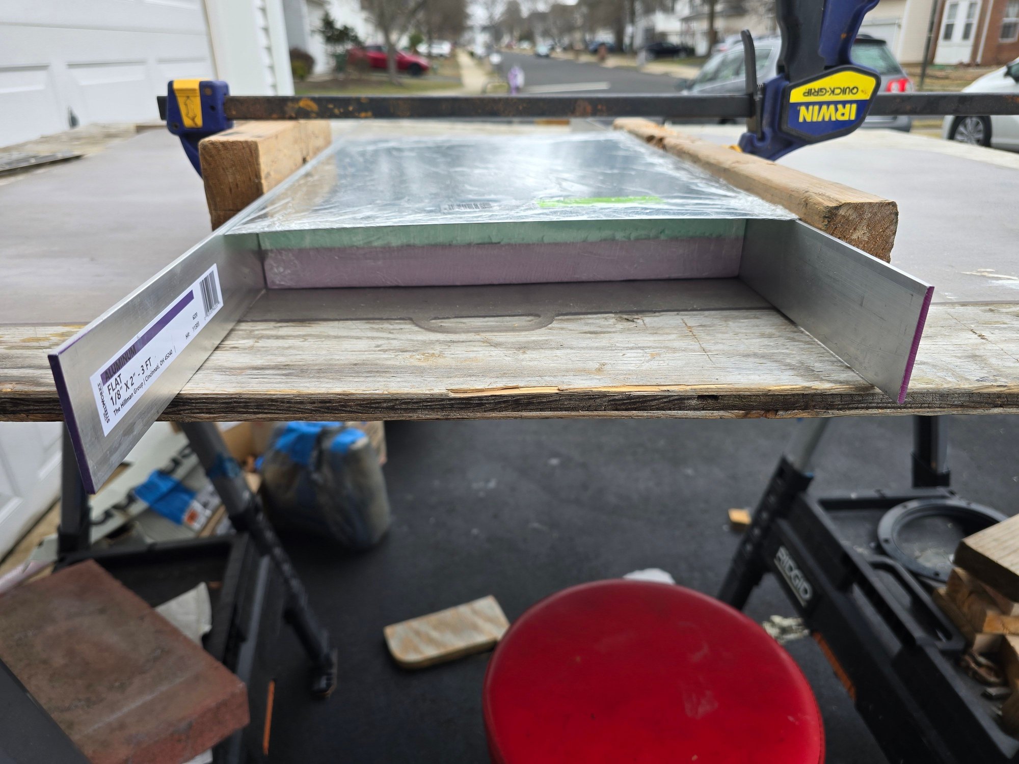

location of electrical plate

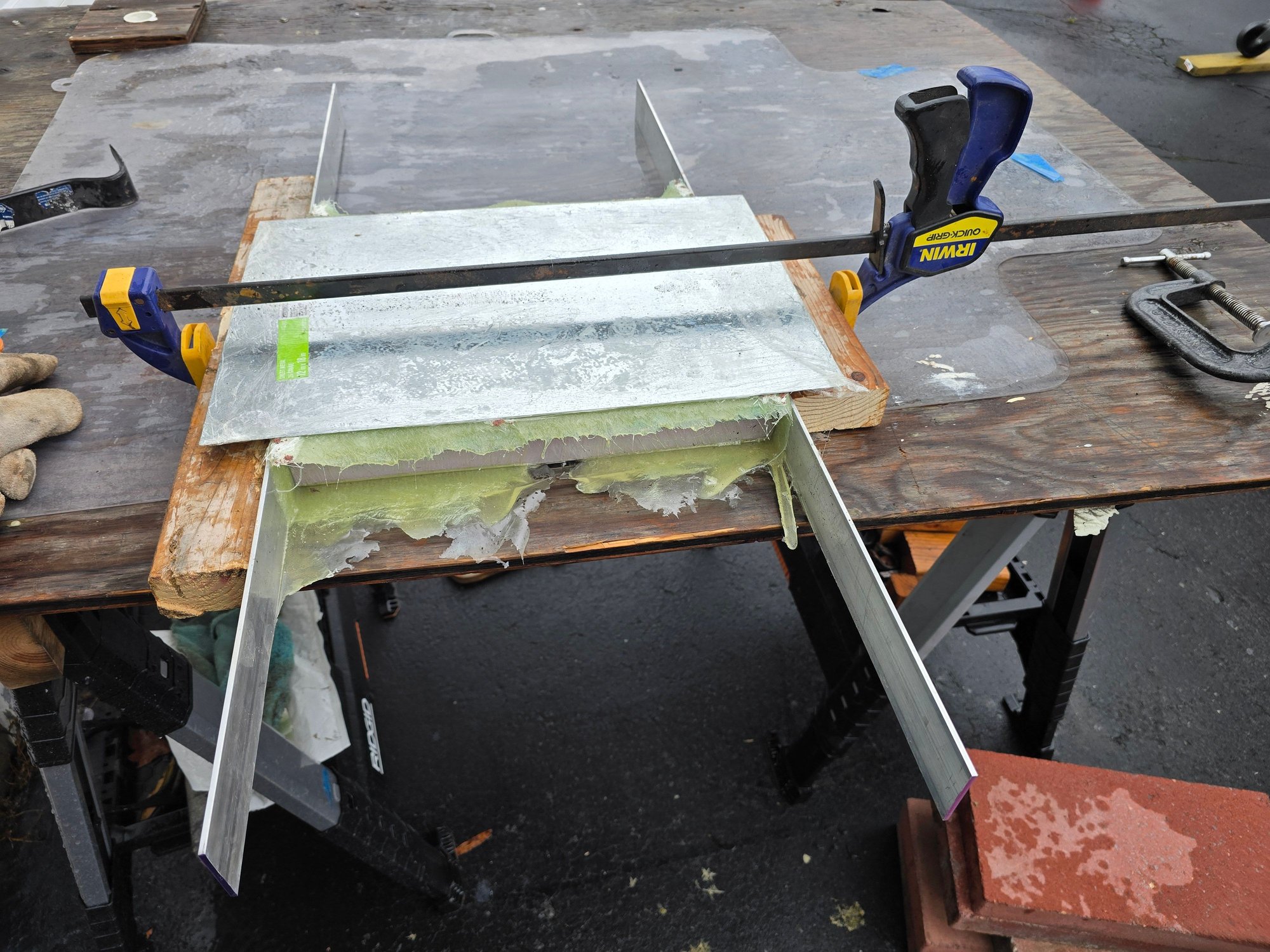

I want to compress the wet glass so that it creates sharp right-angles
practice compressing
noli is offline
Old 03-27-2025 | 01:35 PM
  #83
Joined: Jan 2008
Posts: 5,221
Likes: 620
From: Jersey Shore

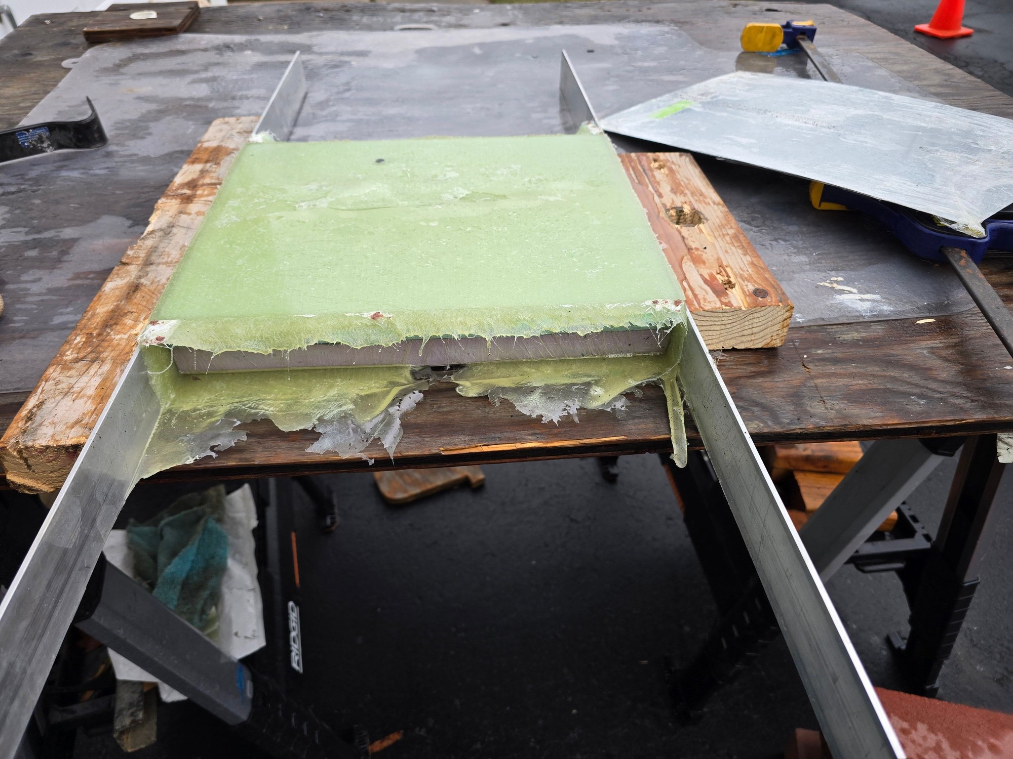

fiberglass is wet, compression is set
noli is offline
Old 03-27-2025 | 01:36 PM
  #84
Joined: Jan 2008
Posts: 5,221
Likes: 620
From: Jersey Shore
remove all compression metal parts
noli is offline

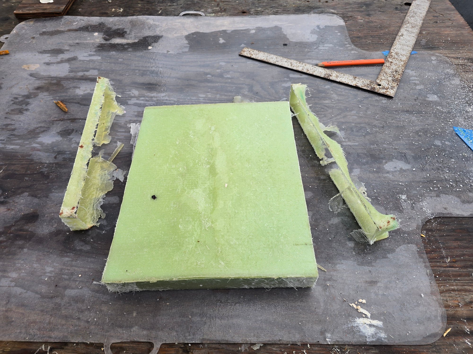

cut off the sharp edges
noli is offline

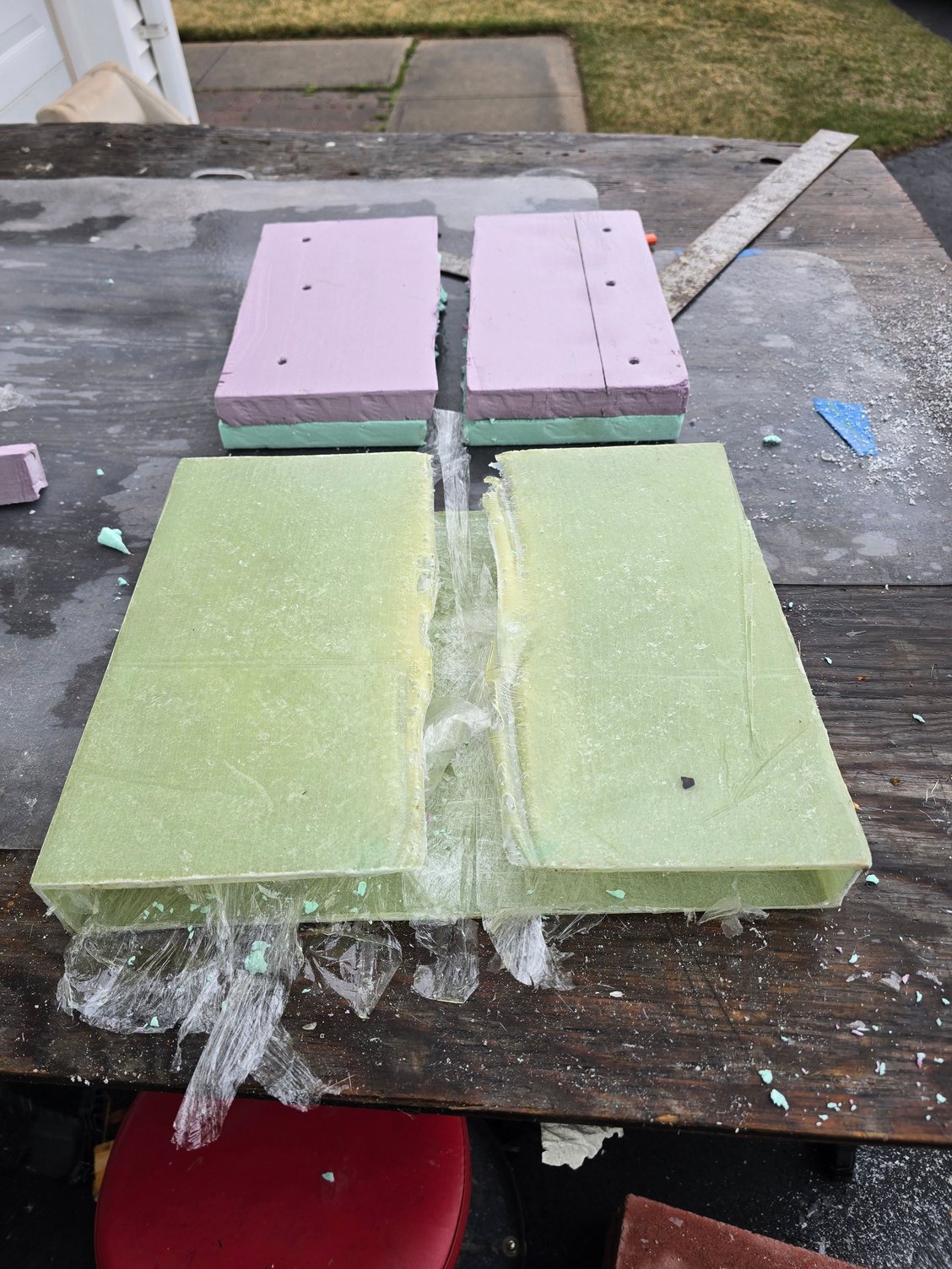

remove the mold
btw, I wrapped the mold with clear food wrap so the mold doesnt stick to wet fiberglass

cut off the rear-part sharp edges

finished part, ready for painting white

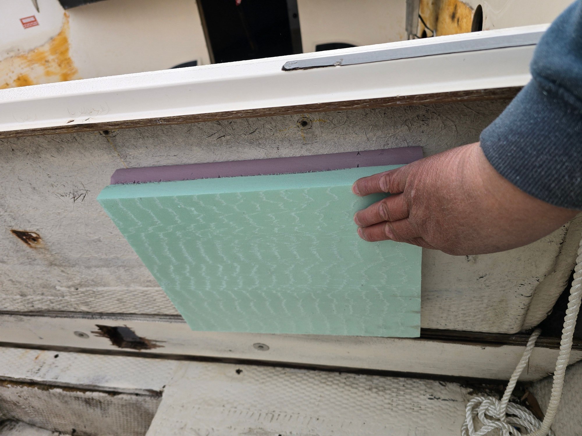

Very nice work!
Out of curiosity, why not use something similar to starboard?

starboard would be a better choice, I just have a lot of 1708 sitting around and want to glass-in the part to the fiberglass-bench-back
