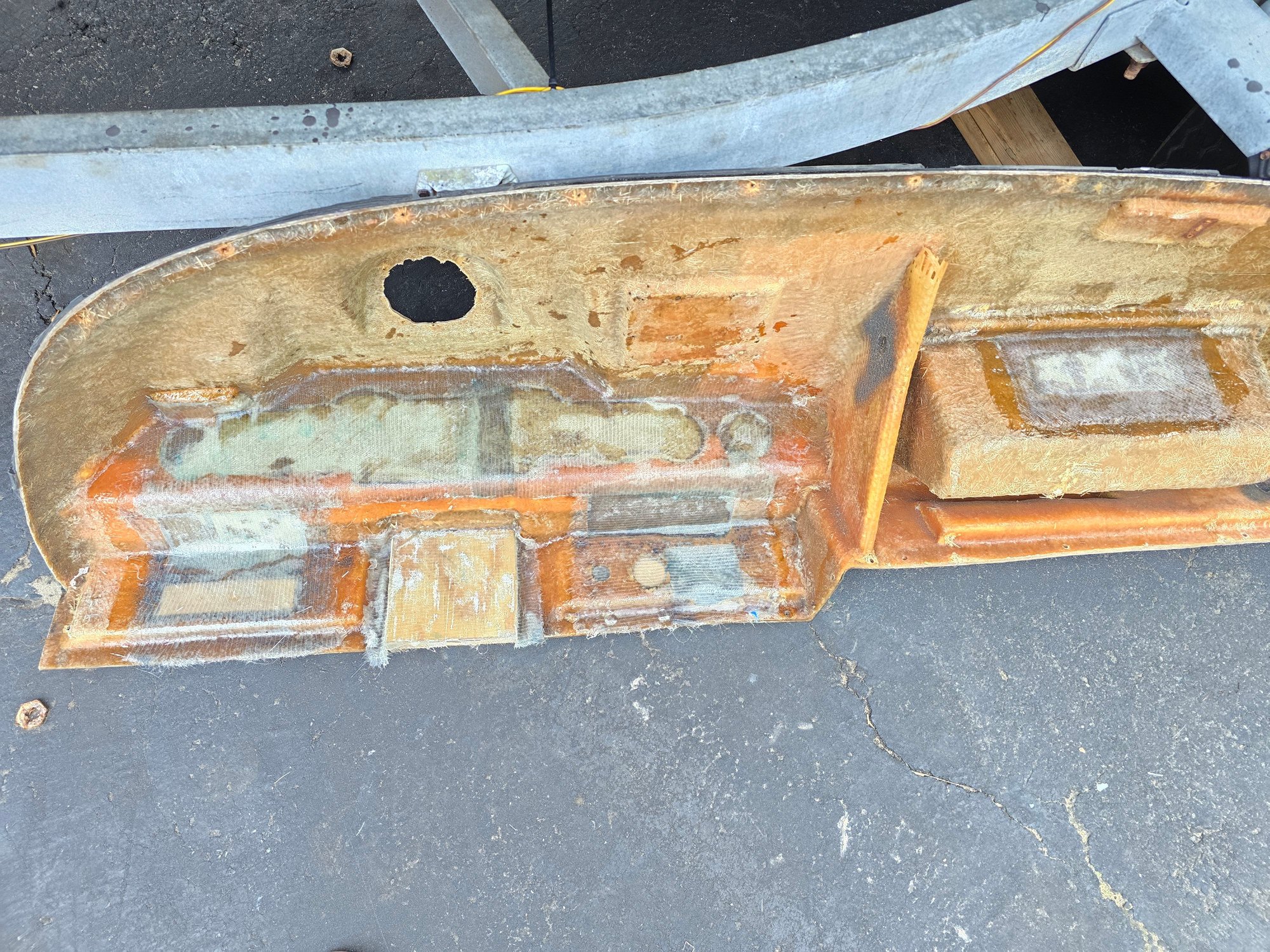

starting work on the dash.
in its raw form
noli is offline

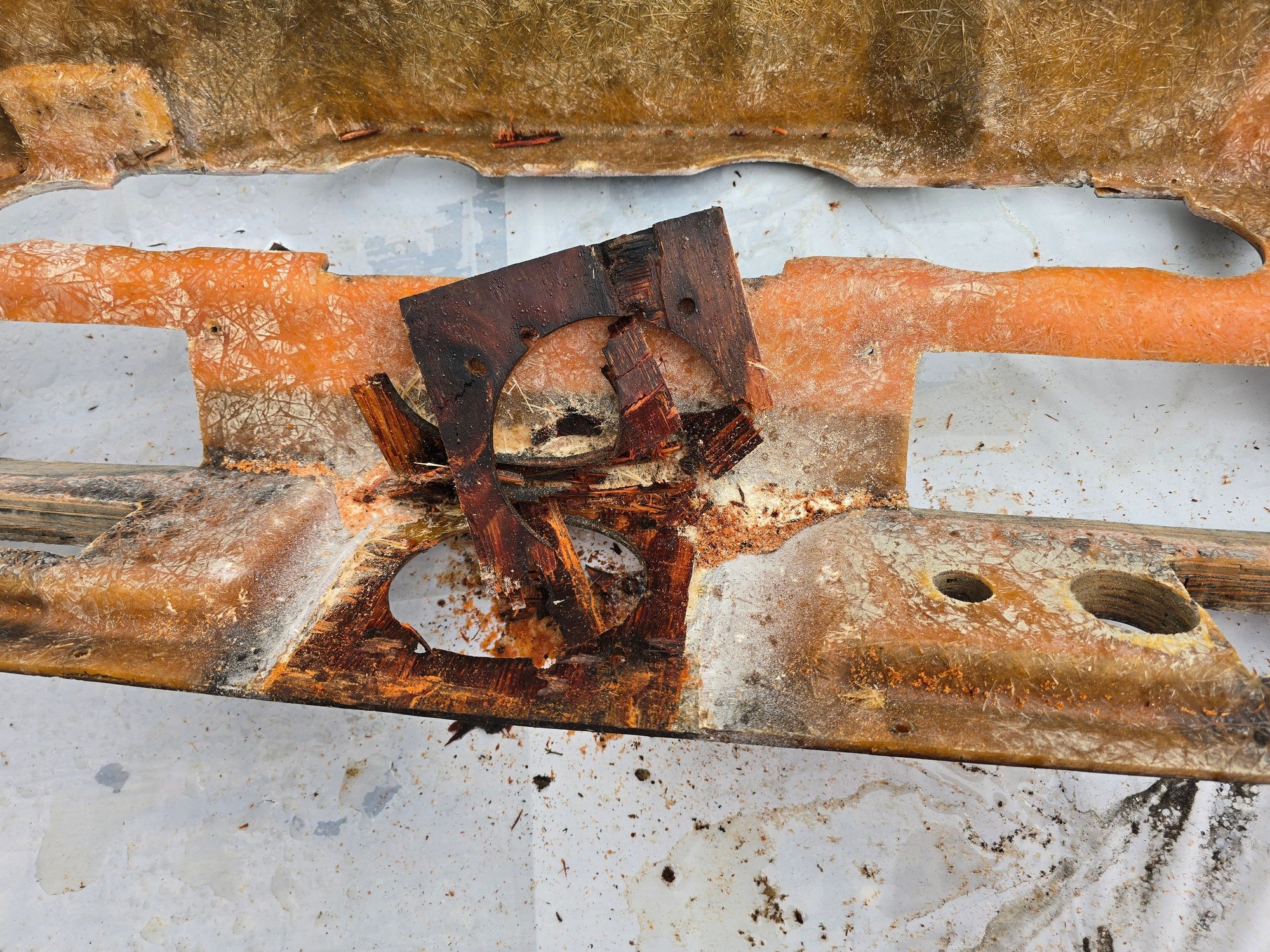

fitting the core
noli is offline

replace wood core which was soaked in hydraulic fluid

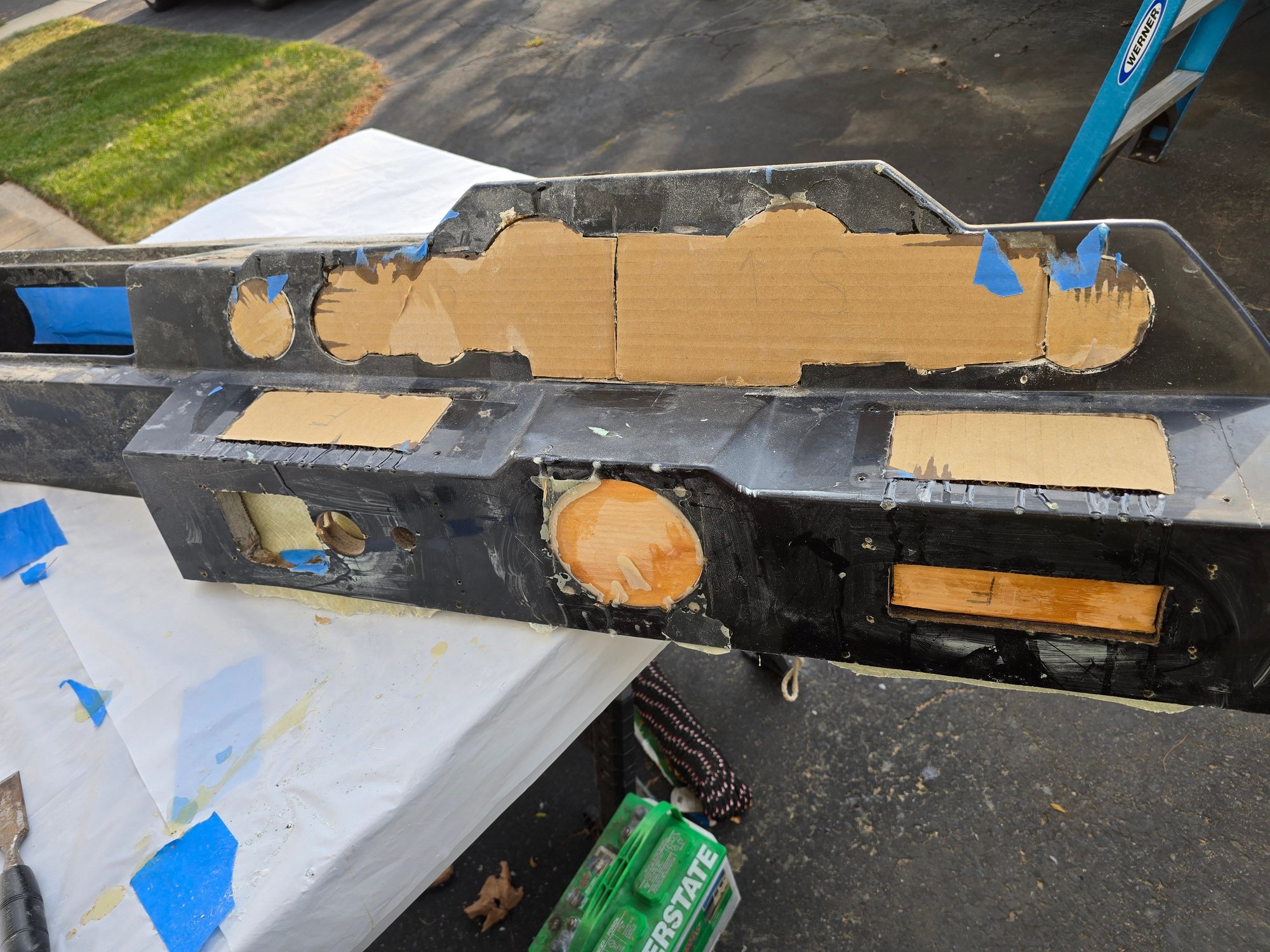

tape on cardboard to prevent fiberglass backing to not sag while it's curing

fiberglass laid in the back of dash using epoxy resin
