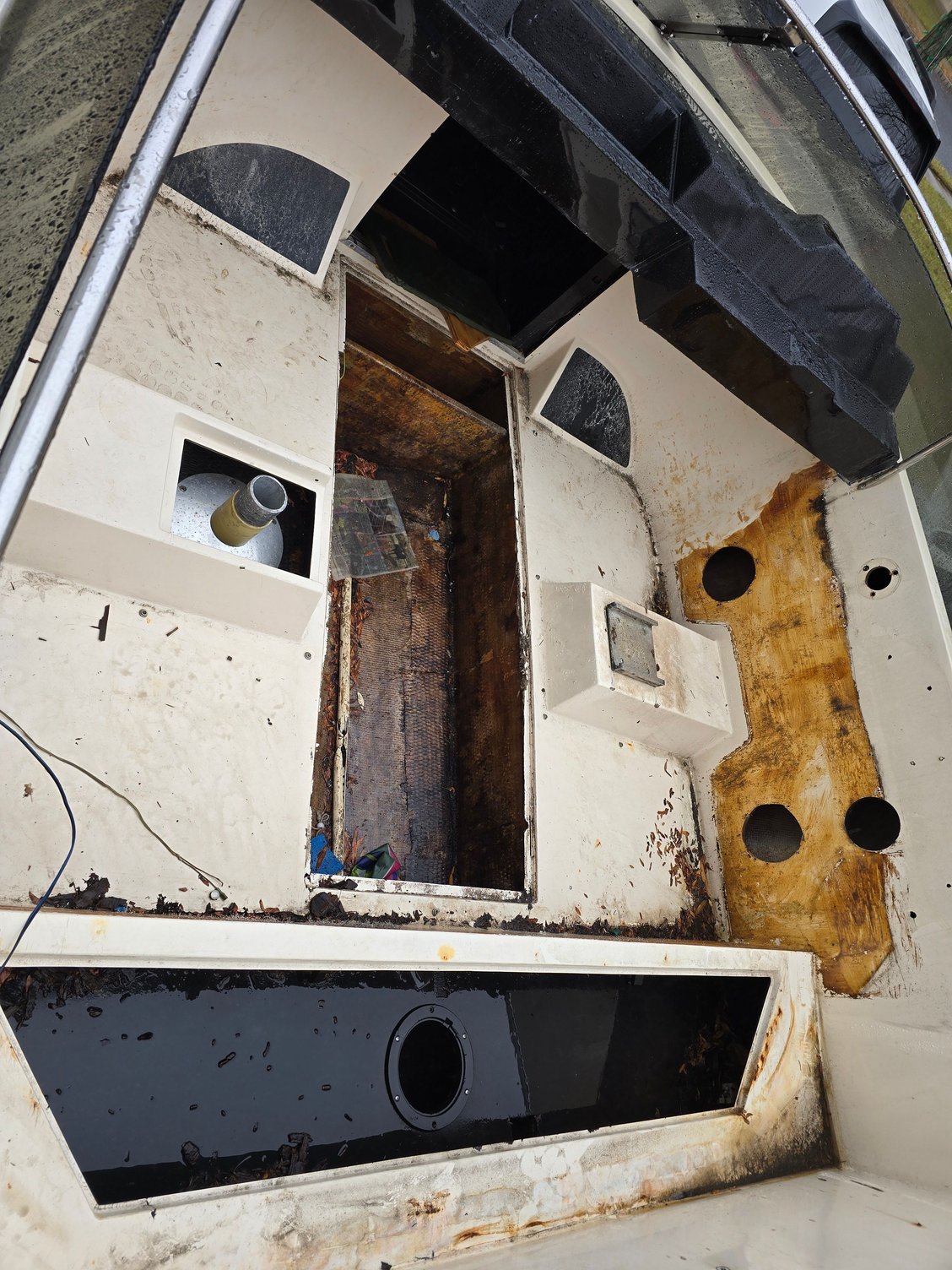

all of the dash holes are now closed from using fiberglass with epoxy

fill holes with 1/8 inch thick plywood as core and epoxy the core to the fiberglass backing
this is where I transition from epoxy resin to polyester resin. I use the wood core as the transition element

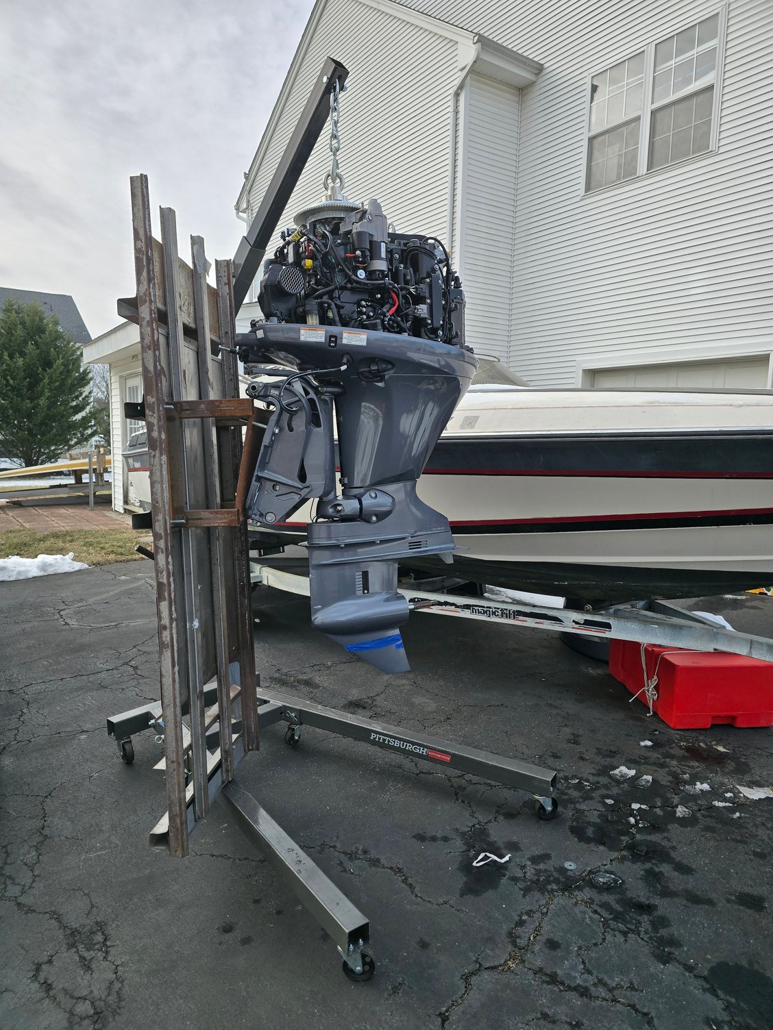

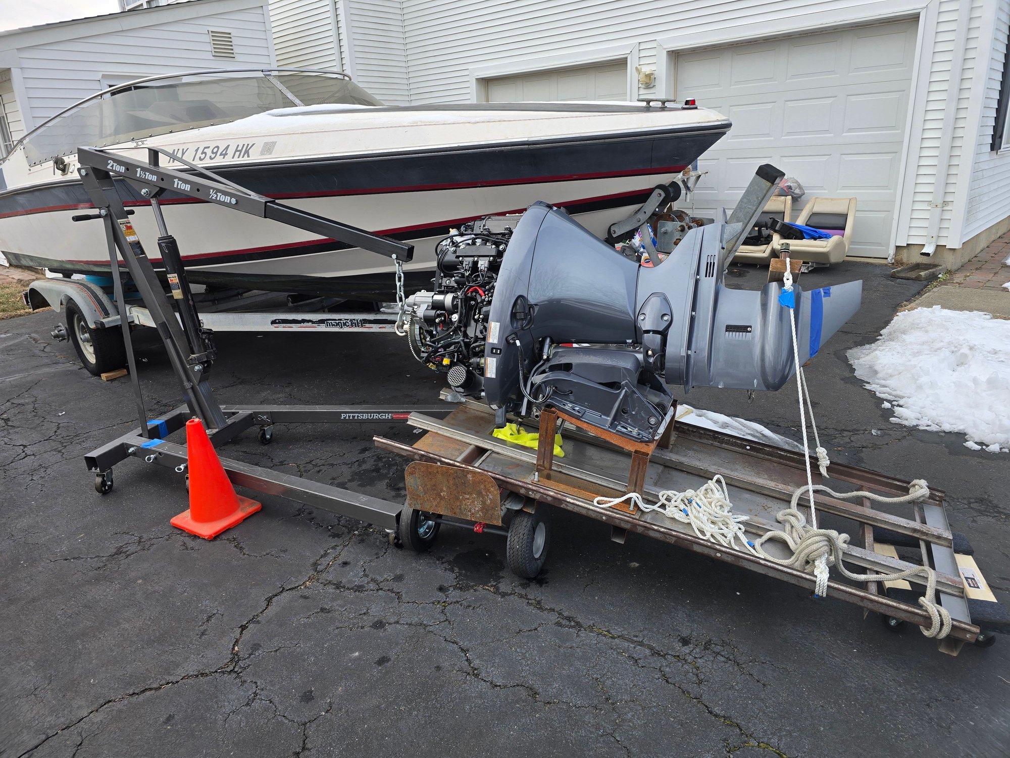

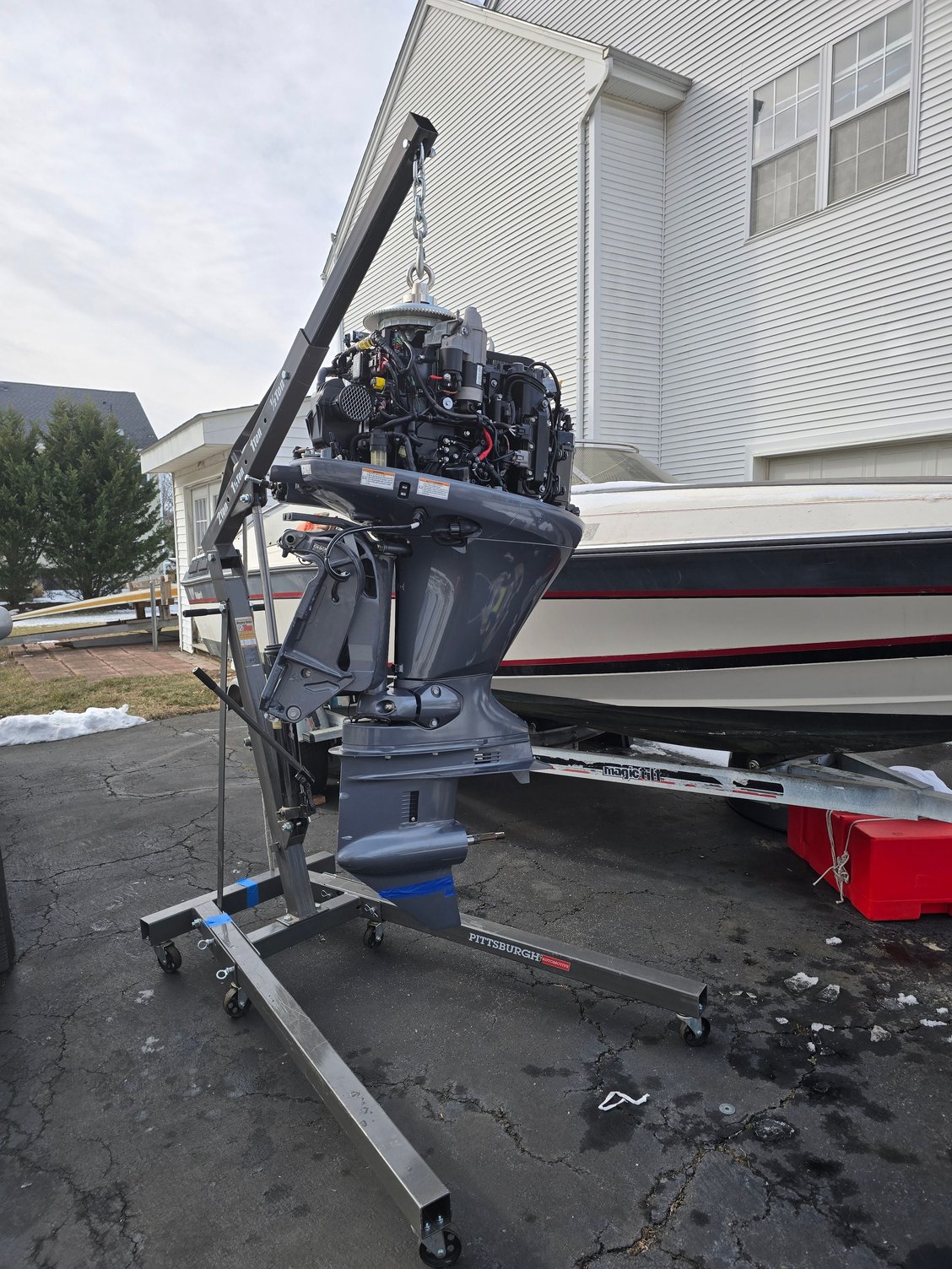

If I don't work through the winter, I won't be boating by spring. ..
yamaha 90 HP installation , won't be a fast boat, but will be a cruiser...to the Bahamas...its all i got to play with right now
