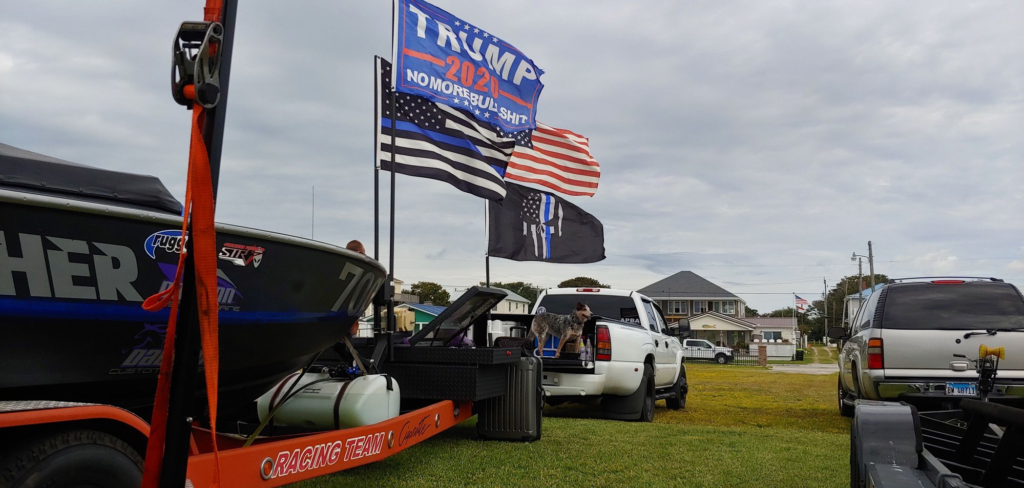

Went to Northern Tool and picked up the Tank. Cut a 1/4 inch plate and mounted it on the tank for vibration purposes. Then mounted the pump on top of that. Ran electric to a On/Off toggle to the Port side in front of tailgate. Stbd side, 75 ft of reinforced nylon hose with garden hose sprayer. Fill hose same side.
