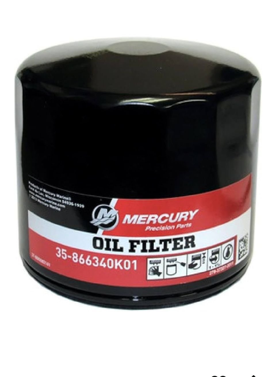

This little dinky dork filter just ain’t doing it for me…
There has to be a better option…

The worst part of it is not being able to pre-fill the oil filter before firing it up on an oil change.
Adding a larger can double the size...will mean double the time to fill and get oil to the bearings and lifters etc.
Just plug in your part number into a cross reference. Determine what the specs are. Thread size, anti-drainback etc.
Cut apart review:
https://bobistheoilguy.com/forums/th...340k01.310100/
Here you go:
https://www.oilfilter-crossreference...SIERRA/18-7876
Confirm your selection, don't take our word for it.

Been a GM guy I have always used AC delco PF 1218

As he said above or Wix 51060.
Thats the Wix cross reference for the AC.

I don't pay particular attention to height of a filter. I pay attention to the micron rating. This filter has a micron rating of 25, or .001". Sierra 18-7824, which is a small can also has a micron rating of 20, or .0008" and that's what I run. The wix mentioned above also has a micron rating of 20.
