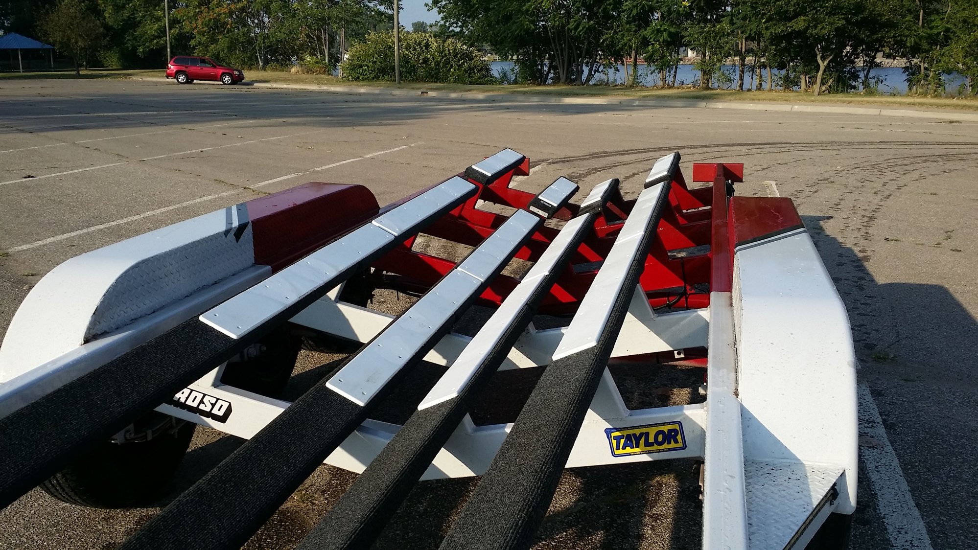

They protect the bunks and work nice.
I had to take a few off because the boat would slide around on the trailer.

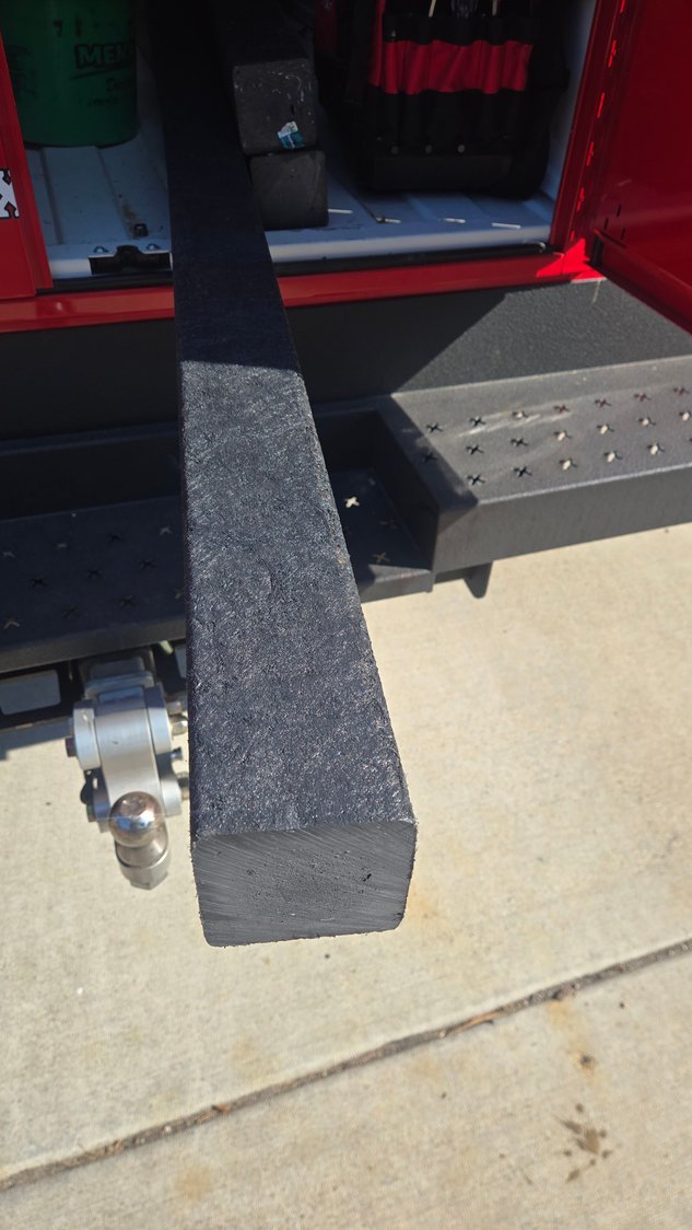

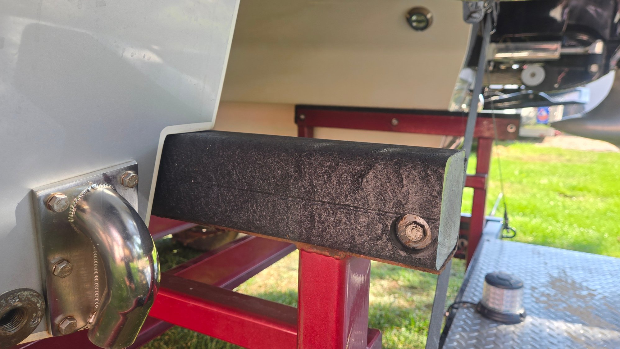

On Bad Kitty I used PVC 4x4`s , no carpet or sliders needed, will never rot.
honestly I have seen a 4x4 pvc log...
those are interesting
I have some 1x6 x4 feet tech decking planks i could cut to size

I use the sliders on my SeaDoos' trailer but would never consider it for a boat trailer...carpet only for me. IMHO the "cushioning effect" of the carpet is worth it's weight in gold, and protection of the gelcoat would be non-existent, even perhaps DAMAGING, using sliders under a heavy boat.

I had a heavy 1985 Cig on that trailer that I towed all over the country for 12 years and I guarantee you there was no damage to the gel coat.
Ive had way more damage from ripped carpet exposing rotted wood and junk getting tangled in the carpet. The slides protect the bottom
What cushining does a carpet provide? The wood still flexes.
