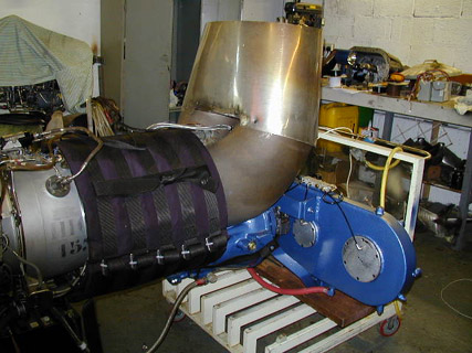

The engine I used had a pick up on the free power turbine shaft before any reduction took place in the gearbox. You should be able to use the n2 tacho output.
