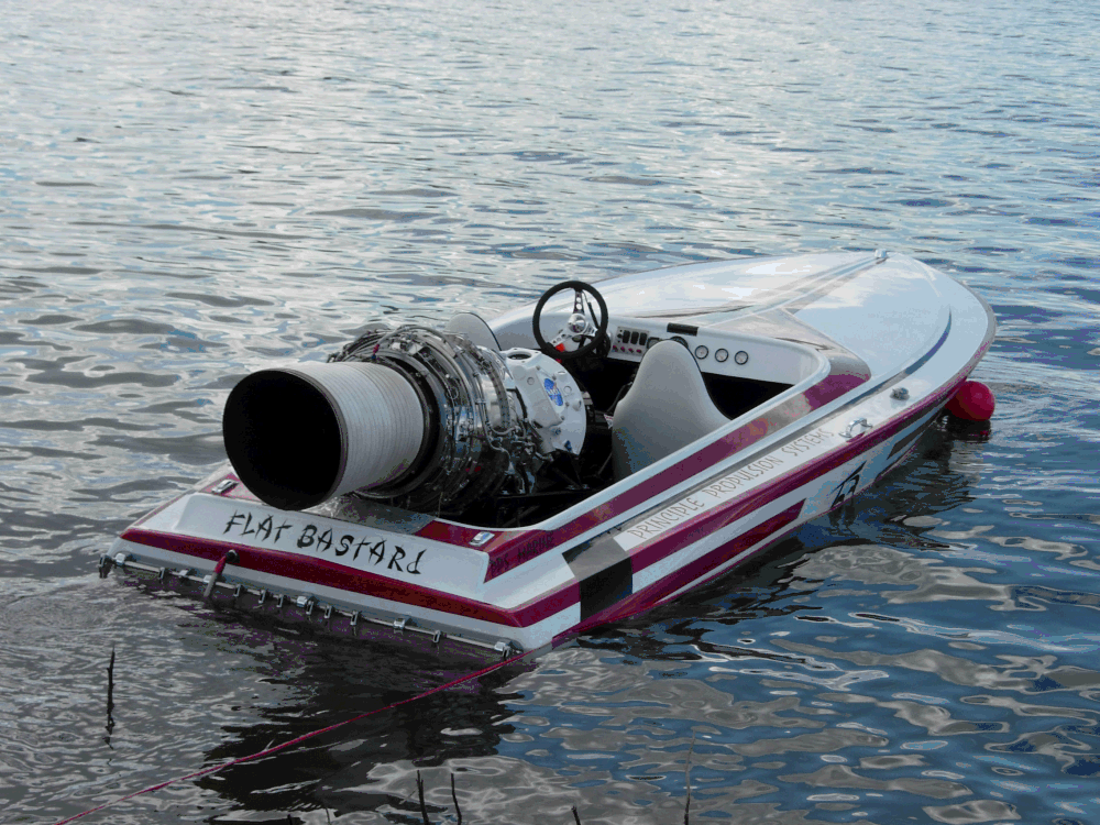

Default FLAT BASTARD up close
JAMESP7453 is offline

Thumbs up ? > drive
Originally Posted by JAMESP7453
a little JAMES , could I ask ? what type of v-drive are u-running in the__ "FLAT BASTARD" thanks, Jay ps PPS trying to find an old co. that produced gear sets, think the name was Casselle or Cassalle (spelling /?) any help greatly appreciate ! Sweet firery hot night time photo shot too !

Joined: Jun 2007
Posts: 44
casale is very much in business. Gear sets should be no problem.
