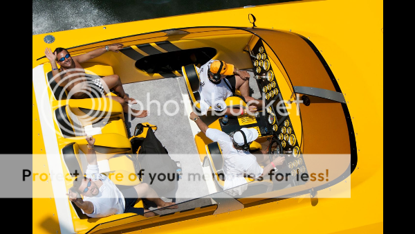

Machz although this thread is 4+ yrs, this seems to be what you are looking for. This was done by Skater but kept the edges which is one of the things i would want to eliminate on a classic. I would also contact Smart Marine. What those boys are doing there is over the top. This just doesn;t have the rub rail which i too would remove. Here's a few. Race In Peace Boys
