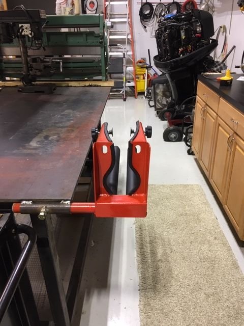

Had a little cabin fever from our snow storm, so made a gearcase work stand.
Taboma is offline

nice job my friend! Did you build it from scratch or modifiy existing stand? I want one LOL

Ron, Built from scratch. I can give you the plans or, if you can be patient, I'll make you one. Didn't take too long to build. Funny weather here 5 inches of snow on Friday - boating on Saturday, 65 degrees
