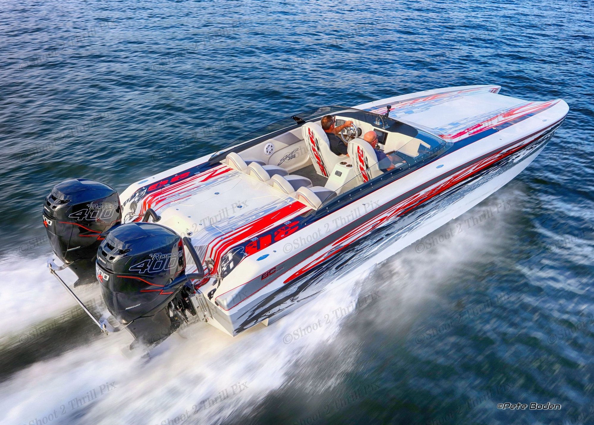

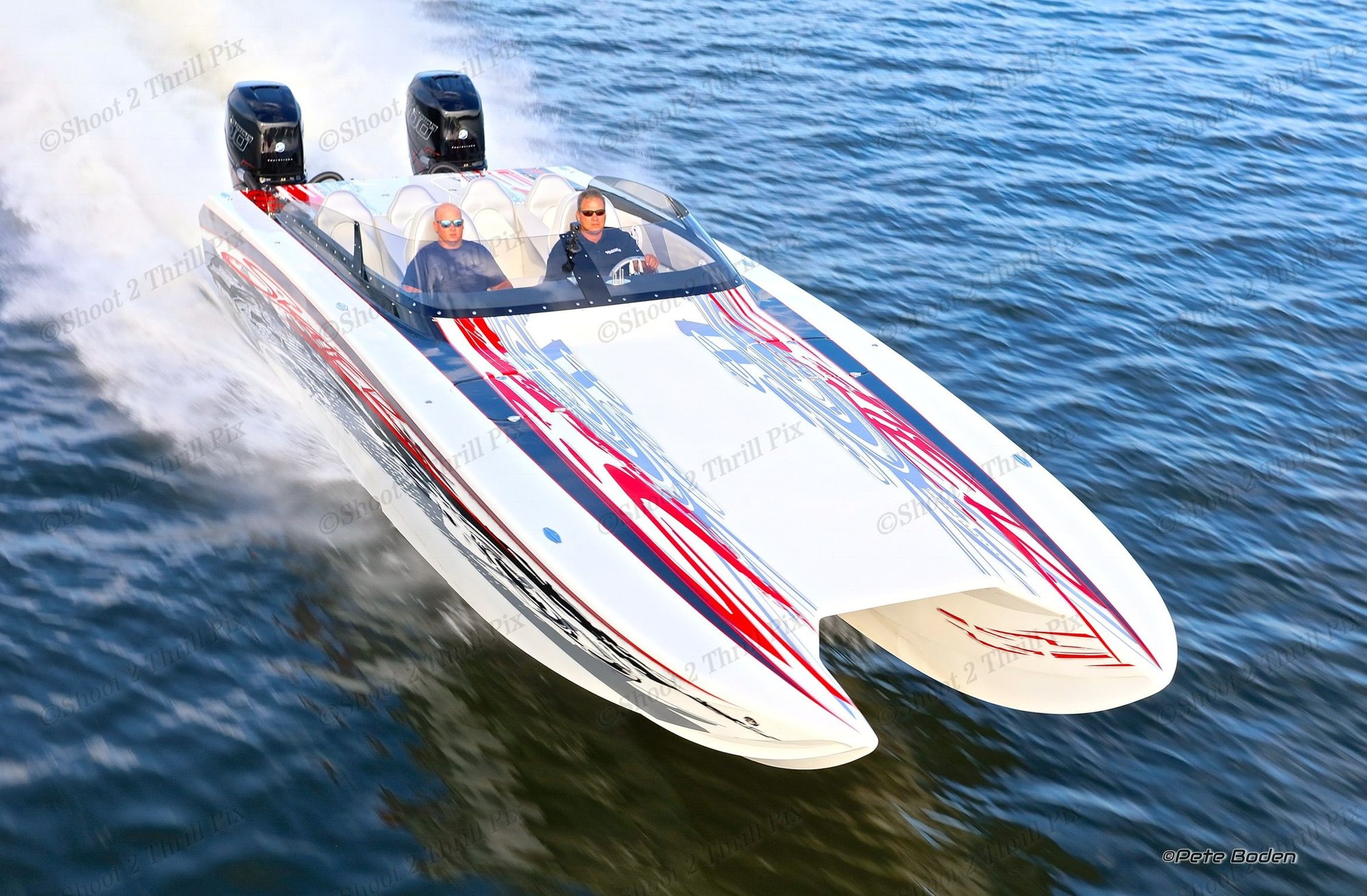

Default Hey we can post again😎

^^^^ sweet ride - surprised it hasn't sold but warm weather is coming.....Great pics
