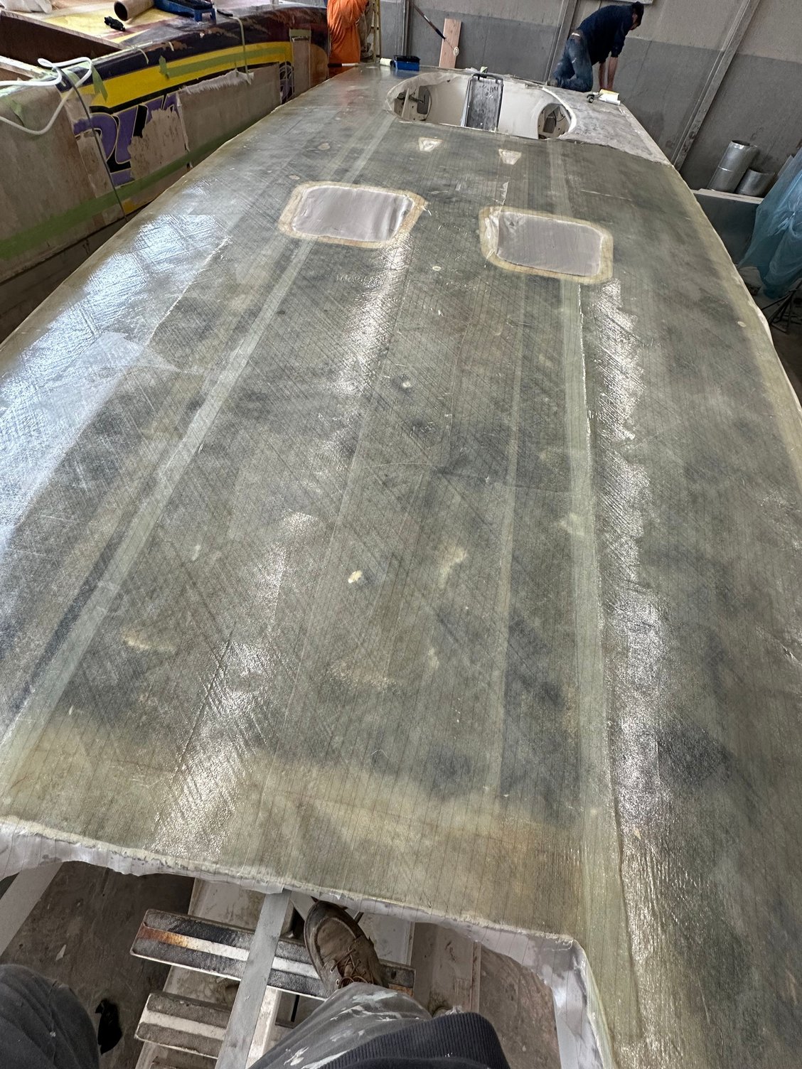

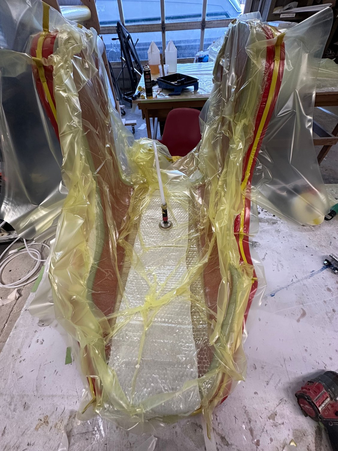

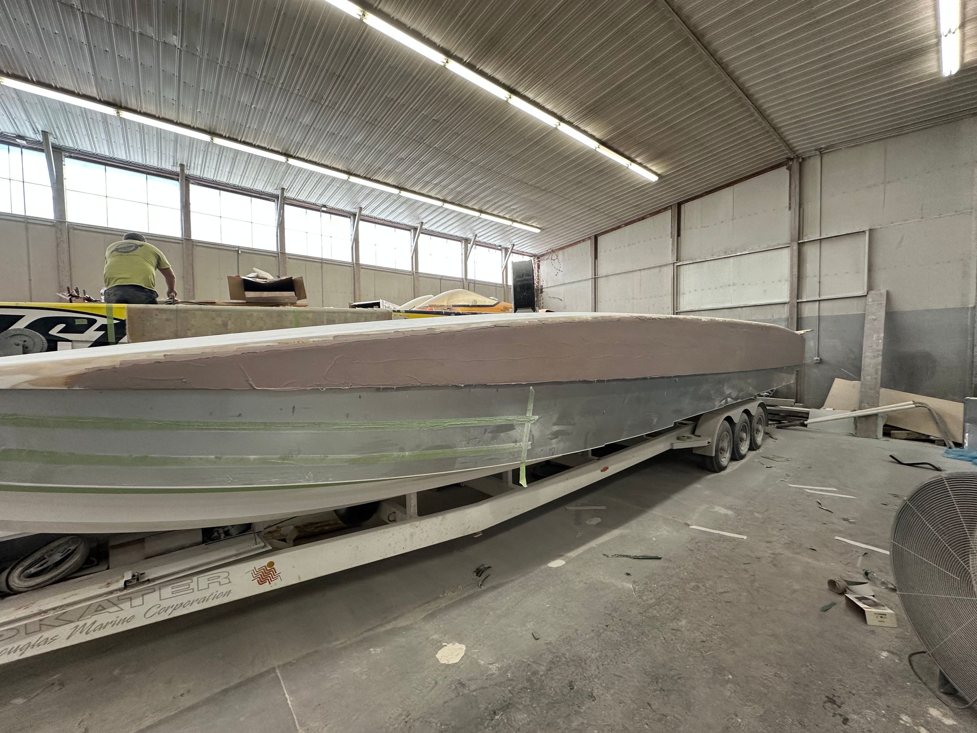

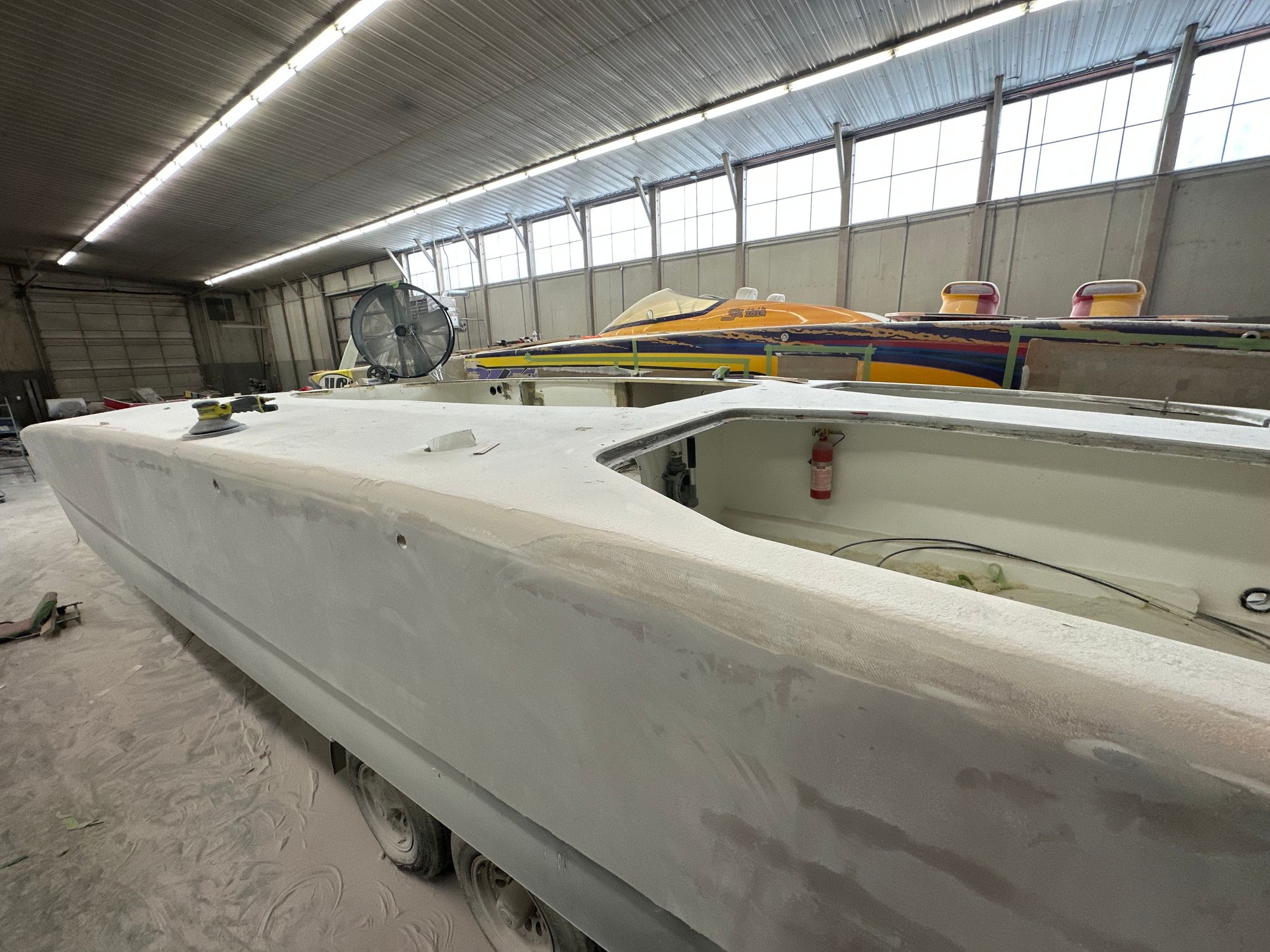

Hullsides bodyworked. Stbd side had a lot of junk on It from years of racing. Ripped it all right down to glass. Epoxy fairing compound on the whole side. Fresh laminate on the deck to lock it down. Lots of heavy grind marks. Core exposed, and years of weather on the exposed laminate.
Put a heavy, thorough fresh scratch into the deck. Full cap. Closed a bunch of through holes.
now we will have fresh glass to work out on.

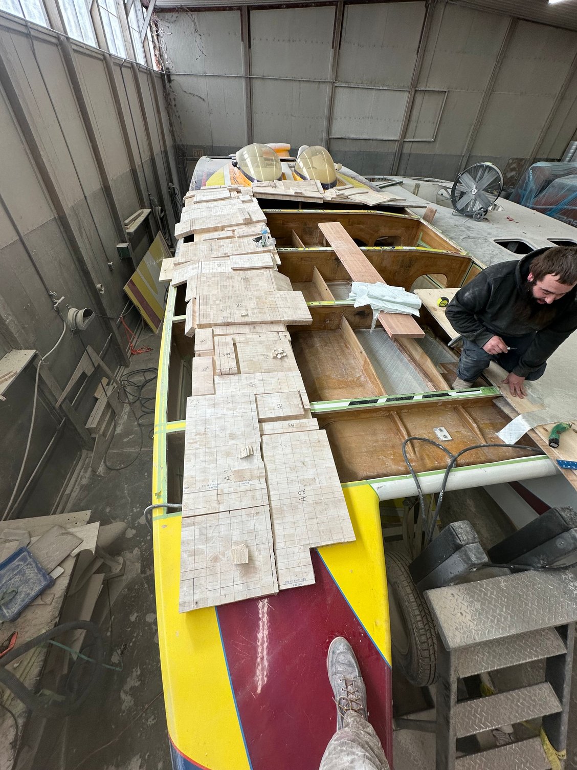

front seats bases built
Receiver getting mounted next.
few pics of our huge 46 build if anyone’s not following on our Facebook.
