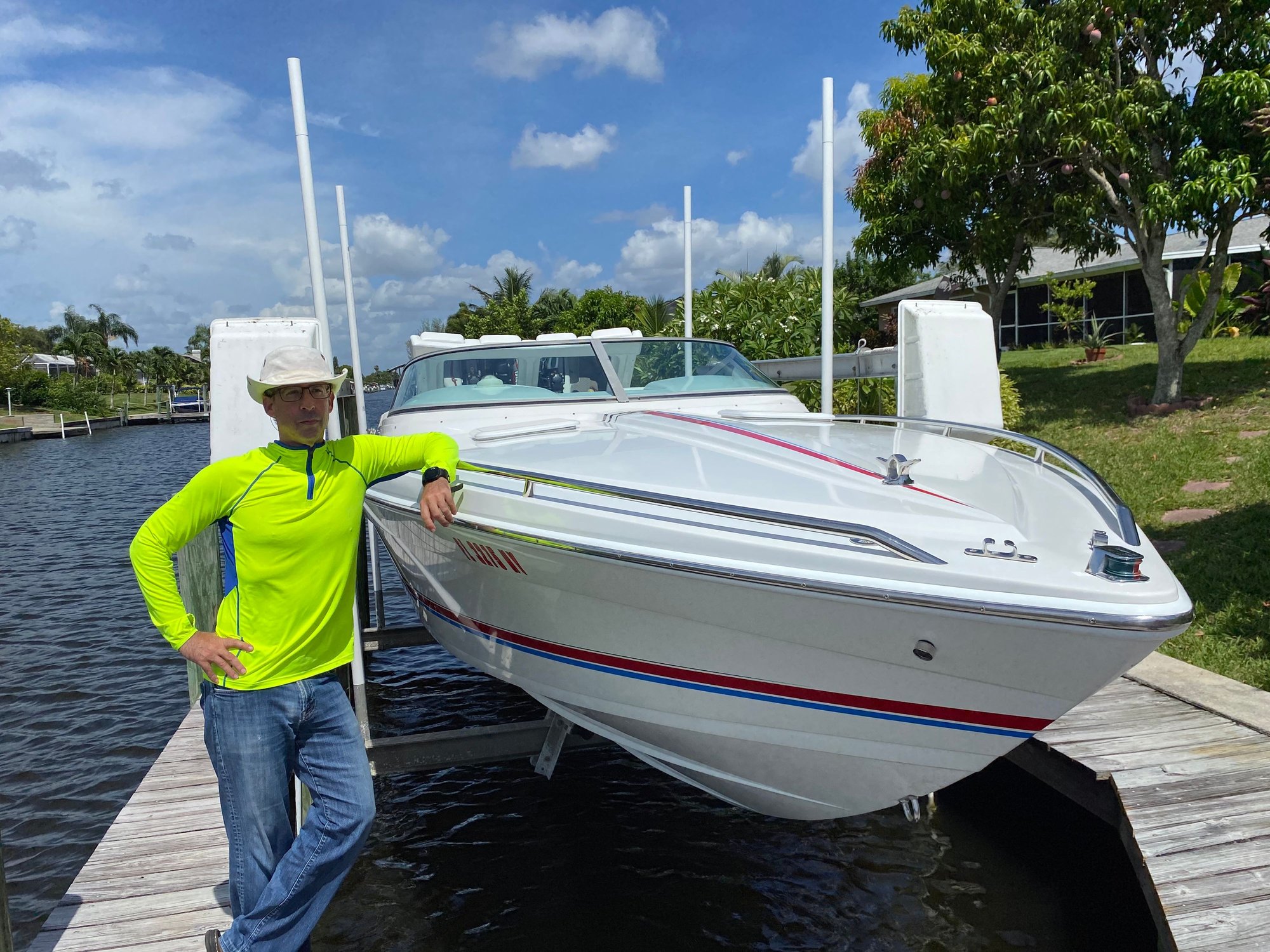

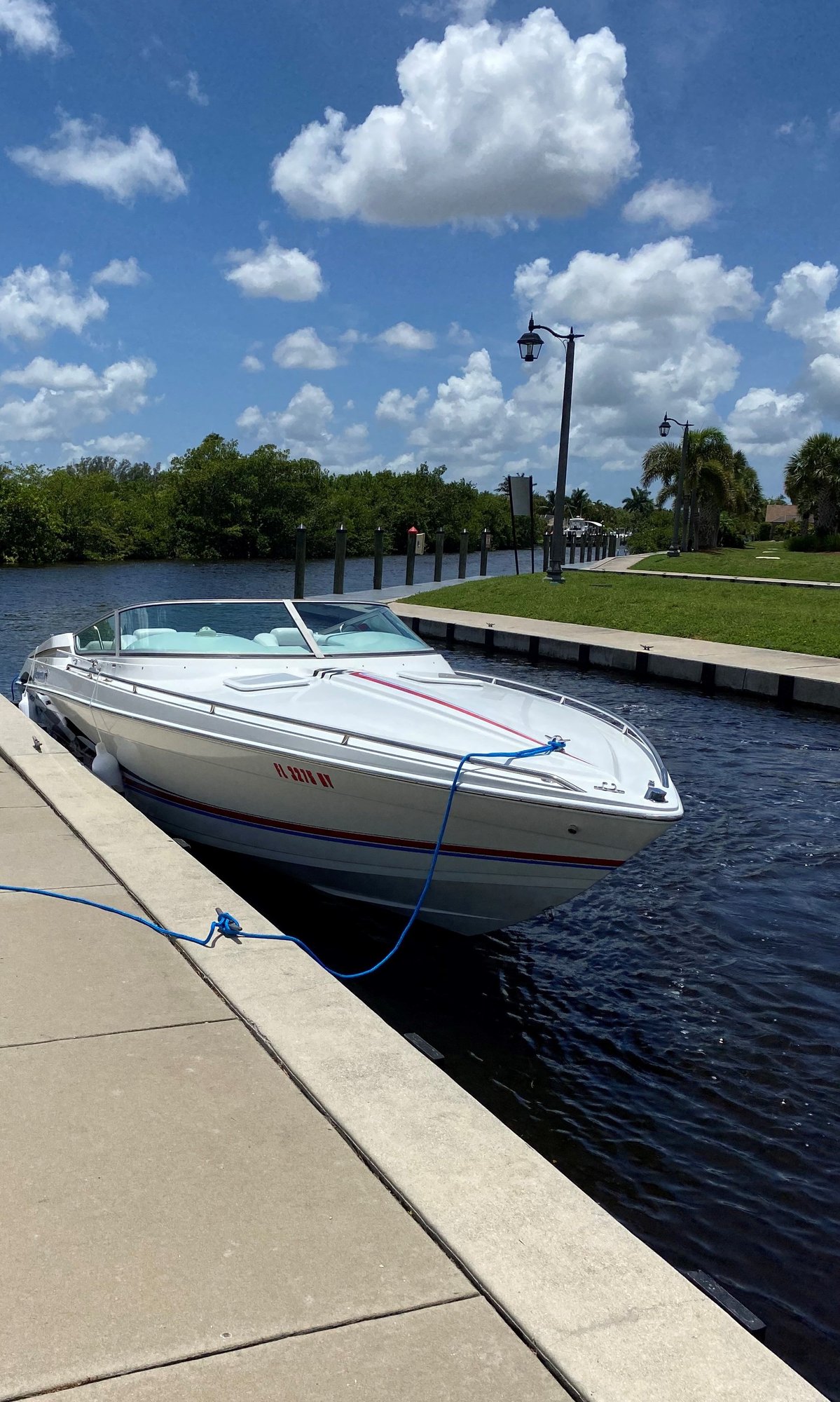

Splashed at Rosen July 3rd without incidents (yeah baby). That ramp/facility is really good even though I wish it had better "bump" protection on the ramp sides since they sit really low and there are no pilings. Resisted the itch to take her out to the river for a quick WOT test, and stuck to the plan of slow-crusing back to the lift during high tide to ensure she fit right on the newly positioned bunks with the self-built hull step additions. The decision proved prophetic. Turned her around in my narrow channel and floated into the lift like a BOSS (beginners luck). Lifted her and she was sitting perfectly on the bunks. The thousand measurements and angle calcs to clear the beams under the low-height bunks were worth it. Not to mention, the always-on-the-prawl canal gods claimed a digital level (recovered but obviously fried) and a Craftsman extension+adapter+deep socket assembly that is yet to be recovered :-//.

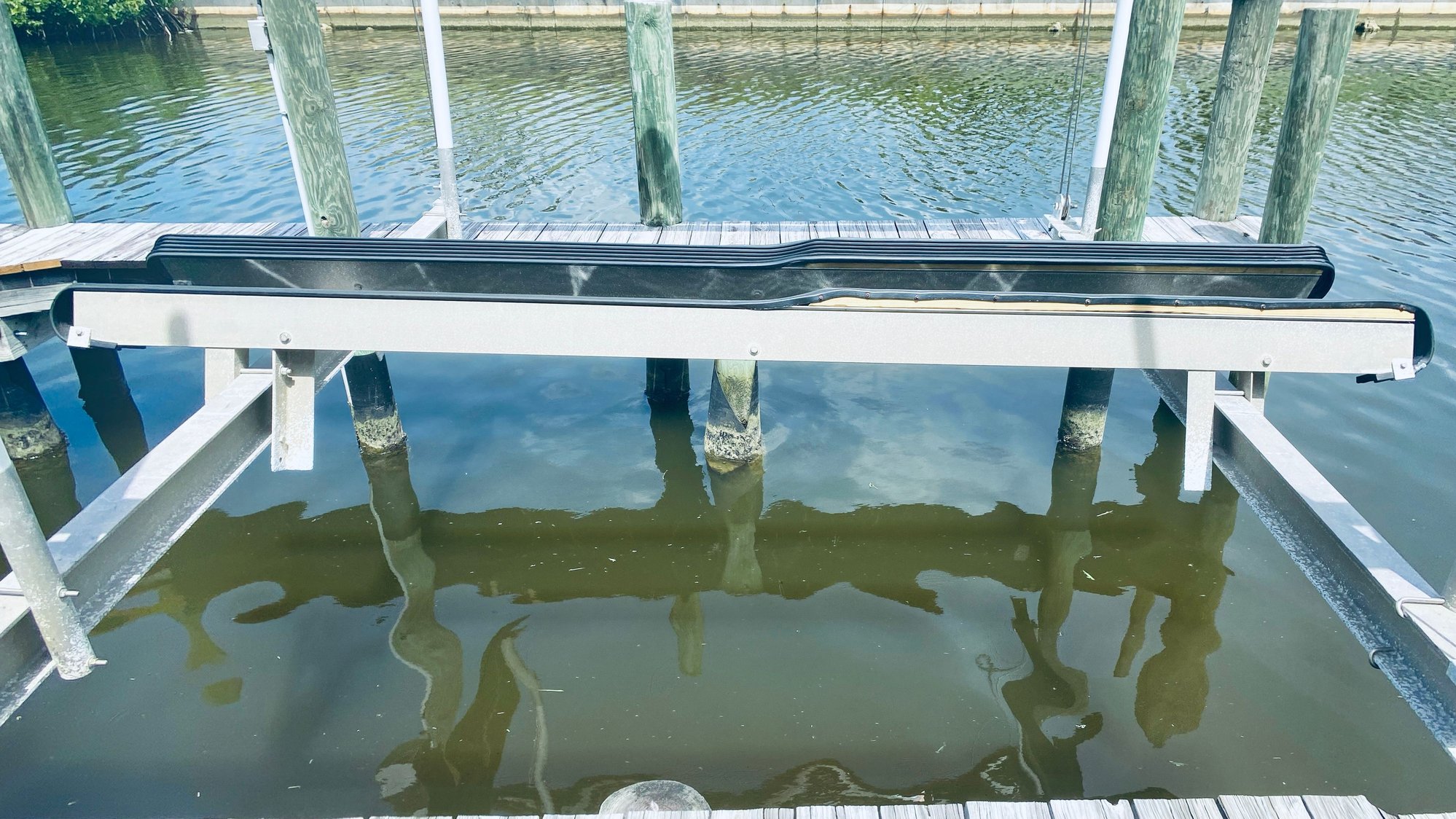

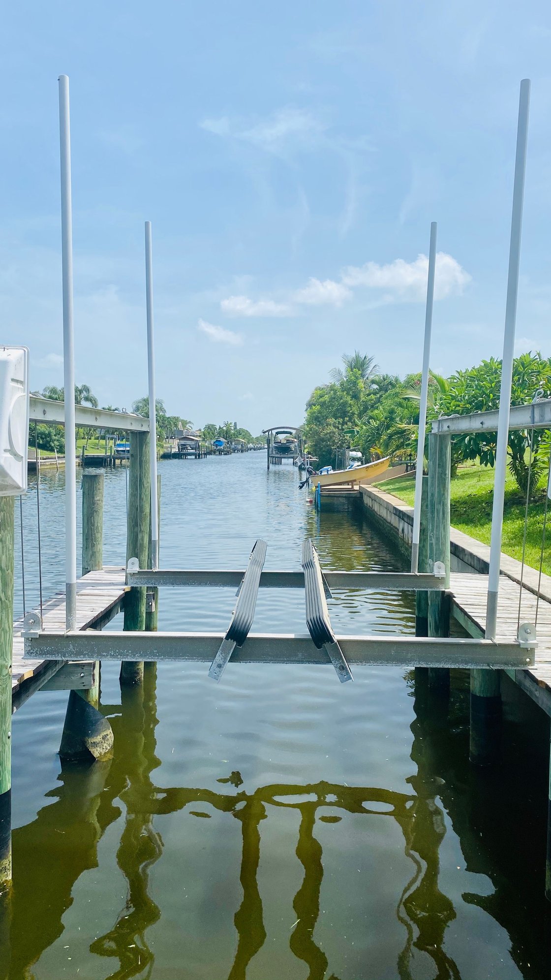

Lift Bunks with the step:

Those lift bunk with steps are amazing. I read your stick to the conservative plan for first boat outing and did the same thing in my new to me local area (Perdido Key). Sure enough a exhaust manifold water line popped off and it would have been catastrophic or at least significantly worse if I was not literally in my own backyard. Voting is just like Aviation it's best to execute a very conservative plan and have two to three back ups.

Thanks F14A, the bunks where a bit of effort but well worth it. Indeed on sticking to conservative plans in these situations. I don't always do it, but as I have learned to recognize and follow my instincts.

  • Is your boat on the lift now? You may want to consider coming over and looking at it to take some dimensions and ensure your extra two feet will fit in my deck's cutout. I believe it will as I have about that much room left at the bow on mine if I sit her with the hull step right against the bunks step.
  • The other critical thing is measuring the width of the aft and mid-hull "inside chines" (not sure what they are called). In my 271, I had to make the bunk aft spacing wider by 1", and the front narrower by 1", so that I could clear the aft "inside chines" to fit inside the bunks, while the mid-hull ones to remain outside the bunks' edges. Hard to explain but had to do it so the hull rests flat on the bunks without catching on any edges or corners.
