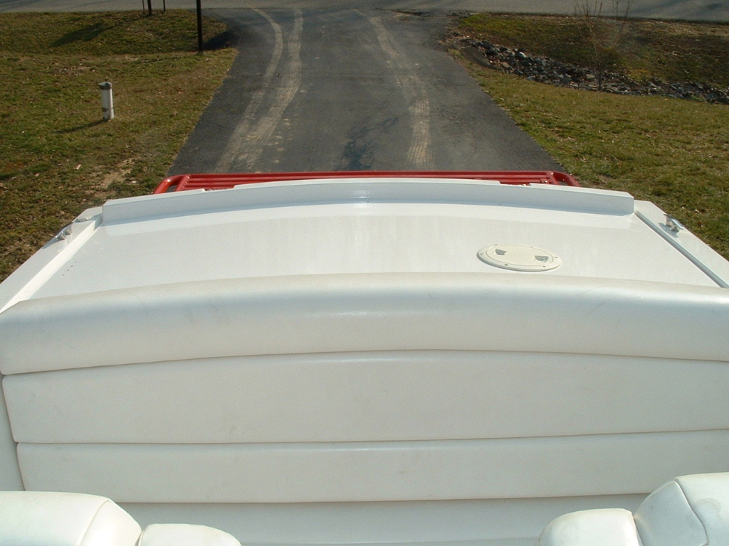

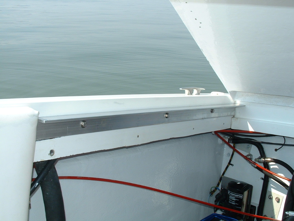

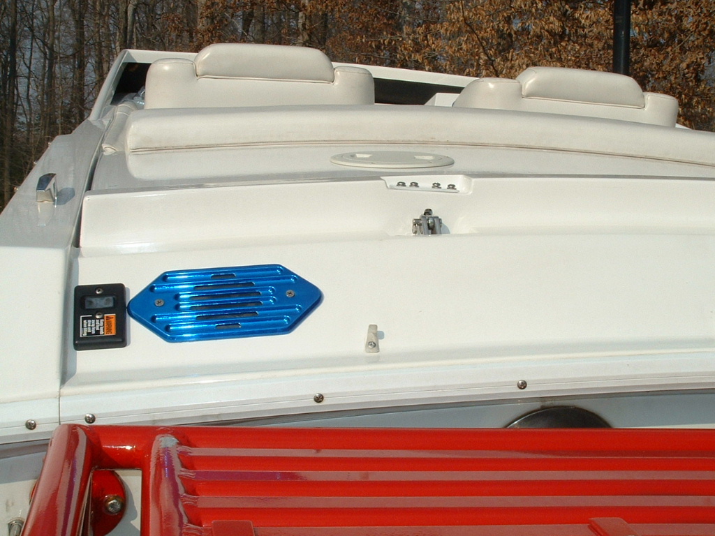

I bolted 2x2 x .25" aluminum angle on each side (pic1)
I inverted the hinge and drilled a whole for it to come out from underneath. (pic3)
If you notice in pic2, the hatch is nearly flush with the gunnels. This also created a gap between the seat back and seat bottom. I screwed a 2x2 to the bottom of the seat to make up the difference. I also but a piece of lexan between the seat back and the hatch. I was afraid that my kids would be able to stick their hands in there and get caught in the motor.
I had to trim about 2" off the plastic cover in the very front.

You can see the piece of lexan in this pic. This winter I'll probably get the seat back redone with another section of cushion that will cover the gap. I can then take the 2x2 off the bottom of the seat.
You change one little thing and it starts a ripple effect with the whole interior!
