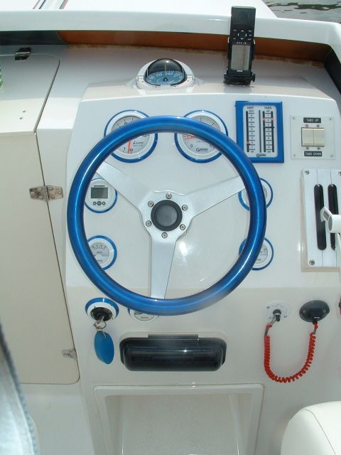

Post some pics of your boat. I managed to fit everything I need on my dash. I moved my ignition and fuel gauge down, added a voltmeter, depth finder, and indicators. To me, the indicators are very important and I am gladd I have them.
