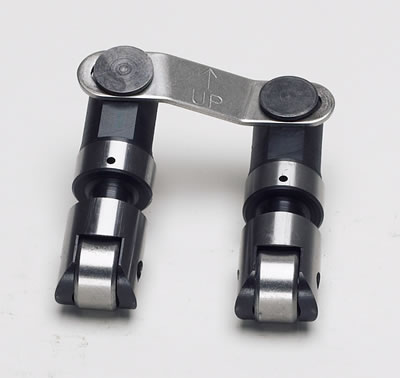

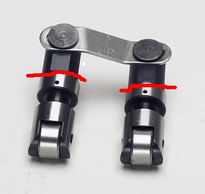

While tracing oil leak and deciding to replace gasket found lifter parts in oil pan, what would cause a lifter to break. These mechanical lifters do not have a continuous cylinder shape, instead they have a tab or 25% (black section) of the cylinder with a crossbar connection the two lifters together, they broke at the base of the black section, engine was still running fine. Any help would be appreciated

Is it a roller block? Or conversion lifter/cam? Older non roller blocks have shorter lifter bore hight I'm sure.
