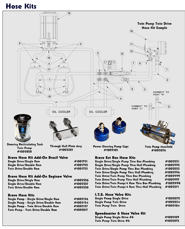

Just checked out Zieger Marine.
Looks impressive:

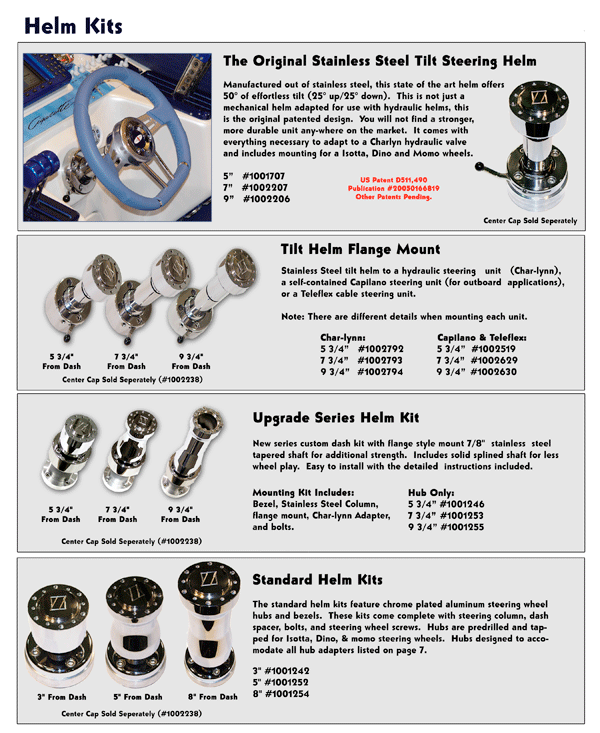

I also like their helm kits:
