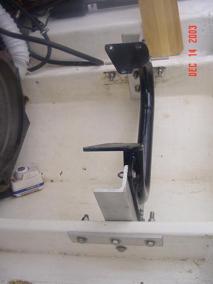

The best solution is a race mount, but that can be expensive as I just had one put in.
If you stay with adjustable mounts, you need to check them after running hard in the rough.
One other solution I have thought of:
With the engine perfectly aligned, take a measurement between the angles bolted to the stringer and the bottom of the mount bolted to the engine.
Then machine a spacer block to the correct size. Hold the engine in the air and put the spacer block in place of the adjustable trunnion. Put a bolt from the bottom up through the angle, spacer block, and engine mount.
Should work... May be place some thin hard rubber between the angle and spacer to make up for anything that may be out of parallel as well.

The mount looks good. It doesn't look like it would of been that difficult to install. Did they just rotate the inside piece of angle iron 90 degrees? How do they measure for alignment? Will your alignment always be right on now? I guess that thing don't move?

Judging from the 10 hour labor bill I received, I think that it was not that easy. I did question the service manager when I received my bill.
He had the head mechanic, Ronny, explain the whole process. I have know Ronny since the mid 80's when I was a doc boy, so he had no problem telling me the whole deal.
The aluminum angles are new and were cut and machined to match the mount. A jig (bare engine block) is used along with the bell housing for location.
An alignment tool is put though the gimble bearing into the drive coupler to get the alignment right. Then the stringers are drilled while all is in place.
Yes, the engine alignment should be right on from now on.
Another good thing about this type of mount is that it ties the two stringers together. With the adjustable mounts, the engine can move around. When it does, only one stringer bears the load. Not a good thing, that is why stringers break.
