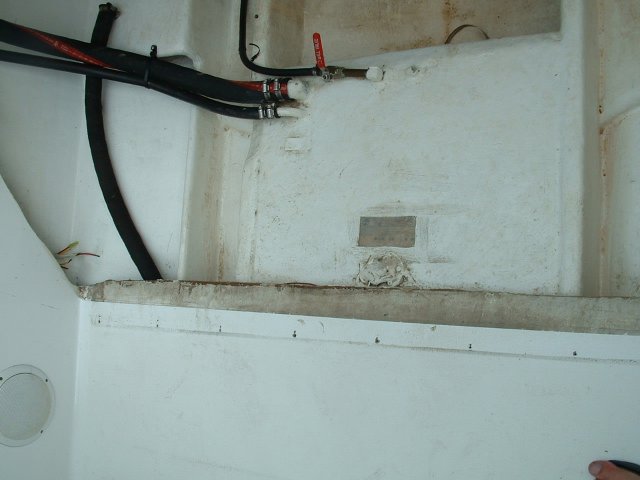

I noticed the floor under the back seat. The edge is bare wood. Look were that brown strip is. It should of been at least coated with something.
